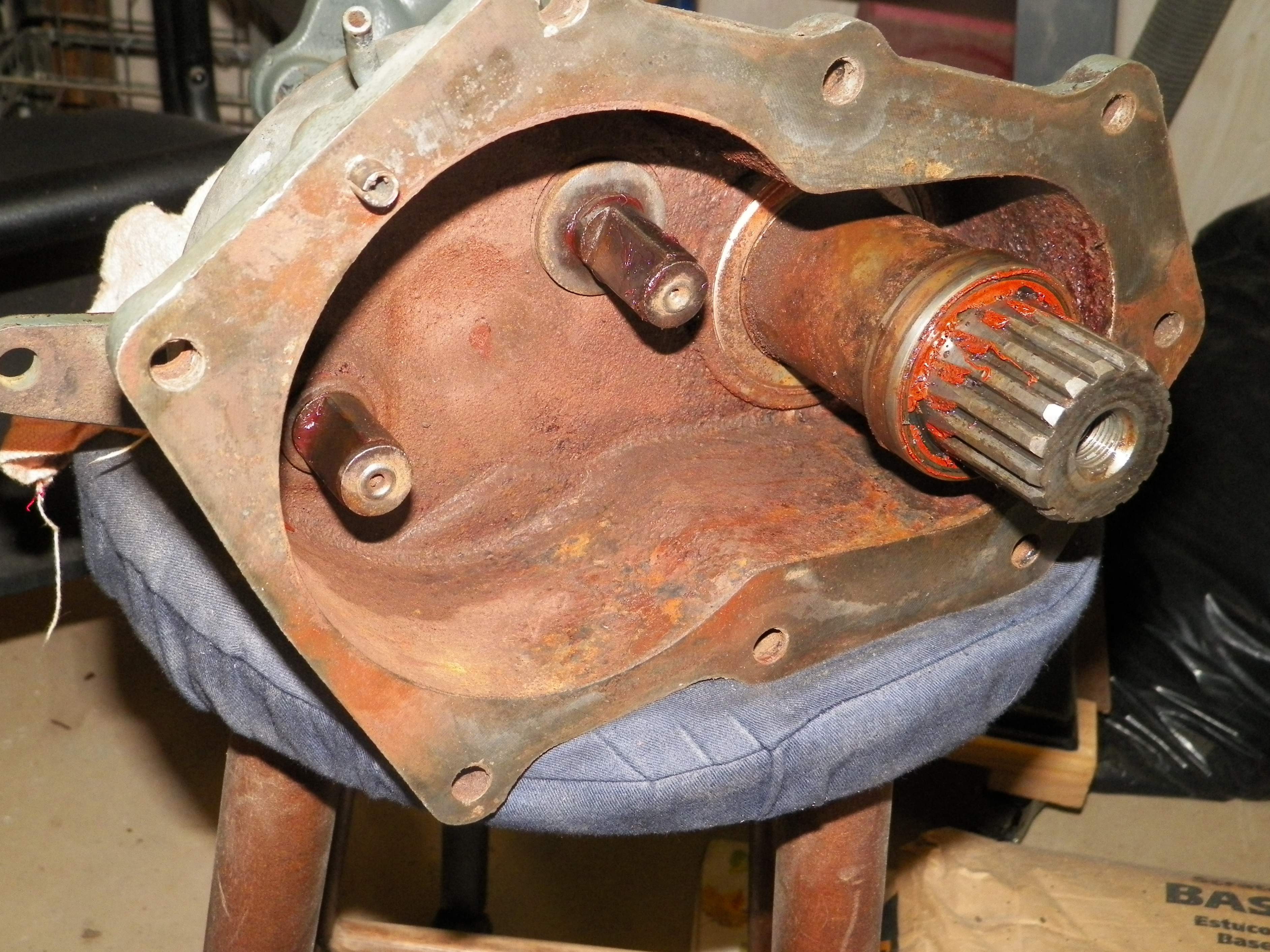

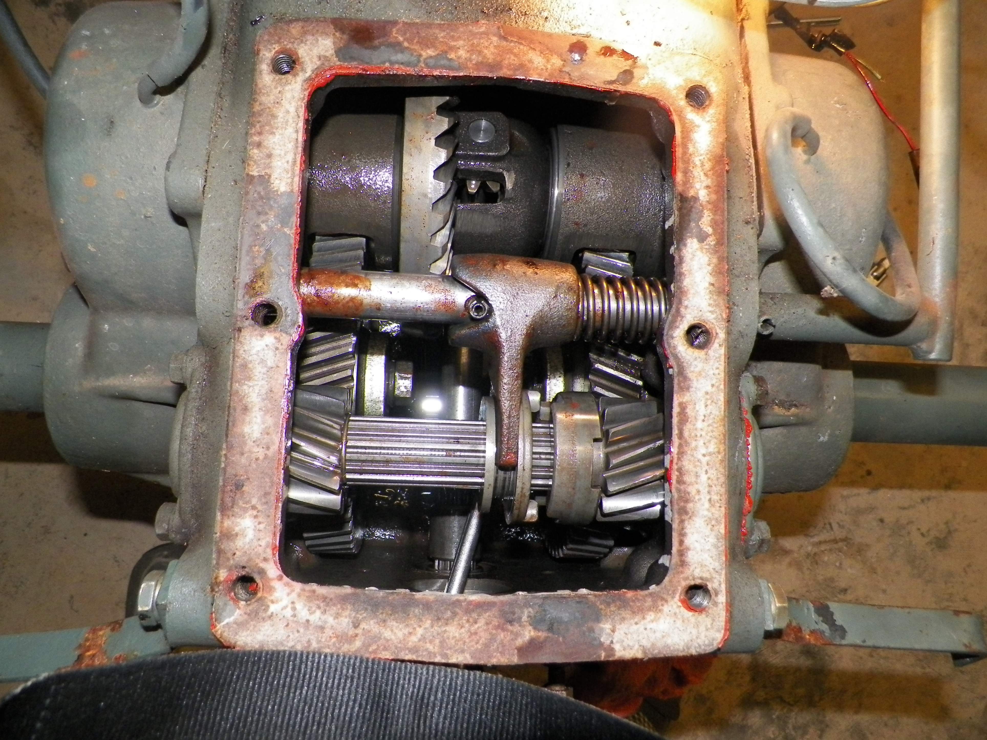

   / No loader or 3point hydralics
:) Thanks to everyone for helping with my brake job and hydralics.
I really did appreciate all the help.
I am including a few pictures. I did not take many on the buildup. some may be the same.
You guys are good.
PS YOU MUST GET IN THE CASE TO REMOVE AXLE AND BRAKES
