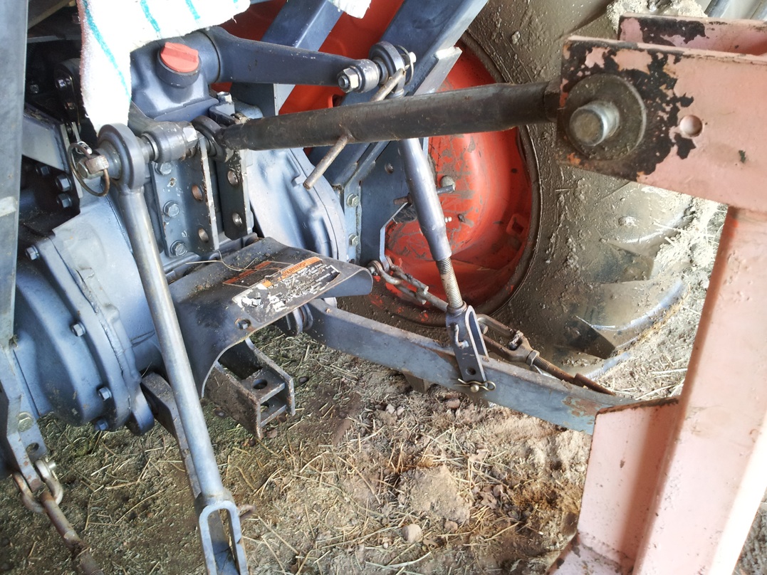

Yes I do have a tractor. I'm not going to take the backhoe off though.

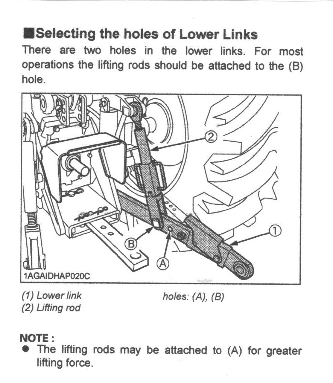

Note the comment about point A/B
On the picture what happens to the implement if the top link is moved to the bottom hole.
   / No lift in 3-point hitch #52
In the pic of the actual tractor, if the tl is moved to the bottom hole, you will loose lift force, because it causes the fork tips to move a greater distance (in relationship to the 3ph itself) than where it currently is in the top hole.

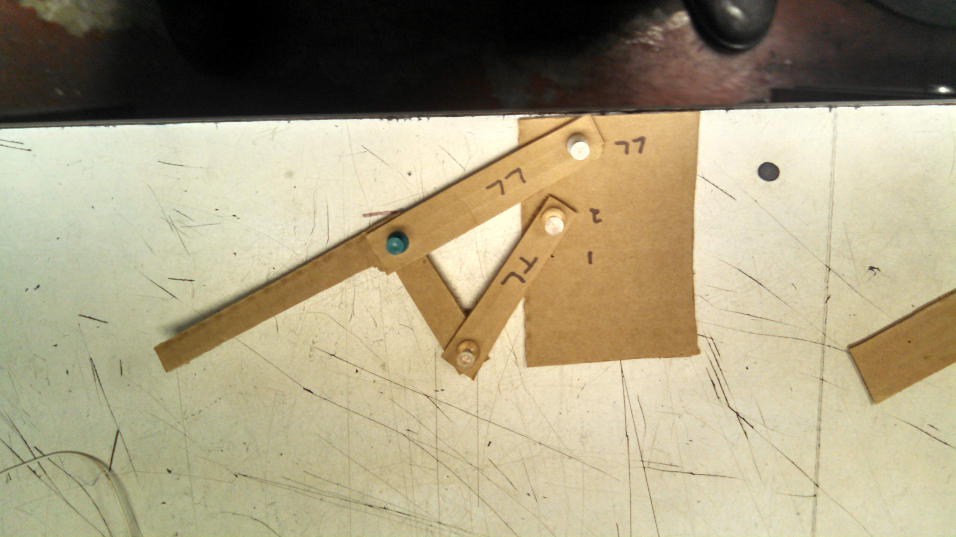

I'll see if I can throw together a simple model.

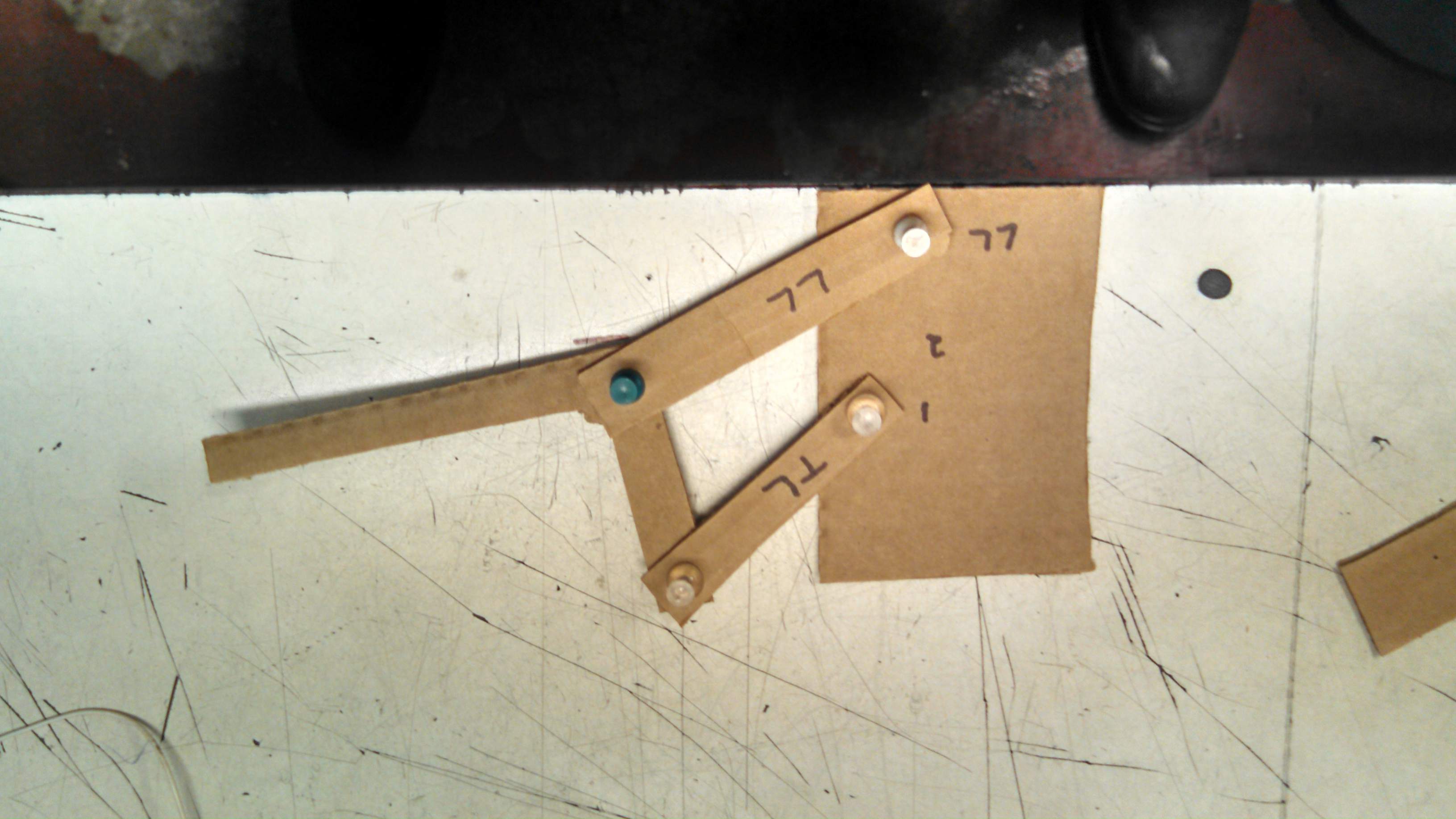

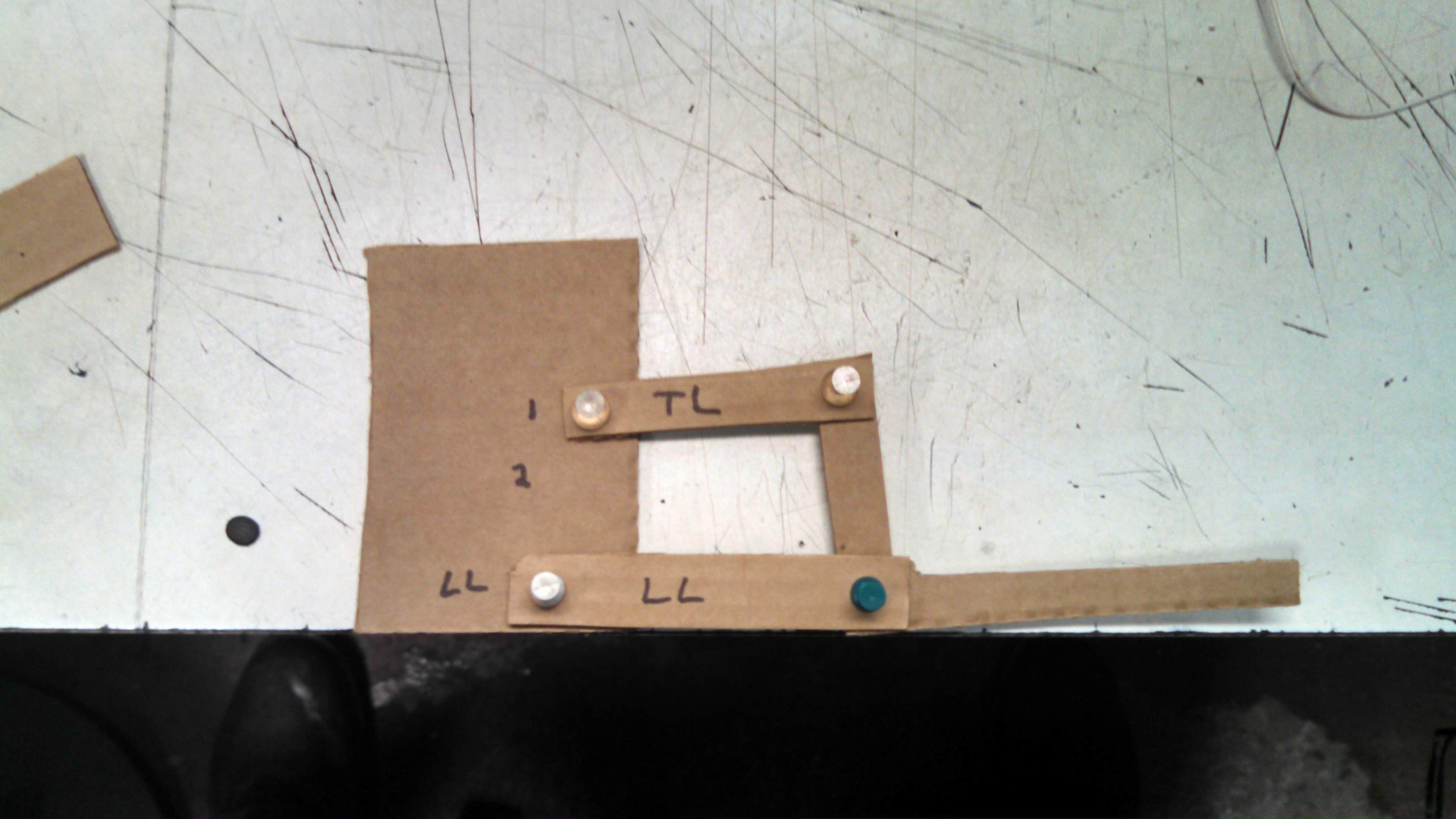

Here we have a simple cardboard contraption showing a fixed length toplink but two different positions. In position 1, the change of angle of the forks (using the desk edge as a guide) is minimal compared to position 2. Sure, position 2 starts out further from level. Which can be adjusted in the real world by lengthening the toplink. That's not the point. The point is the angle change. When the hitch is raised to the same location (black line on desk), position 2 changes angles to a greater degree.
While I didn't measure it, just guessing, it appears that position 1 may have started at 5* and ended at 10* from horizontal. While position 2 may have started at 10*, but ended at 25*. While those numbers may not be exact, it is clear to see that the angle changes much more.
And in doing do, with the length of the forks being constant, the tips move a greater distance (in relationship to the 3ph) with the toplink in the lower hole. Which requires a greater input of force for a given weight to lift.

Nice models.
The implement pivots around one point. The blue pin. The lift arm pivots about another point at the opposite end of the lower lever arm. The lift points will be between the two pins. ( A & B on the parts diagram. )
Put in the lift points and then draw the arcs that are subtended from start to finish.
