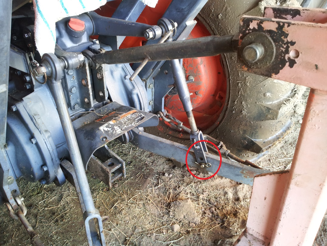

What hole was the toplink in to start with? HAving it in the top now maximizes the lift force.
Next thing I would do is adjust both of the lower lift arms where they connect to the vertical link. Like I mentioned, it appears the design of your bale lifter, you are running out of lift height. So where the lower arms connect (circled in red), move those to the top hole to get more lift height. As long as it can still lower far enough to get under the bale, you will now be able to lift higher.
So do that and give it a try:

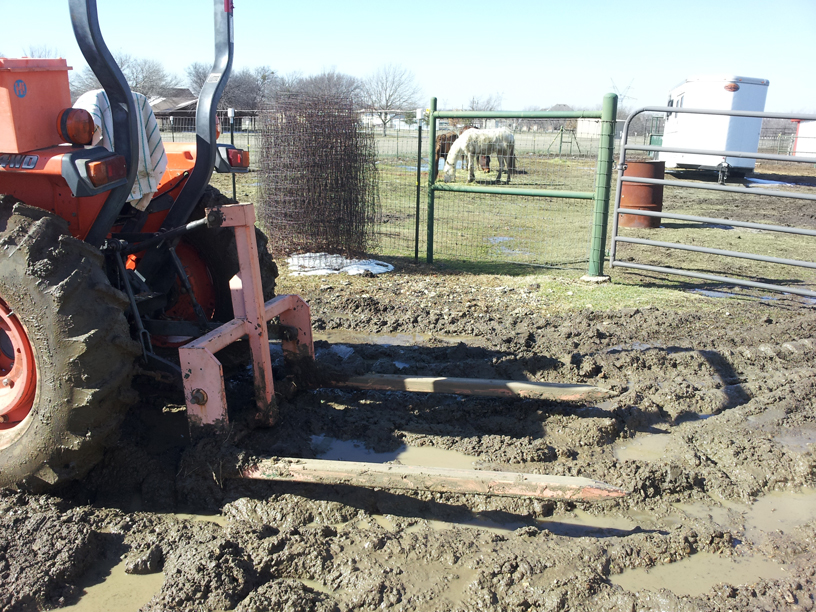

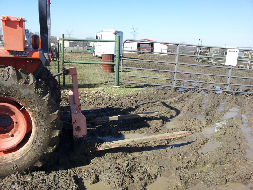

:D You all crack me up! So Ok... Just got in from feeding and got pictures... Er... Category 1 pins are in the hay spear, so I guess it's cat 1... Of course, I have these magical uni-bits that gradually make holes larger... :eek: Oh yeah! The pictures! Sorry...

So does that mean you are able to lift the bales to an acceptable level now?
It looks like the design of them forks could be causing you some grief. Where the lower arms hook up to it is pretty high up. The 3PH arms will go almost to the ground with nothing on them. So by starting out with the pins that high, you have already used up a good bit of your lift height just to attach. Dont leave much left to actually lift anything.
IF you still have issues, I would lower the pins on the fork frame. You will also need to lower the toplink mount as well if you do that

I've been following this thread with interest to see the outcome. If the 3 point arms raise to normal height without a load and the shop set the hydraulic pressures to spec and it won't lift a bale I suspect that the combination of the bale and the forks is too heavy. Plus, I suspect that the distance behind the lift arms is in excess of 24 inches, too. You said the FEL lifts a 900# alfalfa bale, so I suspect your pressures are close to normal. The FEL lifts the alfalfa bale easier with the bale rolled back because it put the weight closer to the lift pins on the loader, same principal as the big bale being so far behind the ends of the lift arms.
If you are truly at the limits of your hydraulic capacity, I can suggest one modification to help a little if you really need to get the bale higher off the ground. Notice where your lift links connect to the lift arms. If you drill another hole in each arm out closer to the ends and move the links out it will create a little mechanical advantage at the expense of a little less lift height. You engineer friend can probably help with just how far out to drill, how much weight advantage you will gain, and what the lift height penalty will be.
I also noticed in your opening post that the loader nor the 3 point worked, they found trash in a relief valve, and the loader worked better. I couldn't see any more work that would indicate more volume or pressure problems. Also, your bill was up to $4,000, did they adjust it down to the ~$1200 on the final invoice?
I hope you can get this resolved although my opinion is that you need a heavier, more ag oriented machine for your purposes.
Not entirely accurate.
The 3PH is a totally differnt mechanism than a simple FEL. By design the 3PH is a parallelogram linkage. And a true parallelogram linkage will not loose capacity as the load is shifted farther back.
But there is a lot of adjustability of the 3PH, meaning that while it is a parallelogram design, it might not be perfect. And the farther from perfect, you will loose some capacity, but nothing like the simple ratios of a FEL.
The closer to parallel you can get the hitch to raise the better it will be for max lift. In the OP's case, set it up so the forks remain as LEVEL as possible will get the max lift. The more the tips pitch up as it is raised, the more capacity you will loose (because it has to lift the weight higher with the same given force for input).
If you can get the forks to lift perfectly level, your lift capacity at the tips of the forks would be the same as at the heals of the forks.
