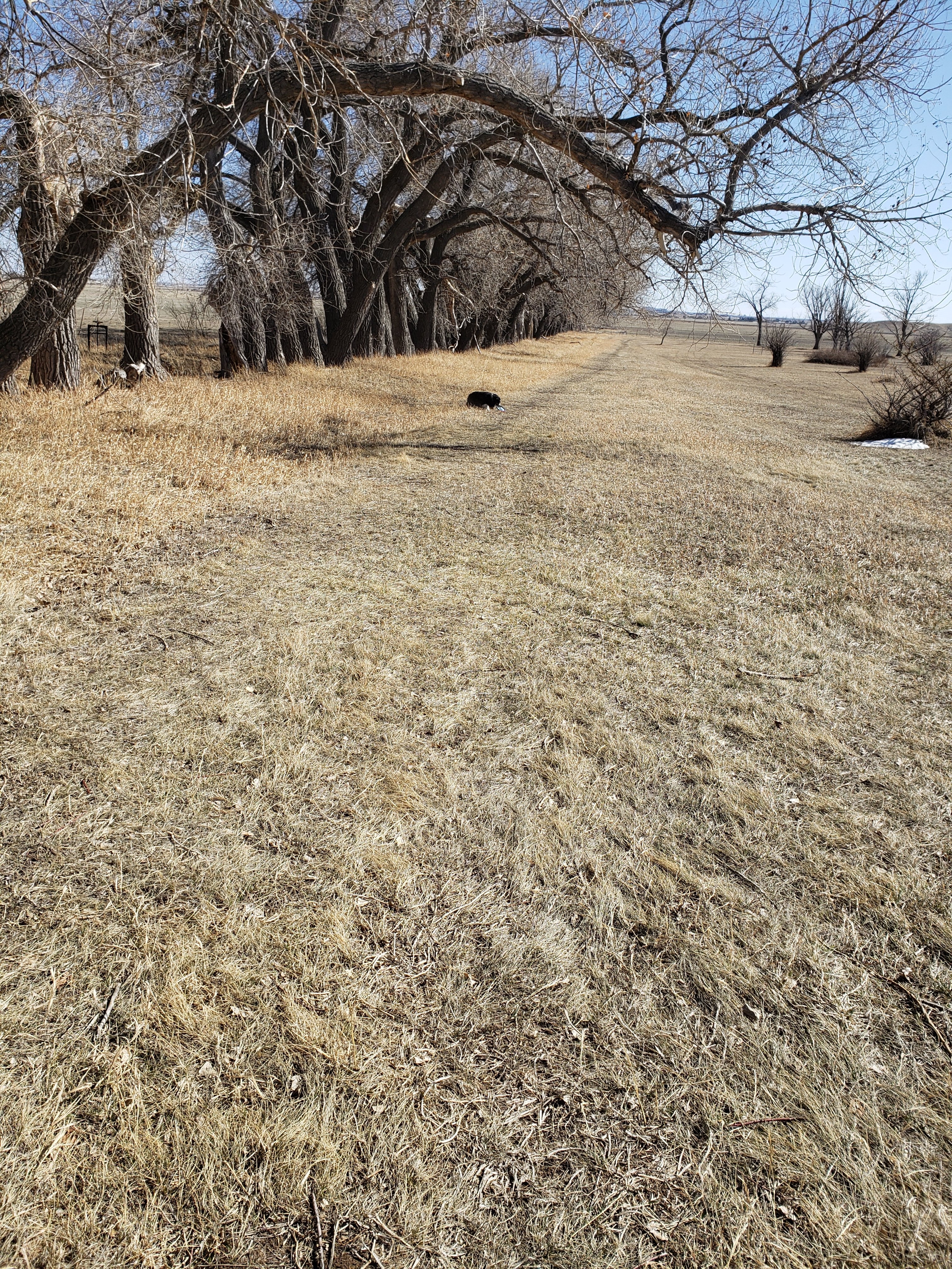

Are the powerlines yours or the utility companies, if they belong to the utility.they might take it down for you
The lines within just a few feet of this tree is my incoming service. The main lines running down the road are further out but still within reach if this 100+ foot Oak if it were to come down. They won't trim it.

I've fallen a few trees out in paddocks, and I've done a few chainsaw courses through work. I'm defiantly not expert though. If you attacked the tree from the ground one trunk/branch at a time you should be fine Biggest concern is falling branches wear a had hat and don't forget to look up. Do a scarf cut for each branch remember the scarf only goes 1/3 the thickness. As long as the falling trunks can't damage anything go for it. Make you your chain is sharp teeth are even and you bar is dressed. If you have ever cut through a large log and the chainsaw starts curving around, that due to the bar and teeth not being filed dressed properly.

Dead standing trees are not all that dangerous. It doesn't have a big lean to it it. The wood has a chance to slowly dry and get hard.
Get in there, make a deep notch, and do a back cut. Don't have to pound wedges as there is really no hazards around to avoid. It's pounding of the wedges that make stuff fall.
I cut trees like this all the time at the ranch. It's not that big of a deal for a guy with a little experience.

It needs to come down, you either cut that grass or have stock graze it, either way a danger to those around or under it, and it will get more unstable as time goes on. Two options I see, can you cast a fishing line?. I use a fishing rod to pull a line up high in an unstable tree, then pull a 1/2-inch wire rope up and over, making a loop with a shackle and hitching it to a tractor. It would probably pull it over; if not, unstable branches would fall to the ground. The second option is to cut it down, but look at the fork at the base of the tree, it may have to be cut as two trees and fall it in two directions.
