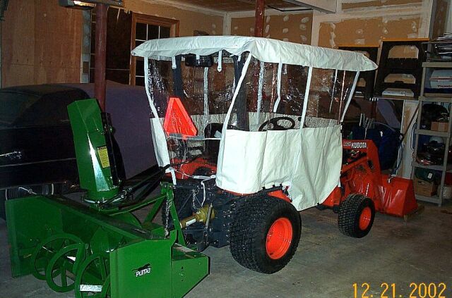

You may want to consider a rear 3 point snowblower. I have a Puma 54 inch unit I paid $1000 for it in May 02. Last winter with 2 feet of snow I had no problem moving the snow with the BX 2200. I have a FEL and the combination of a rear snowblower and FEL works great. The only down side is you have to back up with the rear blower. The up side is it is cheaper then a front blower by about half. I know the machine and color is wrong for this board, but here is what I am taking about, see attached. The cab is a golf cart cover I made up for $125. You do not want to snow blow without some sort of a cab.
Puma Site web page
