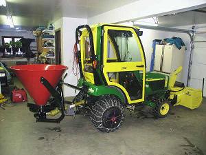

I had to call my dealer to find out how to float. I thought I was pushing the lever fully forward but wasn't. Then, when I hit the stick fairly hard it snapped into float.
Here's a pic of my 47" blower on the 2210.
