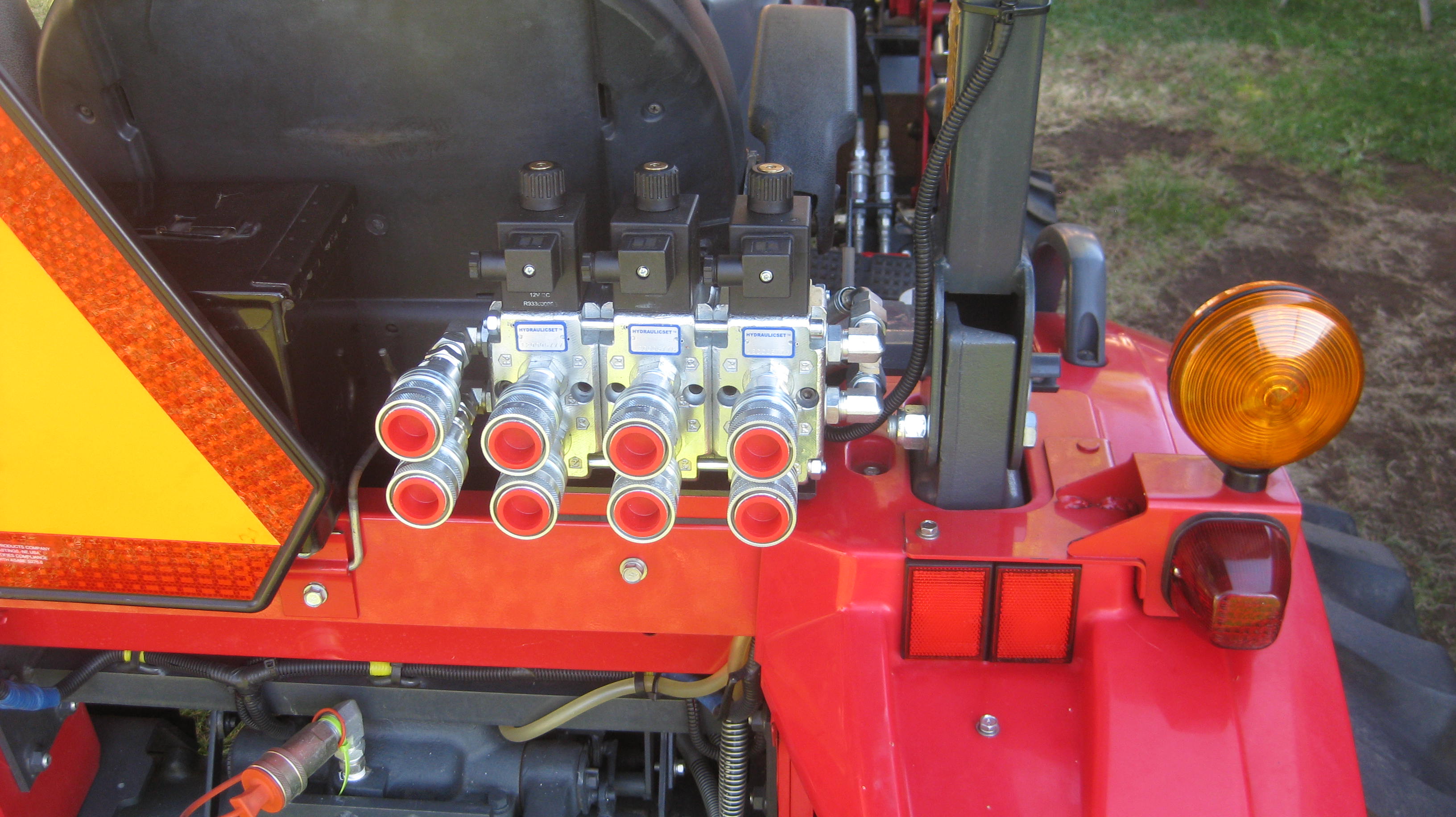

I am currently in the process of adding 3 diverter valves for the rear of my smaller tractor. Only 1 OEM remote available and I need 4. I had added a 2 spool Prince valve when I bought the tractor and though that has worked well for the past few years, it was a bit bulky. When I decided to go with hydraulic angle and offset for my landscape rake, I then decided that the 3 diverters plumbed with the single OEM rear remote would be my BEST option. They look like they are OEM. I will post some pictures once it is all completed. :cool:
Yes, yes, and YES to all three diverted remotes.:D I want Jack to be able to disconnect an electrical circuit, pull quick connect to the diverted remote and be able to quickly remove this whole setup without disturbing the factory hydraulic plumbing. If he ever gets another tractor, doing like you are doing will enable this setup to easily move there. When he goes with breaking rigid lines and then inserting all of this into the middle of his open-center system, he makes installation a lot more complex and the setup has to be considered permanent.

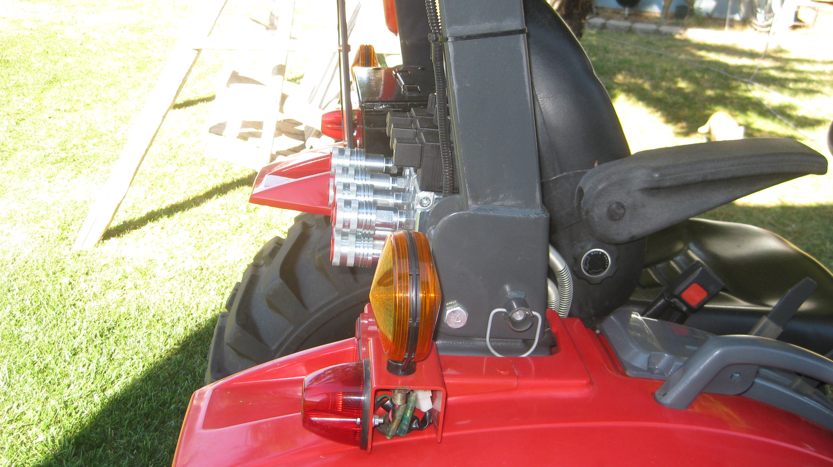

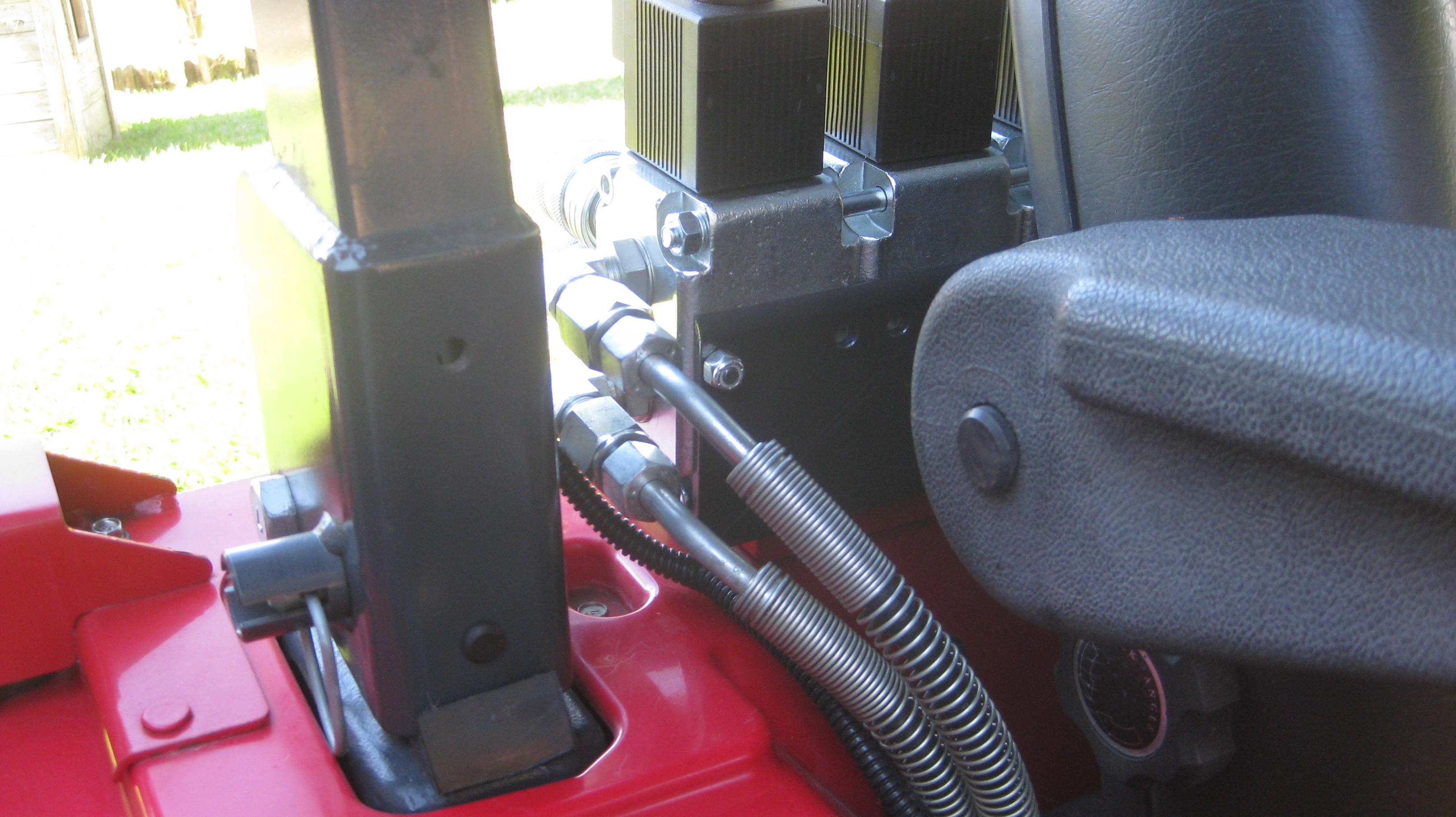

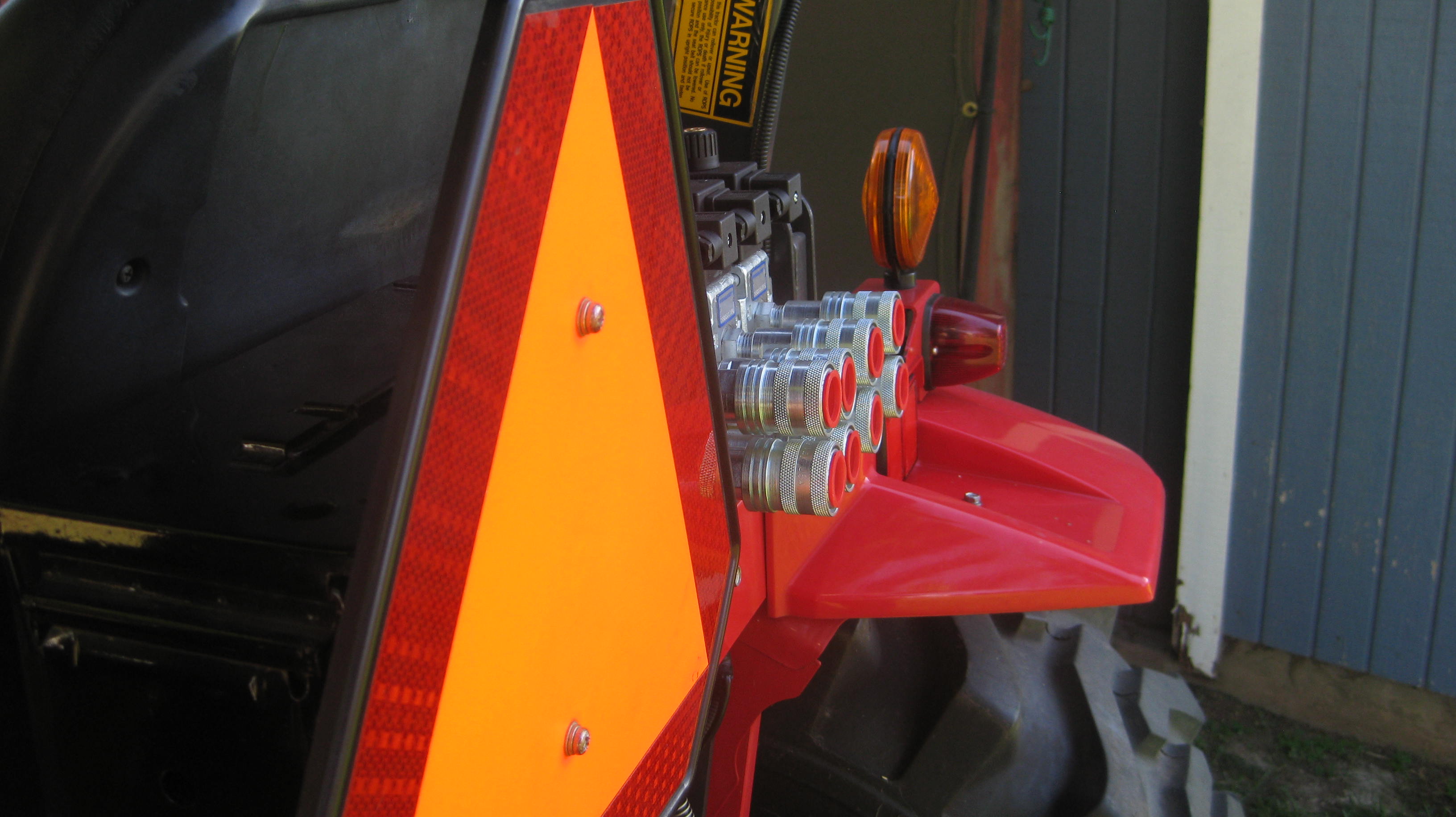

Here are some pics of the 3 diverter valve setup that I just installed on my little Mahindra 3215. The 1st pic shows where the OEM remote outlets were and the big Prince valves that I had on there. The other pictures show how it is as of today. the last pic shows that I used the exact same lines to the diverters that had gone to the OEM female ends. I will be installing a new grip on the single OEM remote lever that will have controls for all 3 diverters. :cool: Not quite there yet :(, but much much closer. :thumbsup:
Hope to have a front diverter on soon, then I will finally be all set. ;)

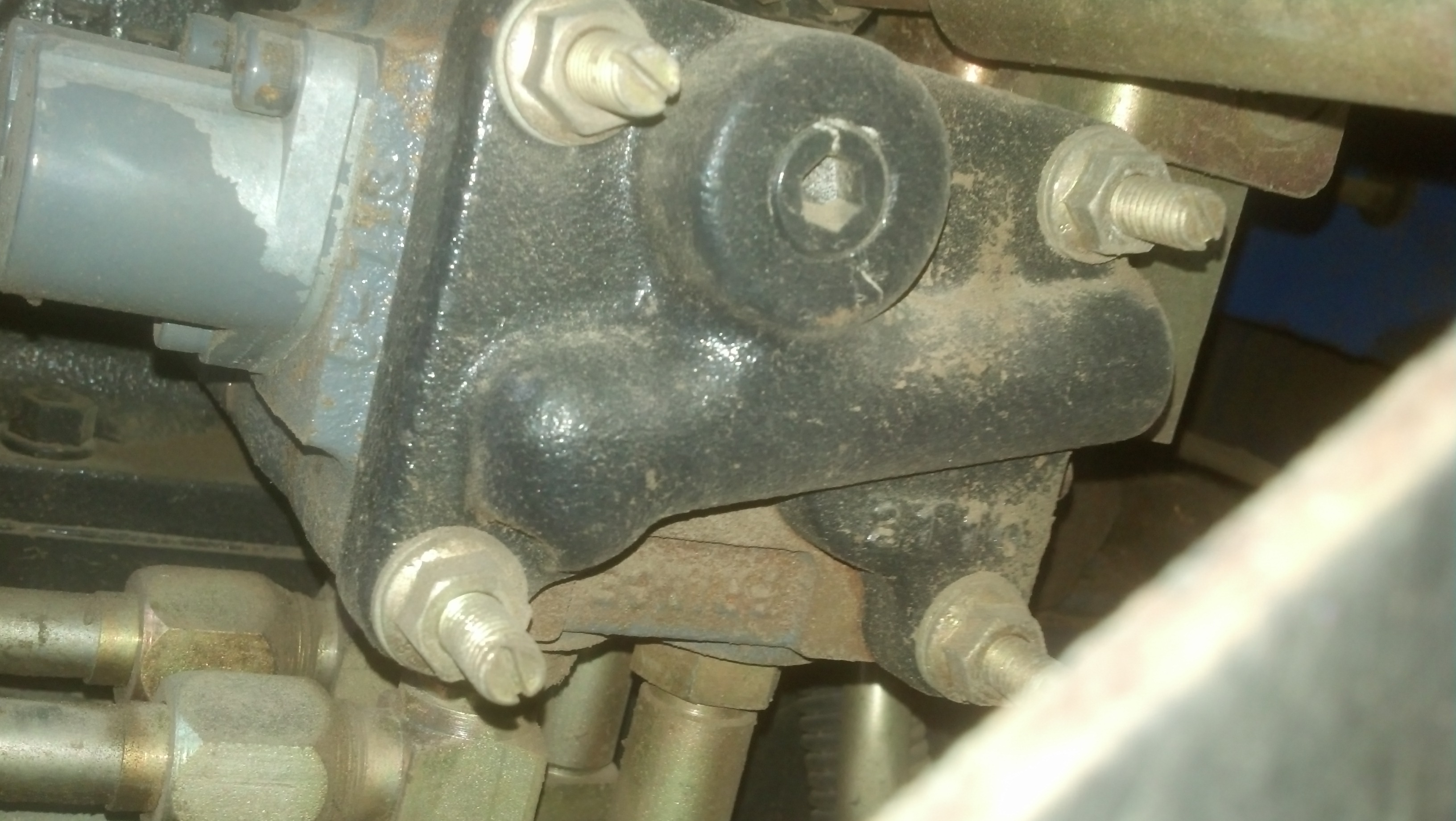

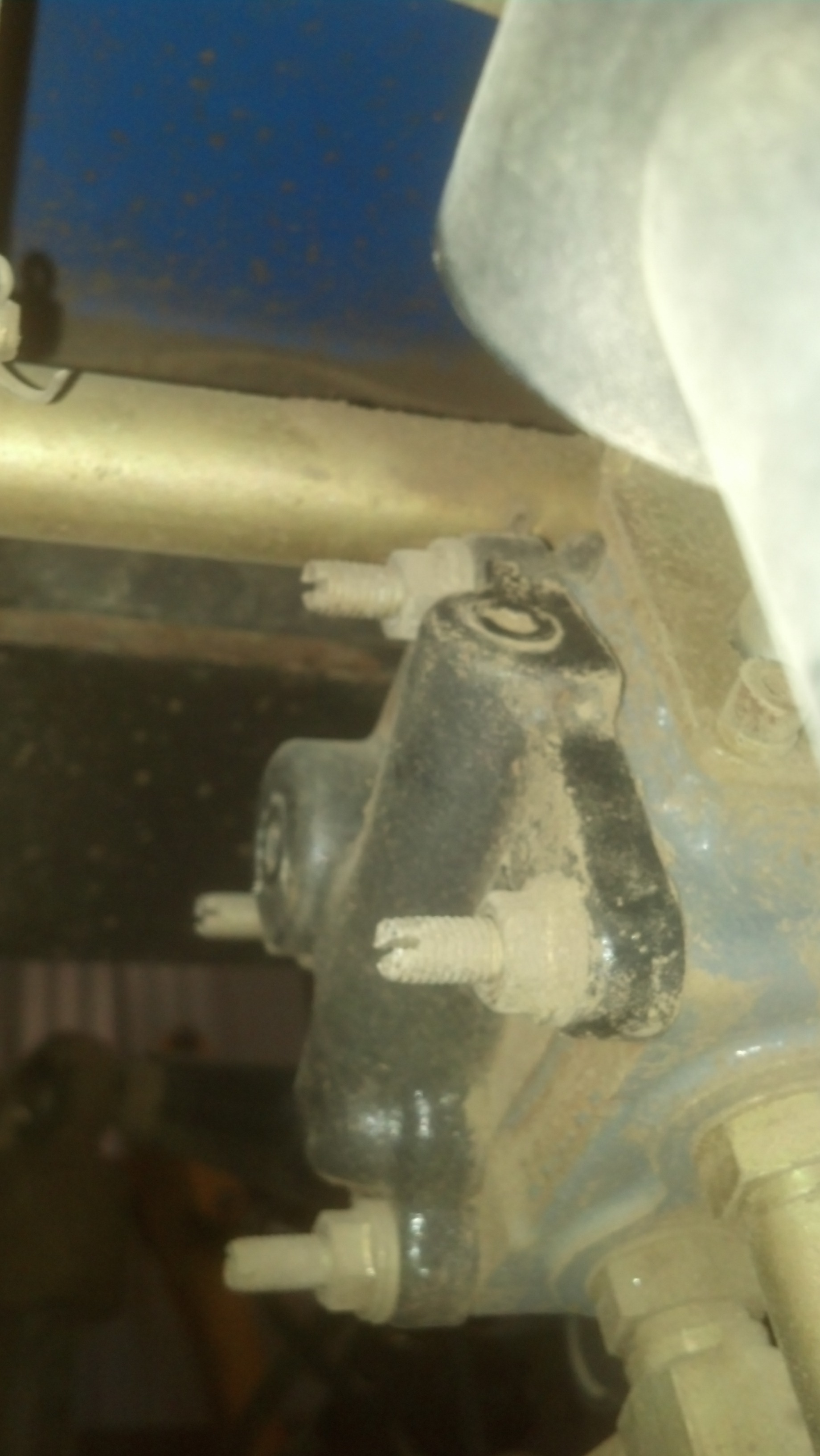

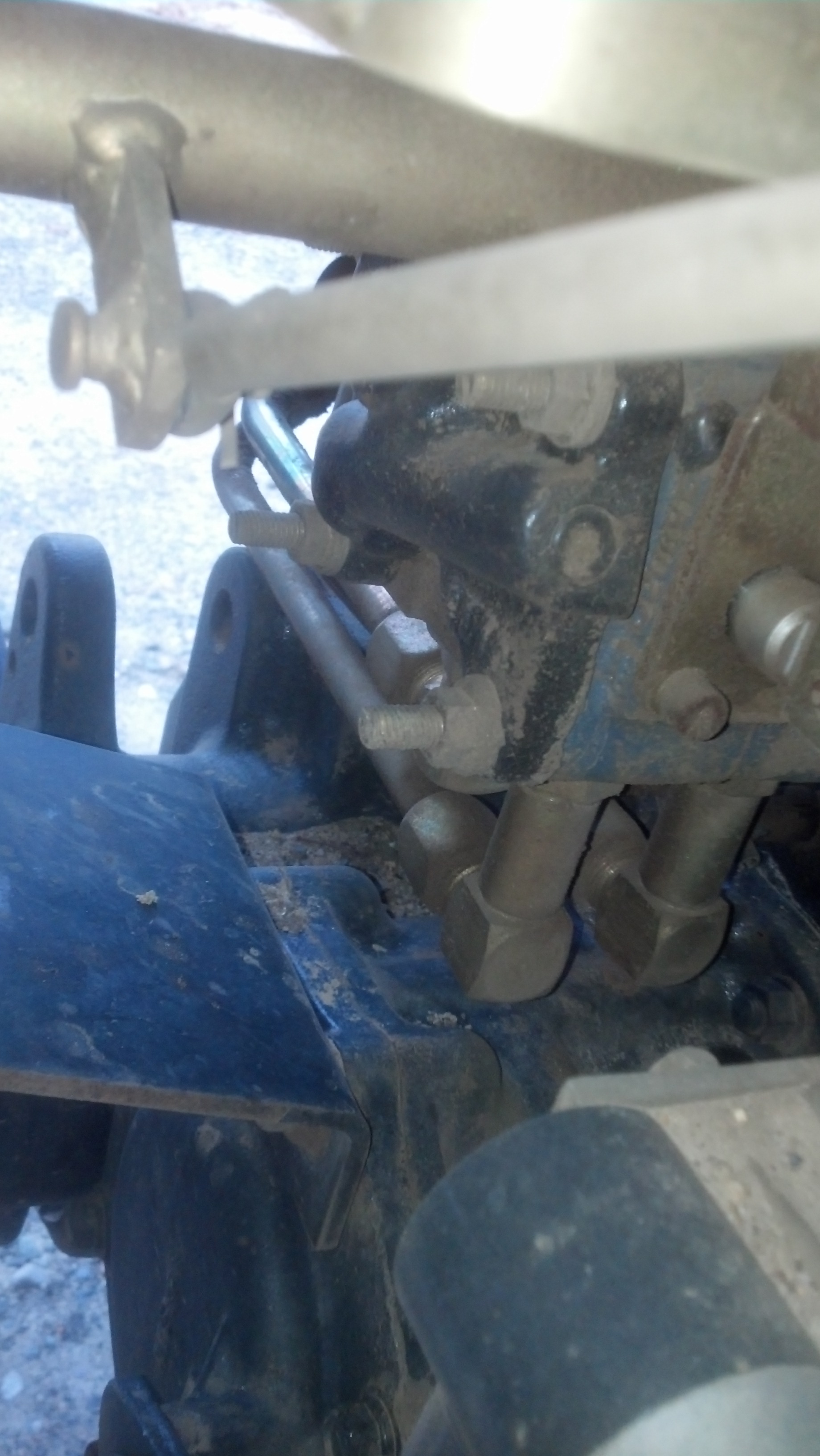

"The return can go where the existing pipe plug is in the OEM remote valve stack end cover."
Rick are you saying that I can pipe the tank return from the new Joystick into the rear remote valve stack end cap instead of using a "T" at the diverter Block? This would make things easier I wouldn't have to fight with steel tube to get a "T" in line and only have to remove the one PB steel tube and replace it with a hose to the new joystick. Which Plug in the end cap do I use the one facing the side of the tractor or the one facing forward.(see attached pictures.)
