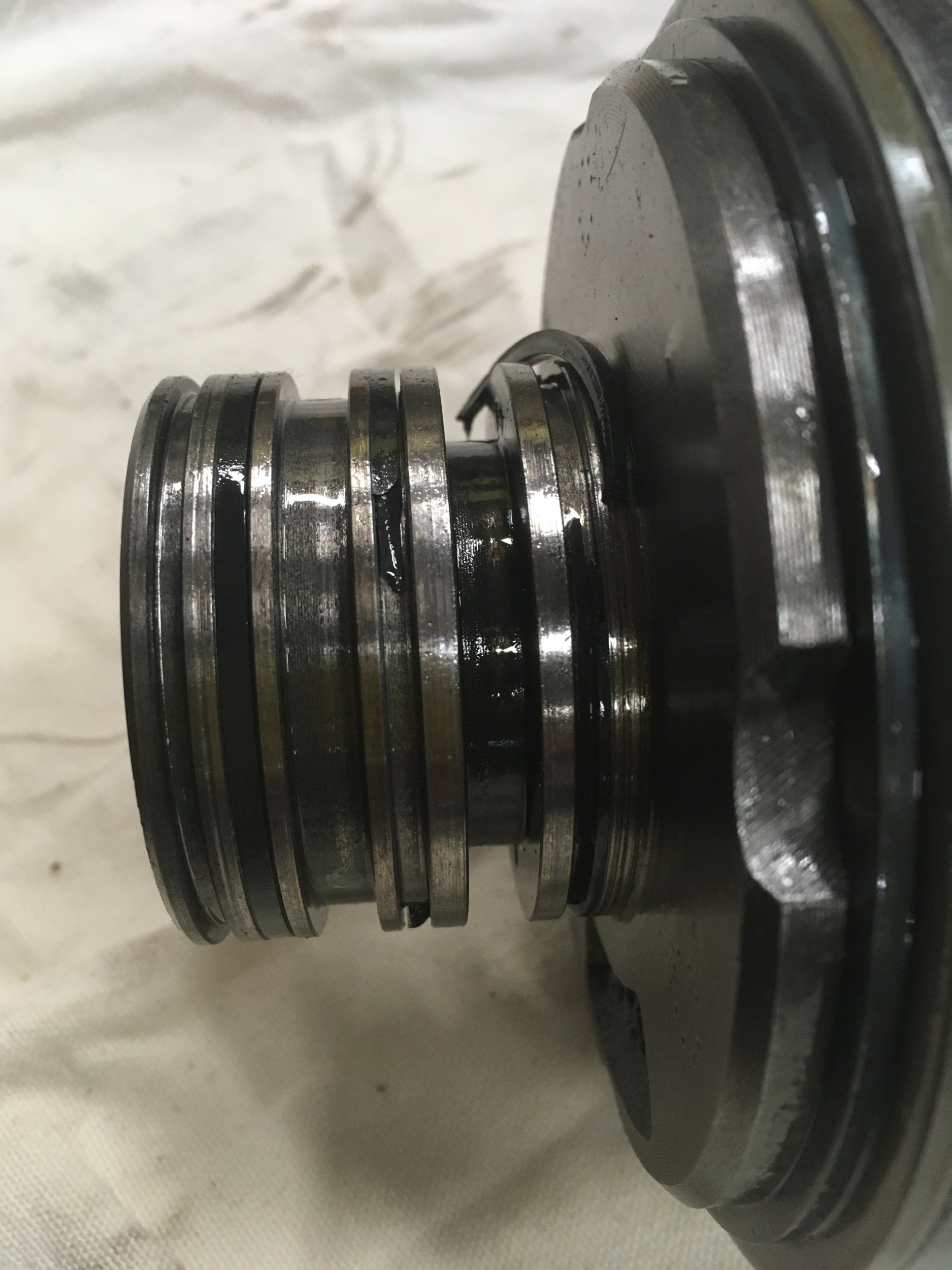

Well I finally decided to go deep and tear it down. I did all my pressure tests and tried adjusting relief valves etc with no improvement. My main hydraulic pressure was fine at 2600. The PTO control valve would not come above 120psi and would drop fast as soon as it warmed up.
I got into the PTO clutch and found 2 of the 3 hydraulic seals were shot. They basically fell apart in my hand when I pulled the clutch. Pretty sure this is the problem but can’t rule out a pressure relief valve until I get it back together. Seals and a few gaskets from Messicks for around $200 shipped. Each little seal was $50 !! Could not source locally. Another costly New Holland part that should be half that if it were any other brand.
I am going to look into my oil choices because this should not have happened in 300 hours. Could have been defective seals from the factory too. Here are a few pics. I will update when it’s all back together.

yes the pressures are adjustable externally from the pressure relief valve but those do no good if the rings that seal against the fluid are shot. It just lets the fluid past the clutch not applying pressure to the clutch discs
