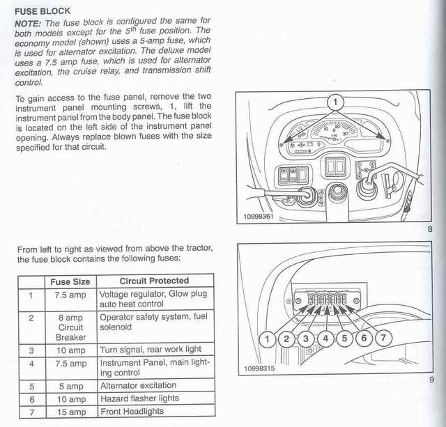

@greg0145 First thing to do is Check your #2 Fuse... If Fuse #2 is blown tractor will not crank & PTO Light WILL be illuminated.... Check that first... very common problem on the TC's
   / NH TC40A Starting problem #14
Here is a pic of the Fuse Block....

Problem solved! Fuse #2 was burned out. I put in a new one and everything is working fine. Unfortunately it wasn't the first thing I checked because I was impatient to solve the problem before everyone offered excellent suggestions. Thank you showcattle, thclimer, and dlctcg for the links, references and guidance!

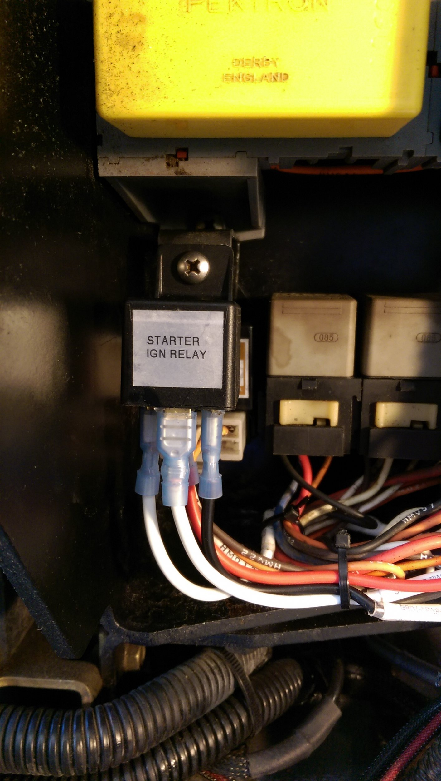

@greg0145 - Glad you found it... If it continues to act up, which is known to happen on the TC's as they get older do to resistance in the wiring & connectors. You can either get a auto-resetting circuit breaker.... or the better option in my opinion is.... to modify the starting circuit by adding a simple relay so the starter solenoid get direct voltage every time. Did it to ours... works great..
Pic of where I mounted the one on our TC40D
Not my design... Was posted on TBN & is a great guide on what needs to be done...
I also modified the starting circuit to my TC33D by adding the relay because on numerous unsuccessful start attempts. After the modification it has started every time.
