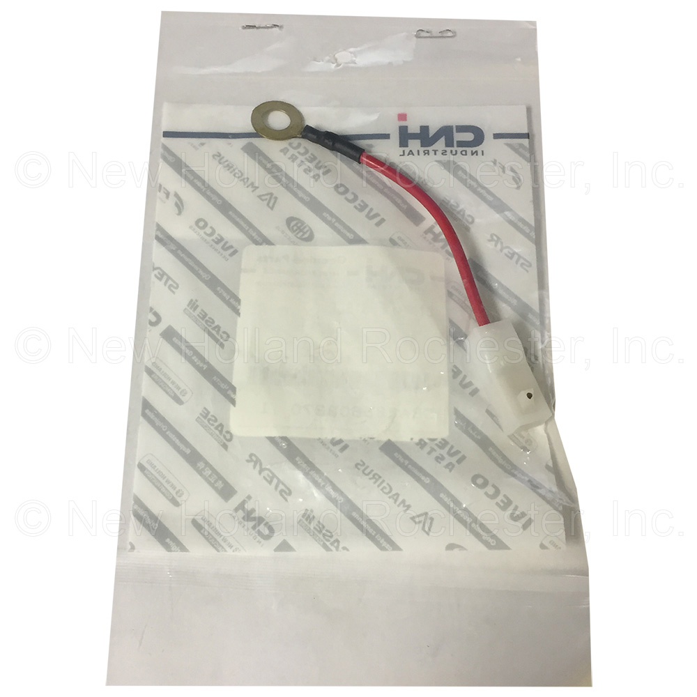

After bush hogging the field, brought the tractor up to top it off with fuel. Shut it down, put fuel in, and now nothing. I mean nothing. No lights, no cylinder warm up, absolutely nothing. Battery is 2 months old showing 12.5V resting.
Advice please?
Look for one of these. It will be on the main starter post along with the positive battery cable. Everything switch or dash related passes through it. If/when it fails the result is what you described.
