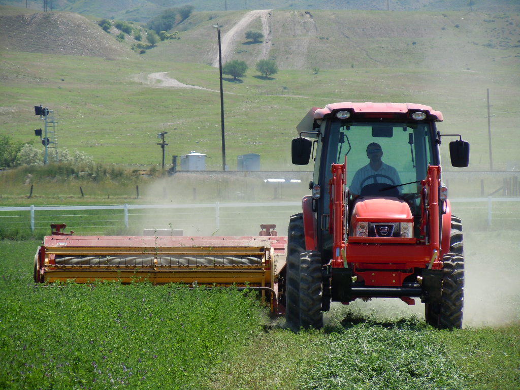

Not sure about your noise but I have a 488 model, and it works great. I did replace all the guards and lots of cutter teeth as well as changing out the gear oil when I bought it. DSCN1985.JPG
