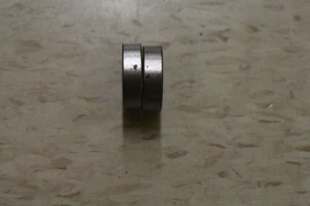

The rubbered bushing inside the section knife housing is slapping around in what appears to be an over sized hole. Are we missing a sleeve in the knife's bearing housing?:confused::confused::confused:

Take a picture.
Sounds like a bushing missing
/ NH 450 sickle #4
Sounds like two spacers are missing (Get from Messicks on ebay ($12)).
