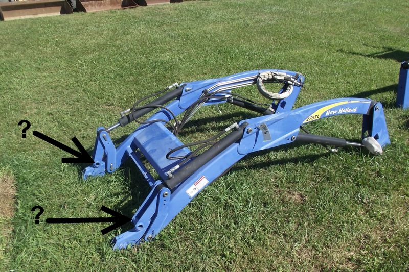

Can someone help.
I have a 270tl loader for my new holland tc55da tractor and the lift links keep bending and just had the one side just broke. is anyone else having this problem? and is there any solutions for this issue.

Not sure what you mean by "lift links" on a loader. Can you post some pictures?

Here is a picture I found online.
Where are the links that bend?

it is the piece in your picture, that comes off the cyclinder, it has 2 bears and just straight pcs on it.
in the picture it is hooked on one end and the other end has nothing attached to it.

I was thinking they might be the boomerang shaped links, possibly installed backwards? A Picture will help!

they are the same both sides. can not be installed backwards. i will get pictures

Sounds like these?
Are you using a bucket that came with the loader?
Need to see pictures of the bends.

Yes. The bucket was purchased with the tractor.
The part are being fixed now, I will send pictures. Your picture with the arrows is right on thoses are the parts

originally those parts were simply two bushings connected by two pieces of flat stock. Second level replacement parts and probably later production pieces have a third piece of flat stock creating a full channel between the pin bushings.
