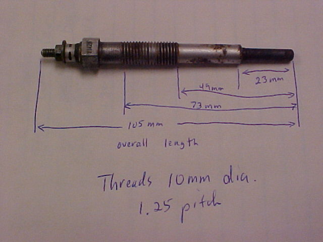

Hi guys,
I was wondering if anyone had a really good resource for NGK glow plugs. I have 4 that need replacing and the parts stores around here give me the "you want what?" look when I go in there looking for tractor parts.
I need 4 NGK Y142T glow plugs on one of the hex sides it also says 88X2.
I have been looking for a really good glow plug resource and have yet to find it!
Thanks for your anticipated help!
Nick

I'm attaching a pic of them.

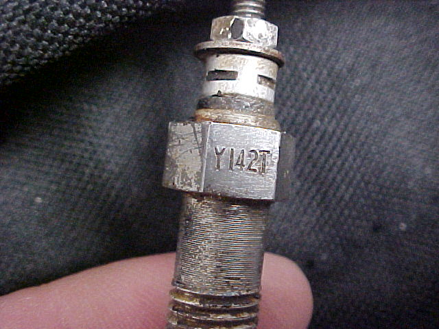

   / NGK glow plugs
another view, not a good NGK part # ???

Can we assume that somewhere you have evidence of them being NGK brand? Any chance that sometime in the past the OEM glow plugs were replaced with another brand with that part number? And I would assume you've taken one of them to one or more parts suppliers to see if they could simply match them by size, threads, etc. Sounds like a frustrating problem.

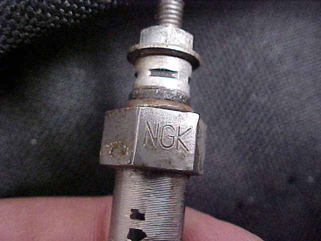

heres a pic

   / NGK glow plugs #9
OK Nick, here's what I found out. I called NGK and asked them about your glow plug. He said it isn't available for after market. It's only available by way of OEM. You will have to go back to the tractor distributor. NGK's # is 877-473-6767

Hi Nick,
I believe NGK stamps the "voltage" on the side of their glow plugs... what other numbers/pictures do you have?
Also, have you confirmed all four glow plugs are "open"... how did you test them? ... and if so... you may also have a controller problem that needs attention... I'd hate to see ya spend ~$50. for 4 new glow plugs and burn them up in seconds... /w3tcompact/icons/frown.gif
   / NGK glow plugs #12
Hi Nick Ialso am looking for these glow plugs. I called NGK and with them. I found another plug that I think will work. It NGK Y128T. It matches the Y142T IN VOLTAGE 8.5 thread 10mm and is a fast heating plug like the Y142T. I have orderd three from amazon.com but have not received them yet. I will let you know. I almost forgot it is 2mm shorter than the Y142T. aLSO GOOGLE etechno1 and type in thr ngk Y128T and they give you cross references to several different brands Randy
