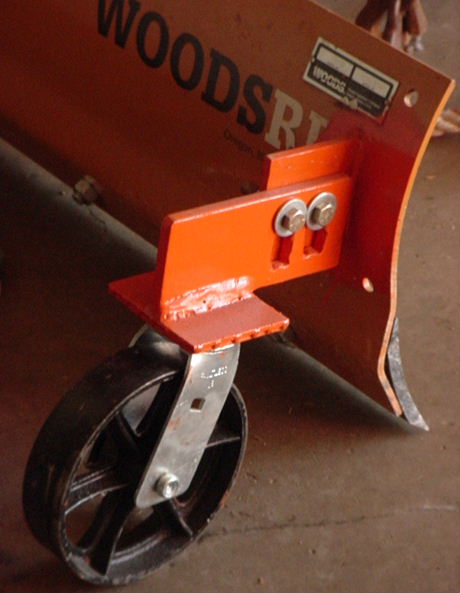

Hey SkunkWerX,
How do those solid rubber wheels hold up in cold weather? I had solid rubber wheels on mine and the "broke" when it got cold. Had to go with these steel wheels. I think I got them at TSC. Ball bearings.
   / Next Project: Gauge Wheels for Rake & Blade #19
i dont think ill be using my york rake in the cold,cant speak for any one else though
   / Next Project: Gauge Wheels for Rake & Blade #20
Duh.... I guess I just use mine on a RB. Sorry.
