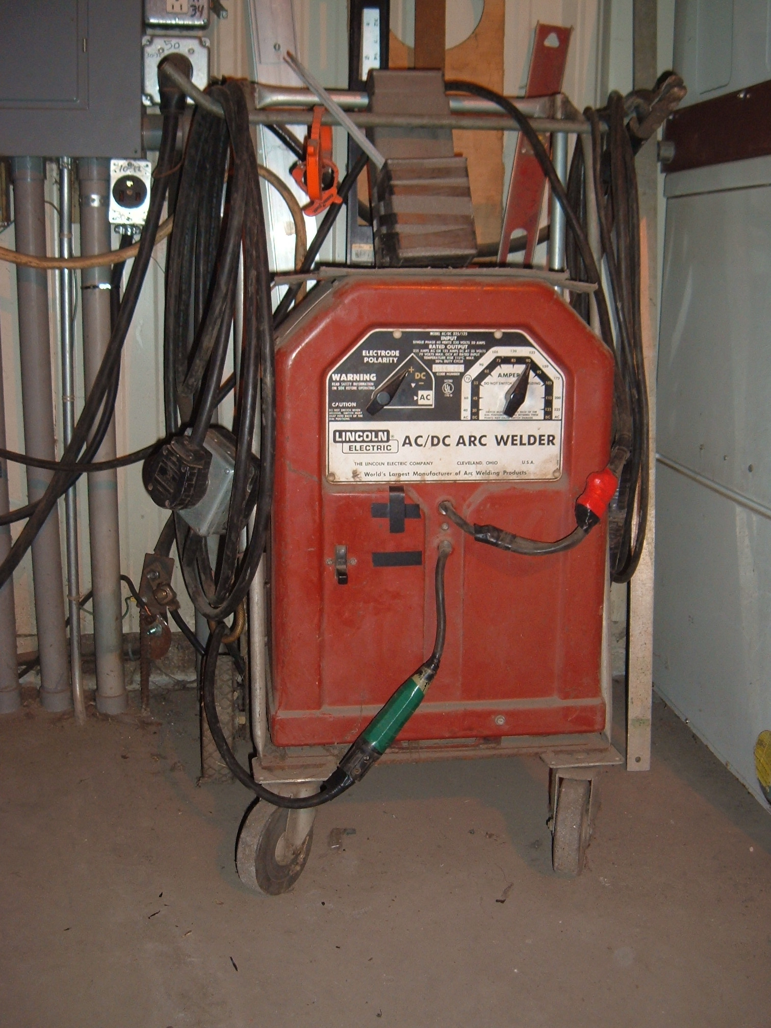

I run my little DC buzzer north of 5# at a time as fast as I can put them in the stinger. That 200 should easily run 1/8 like that, pretty much continuous or as fast as the operator can.
I have a 300 synch but I never use it with that, I can manage ok with 1/8.

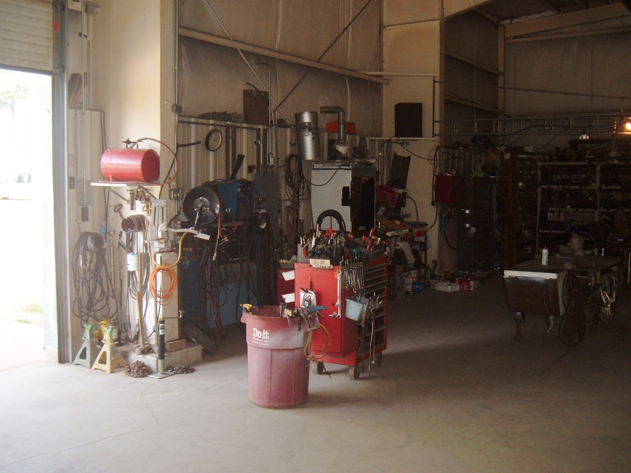

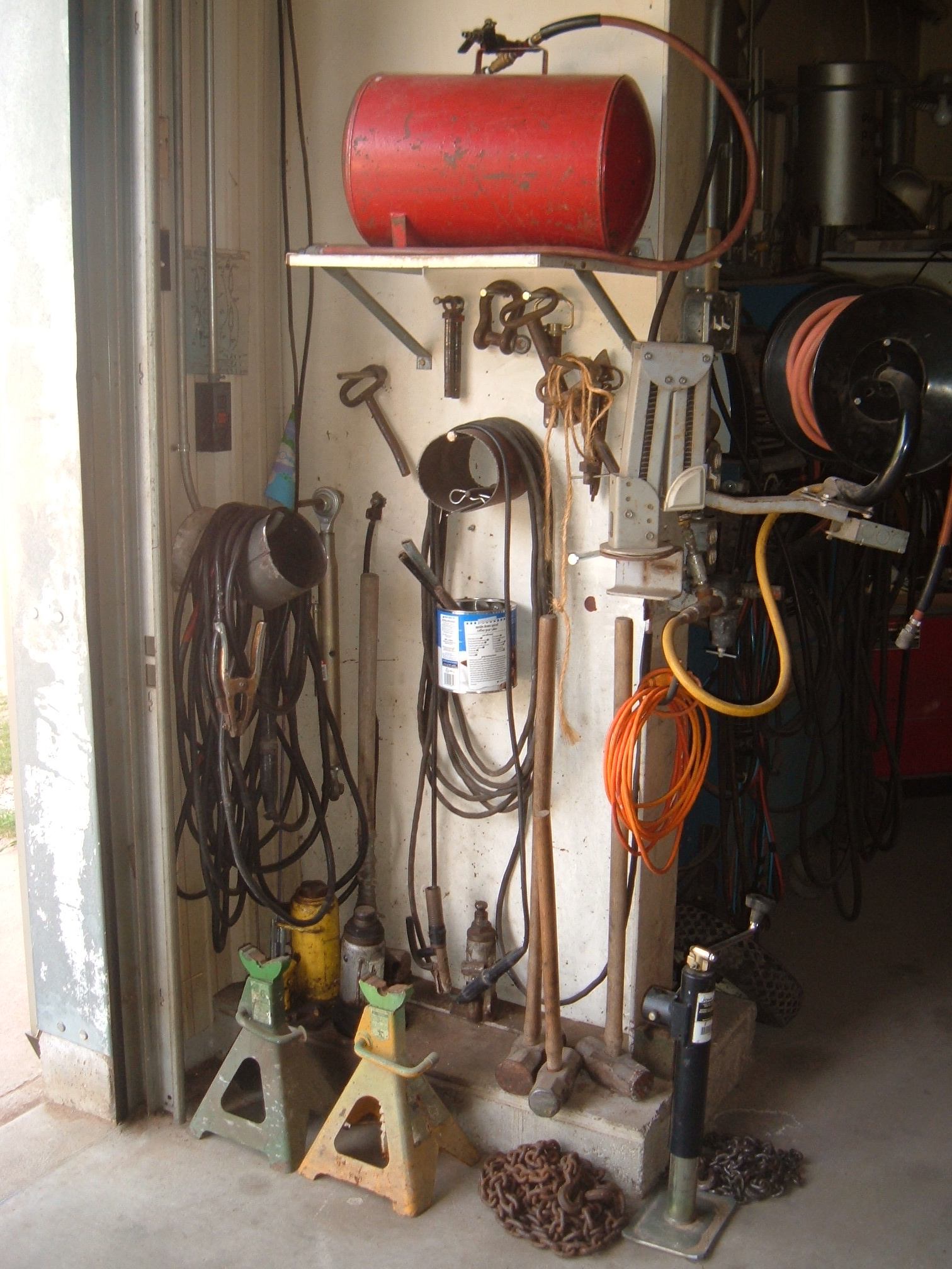

The little machine above pic has a green connector goes to a common ground for several things, hooks benches, stick leads, plasma ground together along with a couple whips/leads with clamps. One for outdoor and one an extension to the bench and could be used if needed to move the machine. Very rare. They there is a Y on the stinger side with a piece about 15 ft local to the work benches and welding booth and another goes over to overhead door to have stingers for outdoor and shared plasma ground.
