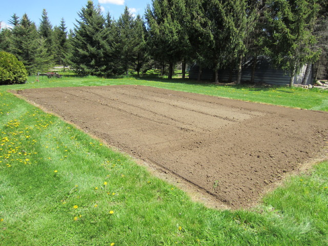

My FRT has been fine if you wait for the soil to be ready for tilling.
