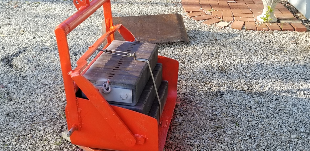

Yes, you need more weight on your 3pt arms. I made a ballast out of weight off of an old weight machine and modified an old dirt scoop to get a 1000# ballast. You can purchase one, or get creative and build one.....but the backend of your teeter totter needs more weight.
   / Newbie terror, need experienced advice #6
Ballast box can be cheap rear weight, you can fill it with all sorts of things, sand or gravel, concrete, I have old rotors and weight lifting weights in mine.
