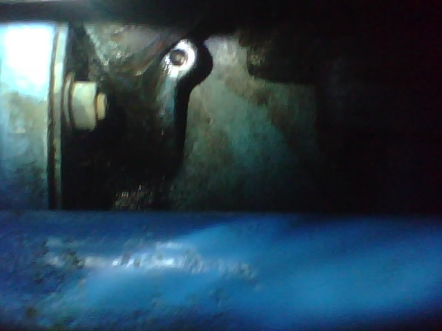

Thanks for the info. I looked all around the hyd pump. All I found was a smooth bored hole under it and another behind the coil. Could someone have stripped it out and put a plug in? It looks like a tiny brass freeze plug. I've tried to post a pic (may have to wait till daylight).

if you are looking by the ignition coil you are looking towards the WRONG end of the engine... the lil brass plug should be there and is normal
the hyd pump is back just in front of your feet... and the plug is nestled at the point where the pump bolts to the block
pic is so close.. can't really tell what it is we are looking at

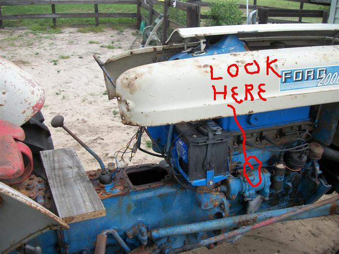

here's a pic of my semi- dismantled 2000.. smae basic machine

/ Newbie needs help with old Ford 4000
The pic is of the hole directly beneath the hyd pump. I shoved my head in there a little deeper and I think I see where it is (hard to tell with the pump in the way). You're picture helped alot. Thank you. I never would have found it without your help. It looks like I will have to remove the pump to get to it.

/ Newbie needs help with old Ford 4000 #11
look from above the pump, not under it. it's very near the top of the pump, and of course in the block. fitting should be plainly obvious unless it has been plugged flush somehow.
#14
I got it installed. Don't have elf hands so I had to take the pump off. The PO had put a bolt in it. Ran all over town to find a fitting that would work, but I finally found one. Got 40 psi at idle, 60-65 at WOT.
