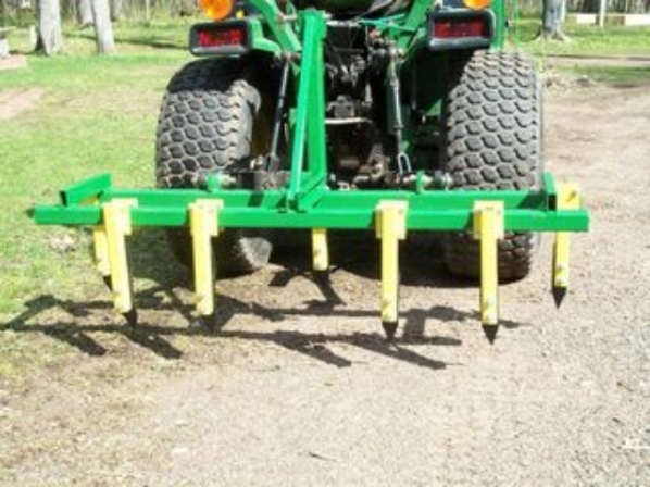

A number of years ago, I built a homemade 3pt "frame" 5' wide and about 3' long.. It would accommodate bolt on chisel shanks, row hiller wheels, cultivator shanks, thatch rake times..
Kind of a do-it-all set up, just add, subtract dirt engagement accessories.. Frankly at the time this was the best, easiest solution to many needs as there were not the variety of implements available.. And regardless of how expensive general and specialty attachments are now, the thing available then was out of this world expensive..
This is one of the frames I made and one way it was set up..

Very nice tool bar. Straight forward and simple. Easy to weld on different implement attach points.
A tool bar is not that complicated. Like the one shown an easy build with the right materials and very adaptable for many uses. There will be numerous uses it can be used for.
