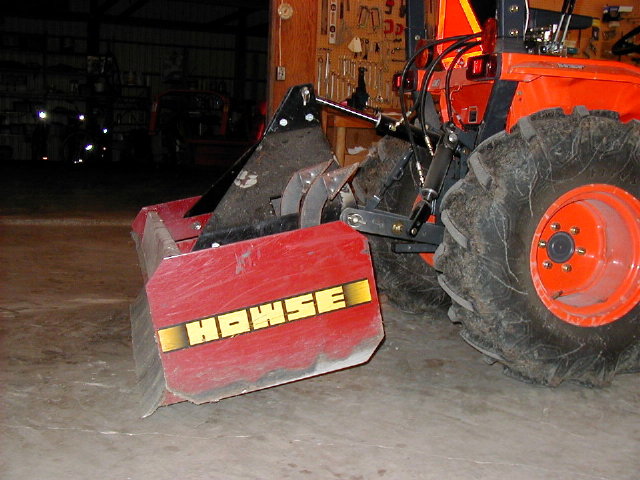

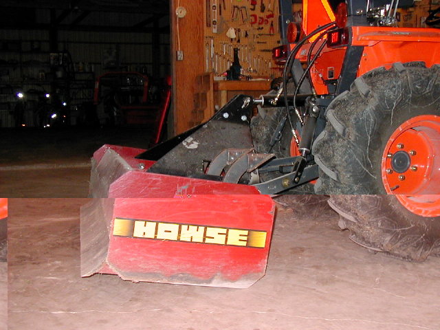

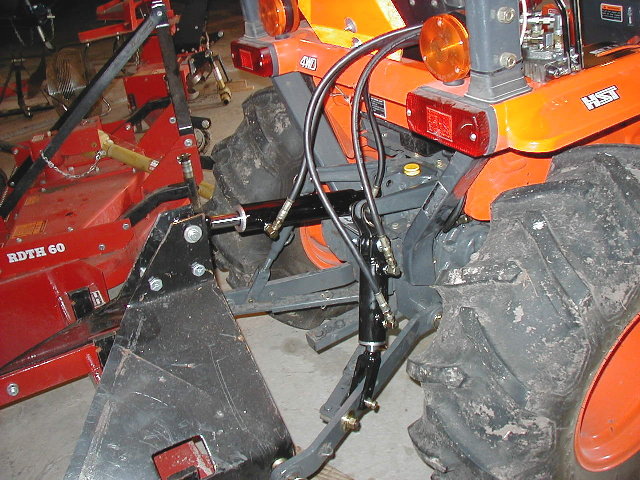

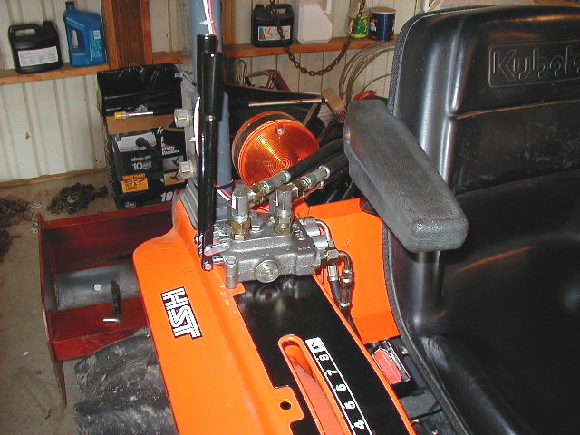

Keith, you will need a 2-spool valve for both top and tilt; i.e., one spool to control the top link and a second spool for the side tilt. You'll need two lines or hoses to go to and from the valve to wherever you tap into the hydraulic system. Then you need 4 more lines or hoses to go to and from the two hydraulic cylinders; i.e., between those cylinders and the new valve. The 2-spool valve may be controlled simply with a lever for each spool, as I did, or it is possible to use a joystick. The normal front end loader uses a 2-spool valve; one spool to raise and lower the boom and the other spool to roll back and dump the bucket. You can use quick couplers so that you can unplug the cylinders and plug in other equipment such as your log splitter. I did not use the quick couplers on my tractor so they were "hard wired?" (well, maybe "hard plumbed":D). These new lines and valves will not keep you from raising and lowering the 3-point hitch.
Of course different tractors may have a different place to tap into the hydraulics. The front end loader may have a valve with "power beyond" or in the case of my Kubota there was another "auxilliary hydraulic outlet" upstream from the 3-point hitch valve. Using that outlet meant that the 3-point hitch could not be raised or lowered simultaneously with operating the top 'n tilt valves, but there was never any need to do that anyway. Since I only have one right arm and hand, I could only operate one lever at a time.;)
The first picture is my two top 'n tilt cylinders and I think you can see there are 2 hoses to and from each of them.
The second picture is the 2-spool valve I mounted on the fender of my B2710 with a straight vertical lever to operate each spool.
The third and fourth pictures show how far forward and backward I could tilt the box blade. No picture showing the side to side tilt.
