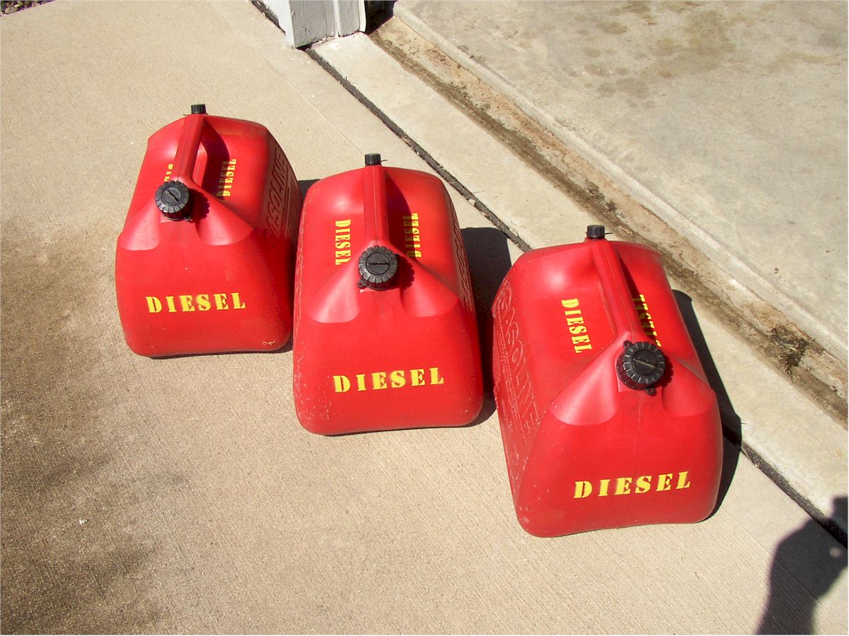

Welcome to TBN. Glad you caught the error in time. Sounds like you should be OK.
My diesel cans are red (had them a long time) but I have them clearly marked. I created stencils from a font I found and sprayed the letters onto the cans with yellow paint. Perhaps you could do something similar with your gas cans to grab your attention.
