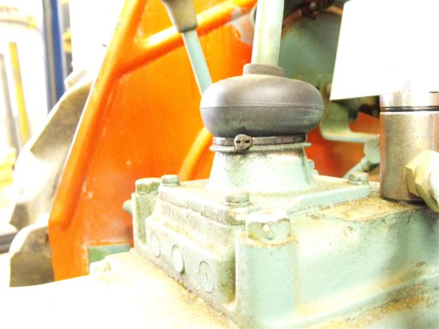

If (as the others have said) everything checks out, you can put a zip tie around the bottom of the boot and it should stop the seepage. My 1900 had the same problem and it was suggested to me to use the zip tie and it has not leaked since. I think sometimes the boot relaxes a bit and doesn't grip the bottom of the shifter grove tight enough. Oil gets slung up there by the transmission gears.

After doing what all the others suggested .You only have on thing that was left out. Of course IMHO. Wipe it off and don't worry about it. Mine will have a drip or two every now and then.;) And also welcome aboard.

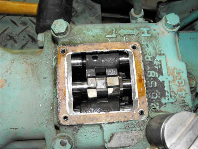

In theory (and hopefully by design), oil should not get up into the boot. In reality sometimes it will. I don't know what the special circumstances are that allows it to get there, overfilling the transmission, high speed running etc. Unfortunately once it gets in there there is no way for it to get back into the transmission. I think it would take a long time to fill the boot but it is possible. If oil is seeping out of the boot, using the zip tie will hold it in the boot for a quite a long time.
The shift plate is open to the gears just below it so it may just be the spinning of the gears that throes enough oil up to get past the spring and dome into the boot where it's trapped.
