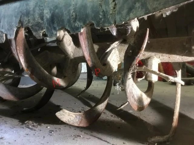

I know exactly what you wrote. You made false statements and I called you out on it and now you are going on the defensive.
Clearly the OP's tiller doesn't meet your definition of a HD tiller. Fair enough. It still only has one bolt per tine, and it wasnt assembled wrong by the dealer or something else wrong with the way the tines are mounted as you claim.
Im not making anything up and dont know what your beef with me is. This is supposed to be educational. You clearly admitted you havent seen tillers with single bolt tines. I have seen, operated, and worked on several. I wouldnt call them inferior in any way. Just a different design in how to support and retain a tine is all. There are good and bad of both types. Most of the single-bolt tines do NOT rely on the bolt to support the tine entirely as 2-bolt tines are often attached.
Here is an example of a bobcat tiller made for a skidloader that has single bolt tines
Older yanmars....(while not exactly heavy duty tillers) have a bit different approach to single bolt. There is a welded pocket the tine inserts into and the bolt simply retains the tine in the pocket

Thanks for commenting. I'll tighten those up today.....but I'm with sawyer rob ...I feel like running away from this one. I'm going to feel uneasy every time i use the unit. If they loosened that soon after use being brand new seems like it will happen all the time. Not sure if I want to keep it or not.

Sir after you get it all worked out I think you will really enjoy it. I use mine all the time. Have different things in the truck patch coming in all time. I’ve got a big old Massey and I chisel plow my ground before I till, but that’s only because I have the time and equipment. Good luck
