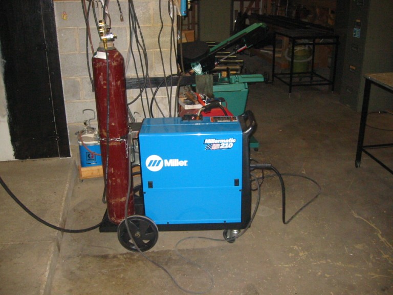

I am kind of suprised that no one mentioned the MILLER DVI I kind of mentioned to the wife that I would not be upset If i found one of those under the christmas tree this year. For the light welding that the poster is going to start with he can use it in 115 volt mode and not have to run his 220 V line so soon. For the heavier welding he can hook it to 220 volts and use it for heavier material. To me the versatility of this machine makes it very handy to have for non professional welding useage.
/ New Welder-Suggestions/Perspective/Pointers/Tech Info #27
I have been thinking about a welder and not sure which way to go, this welder seems like it would be excellent for general farm use. Pretty slick being able to run it on dual voltage and the price appears reasonable. I just wonder how that price and machine compares to a machine that only runs on 230 volt?
/ New Welder-Suggestions/Perspective/Pointers/Tech Info #28
Actually there is a company that sells welders on ebay. You can go to ebay and type in millermatic on the search and that company will popup. The have a machine that is strictly 230 volts and close to the same amperage but a higher duty cycle. it is actually 400 to 500 dollars higher. It is actually a heavier duty machine. The only thing I have heard about the DVI is that it is not set up to run a spool gun like the heavier welder does. You have to get an adapter for the spool gun The heavier machine a spool gun just plugs in. Since I do not see me useing a spool gun for anything that would not be a problem for me. I do like the fact if i have to take the welder anywhere to weld anything light I dont have to worry about a 220 plug in for it.
