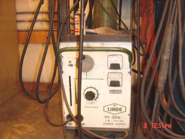

Years ago, I owned a Linde VI-206 Mig welder with inductance control. With inductance control it is amazing the control you have over the puddle!:thumbsup::thumbsup:

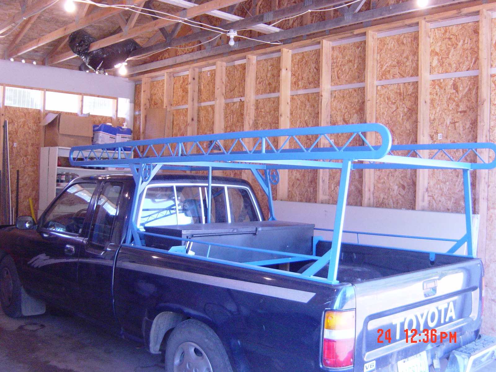

That Linde Mig welder had a Mig 21 wire feeder on top of it. I built a lumber rack for my pickup. Out of 1/16-inch thick box tube. I used .023 wire, the wire feeder had a very hard time pushing that small wire through a 15-feet long gun. Now .030, .035, and .045 wire it did great!
