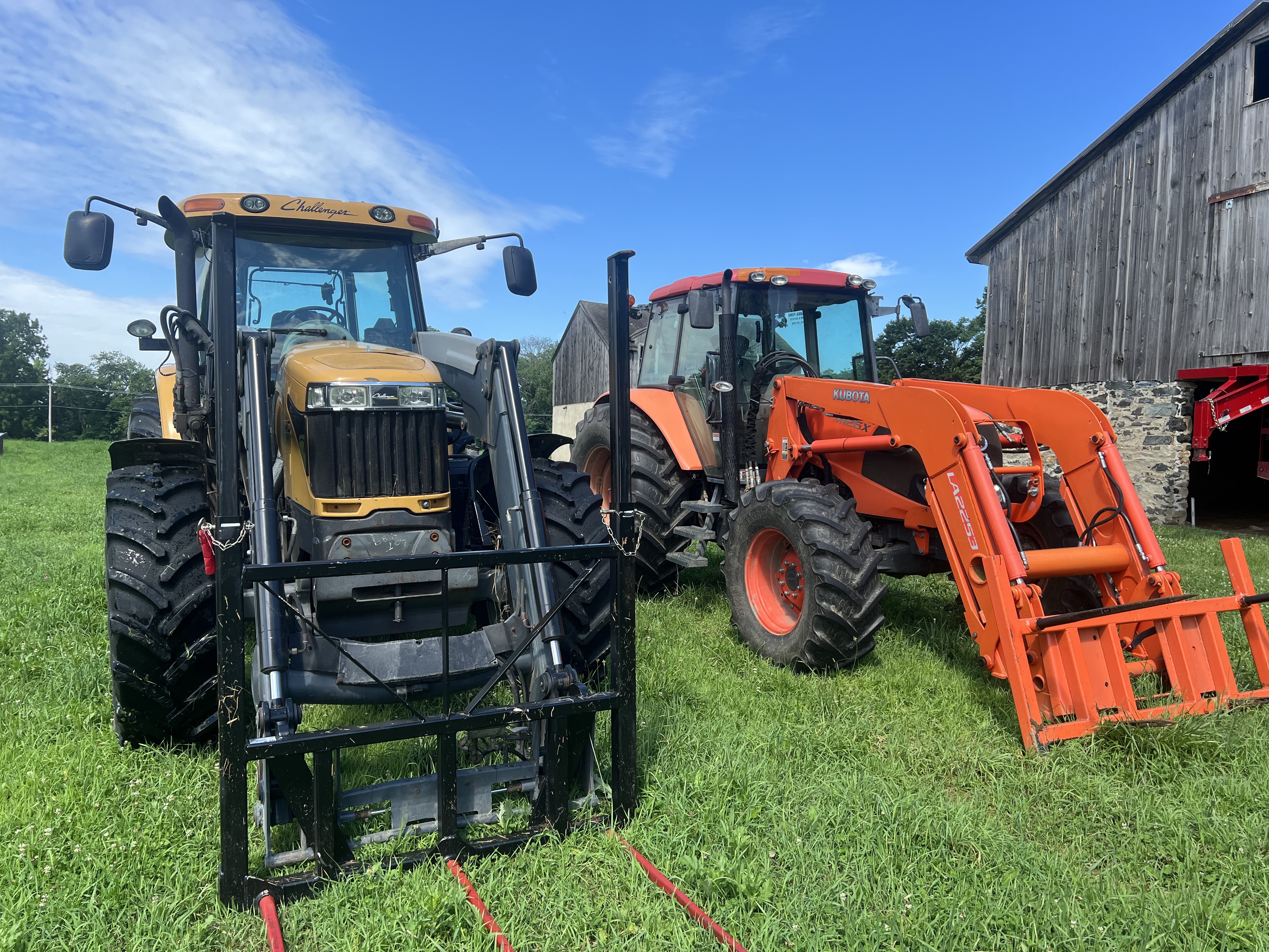

It was disappointing to say the least. I expected more. Most of the tractor was ok, but I found the Kubota was lighter built by like 40% in weight and the hydraulics were much weaker.
Here’s a photo comparison of my 2 135HP tractors. Both are 2010’s. The AGCO Challengers tires are about 40% larger than the “comparable” Kubota. It weighs 5,000 more pounds. The loader/hydraulic pump lits twice as much. The front & rear axles are 50% bigger. Only thing they share in common is they’re both 135HP.
The premium is for the purpose-built heavier Ag built components and the ag dealer support.
You’d be much better off with a used legacy brand real Ag tractor than a new aisian utility tractor. It doesn’t have to be an old open station noisy thing. Look for a 10 year old Massey, Deere, Case-IH, Challenger, etc. They have cabs/AC/buddy seats/all the comforts, too.
