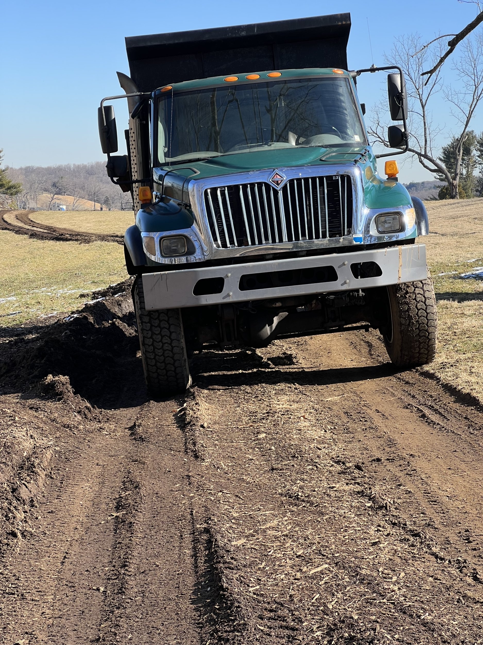

Still chugging.

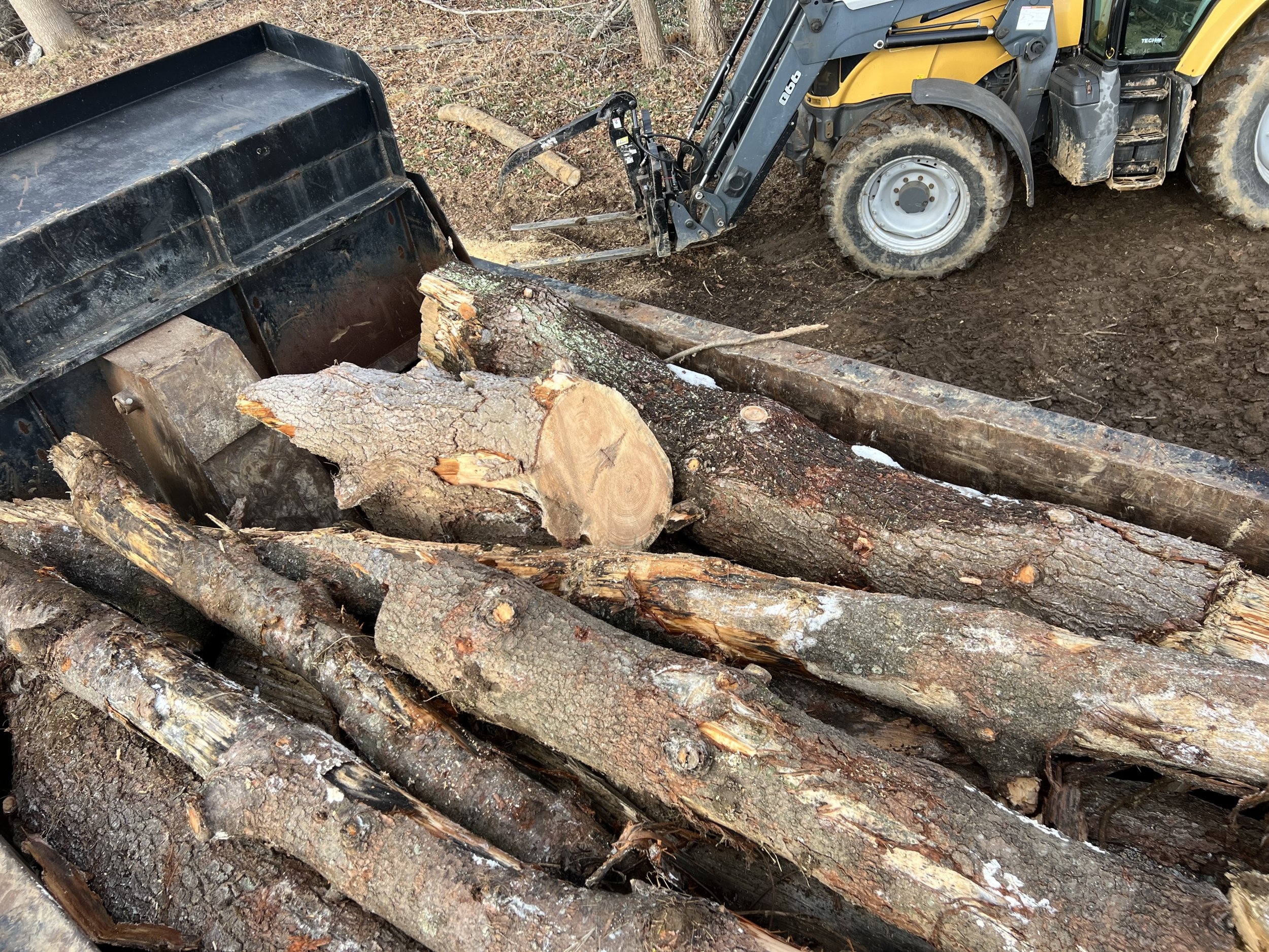

Almost 2000 miles put on it since January haulin logs.

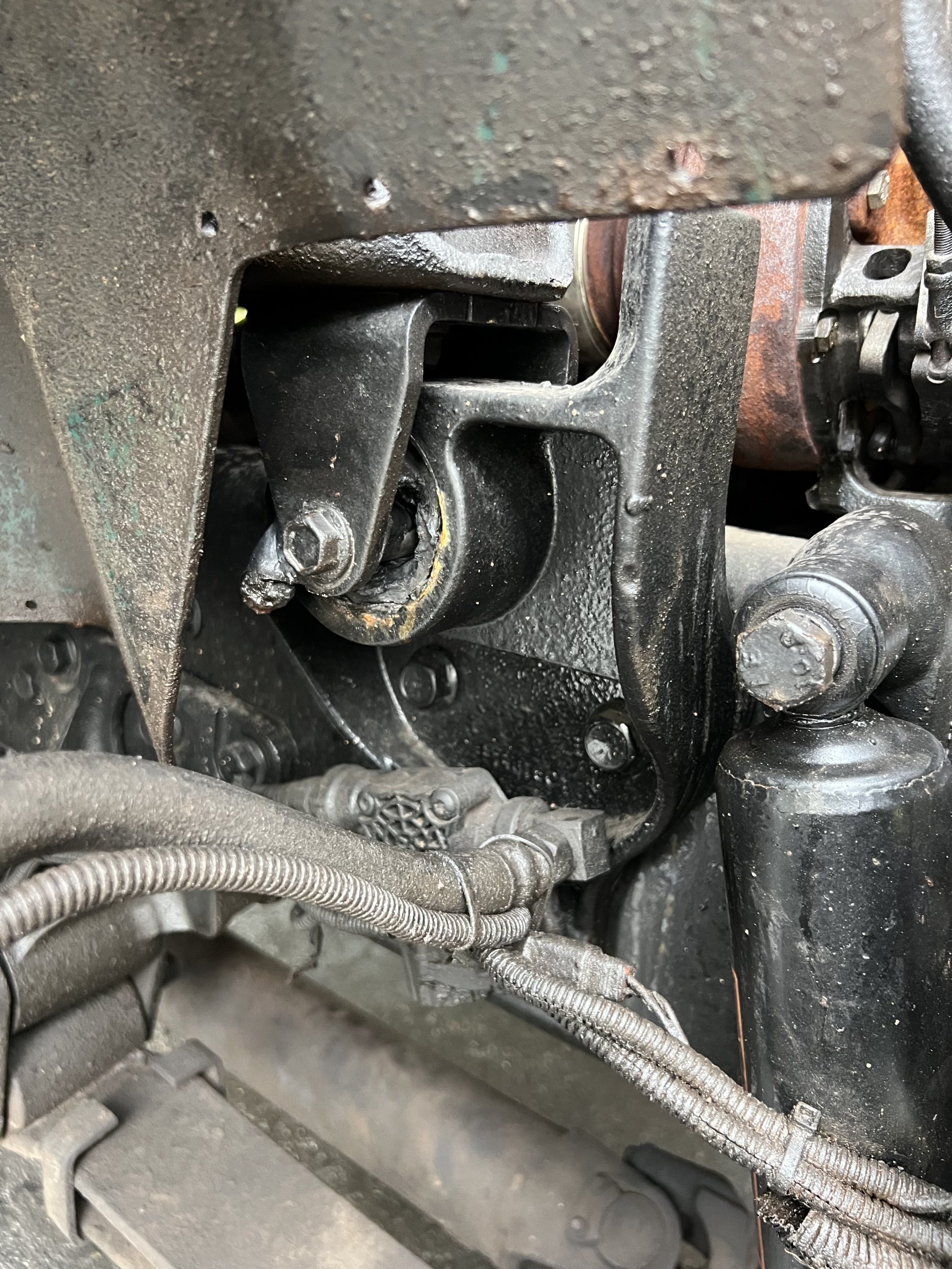

Nothing to report except a “Check AC“ light, which actually went away and a popping metal sound which I haven’t had time to investigate!

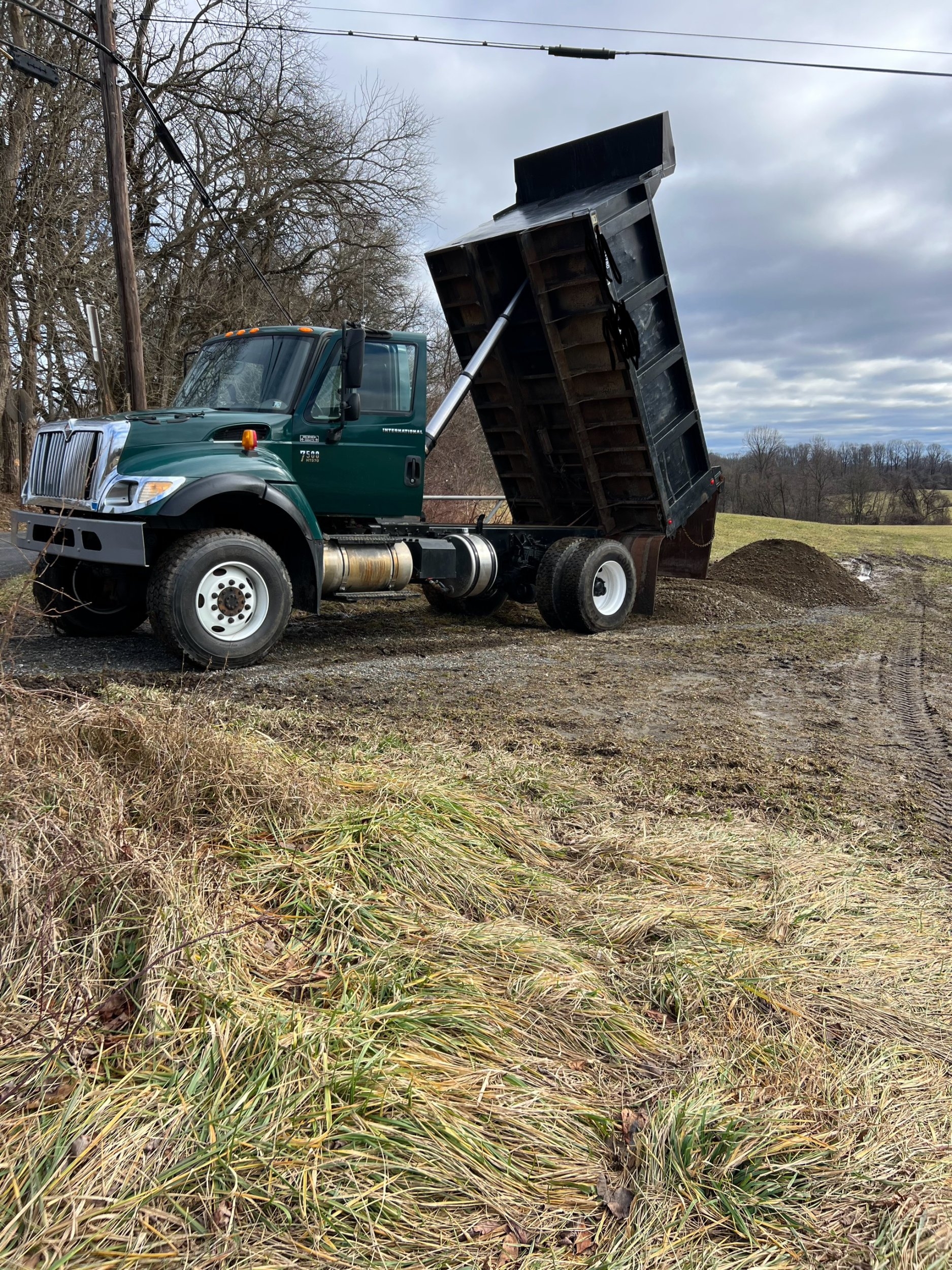

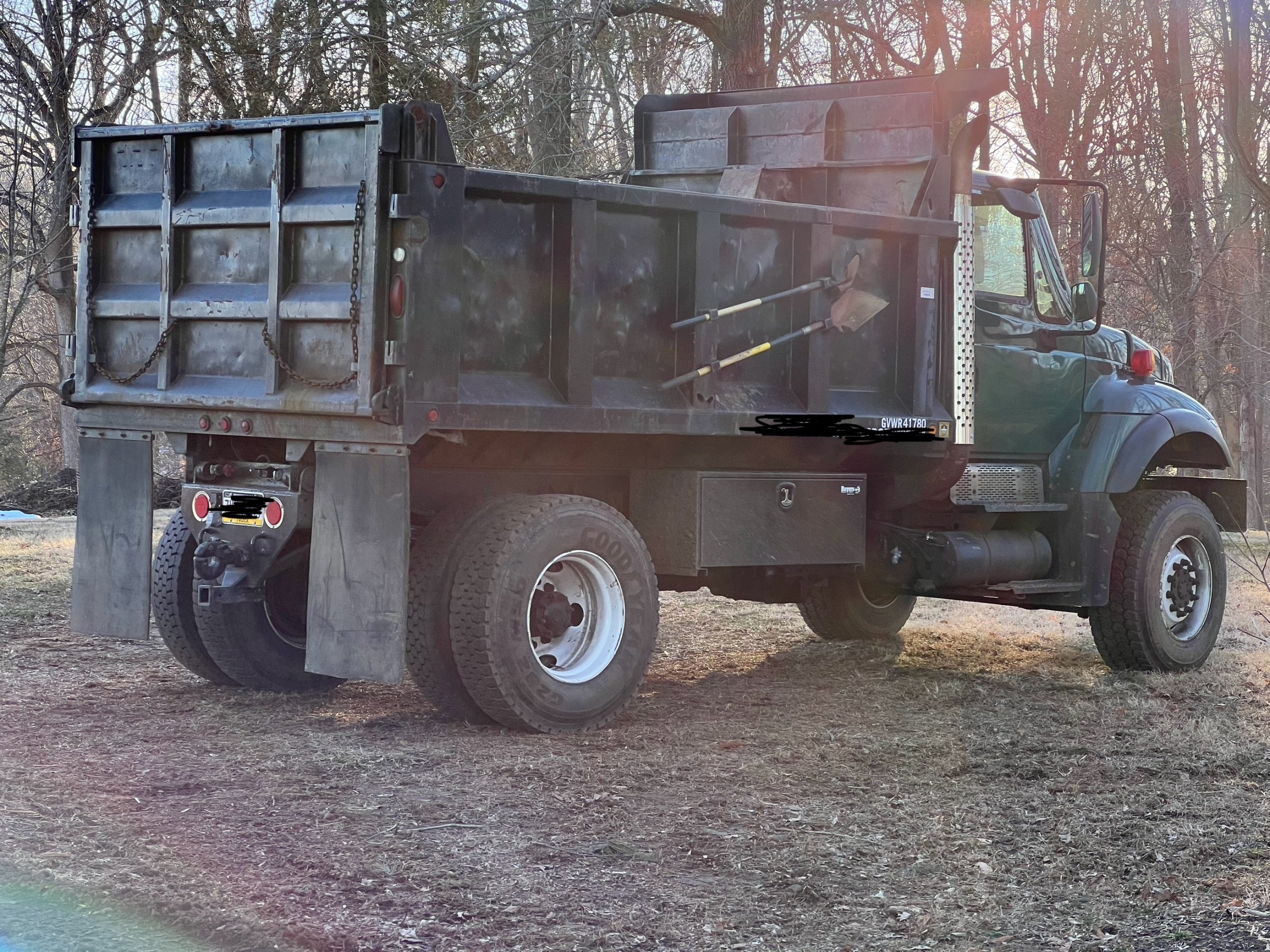

Dump bed holding up well. Not bad for $3,500 bucks. I like that it already was a little beat up. Nothing worse than that first dent. This one’s got plenty of ‘em.
End of day. Back at it again tomorrow.
I’ve logged about 2,000 miles of log hauling.
Did some stone to the entrance of one of my fields, too. Can’t forget that. lol

Found source of popping noise.
Cab mount bushing
