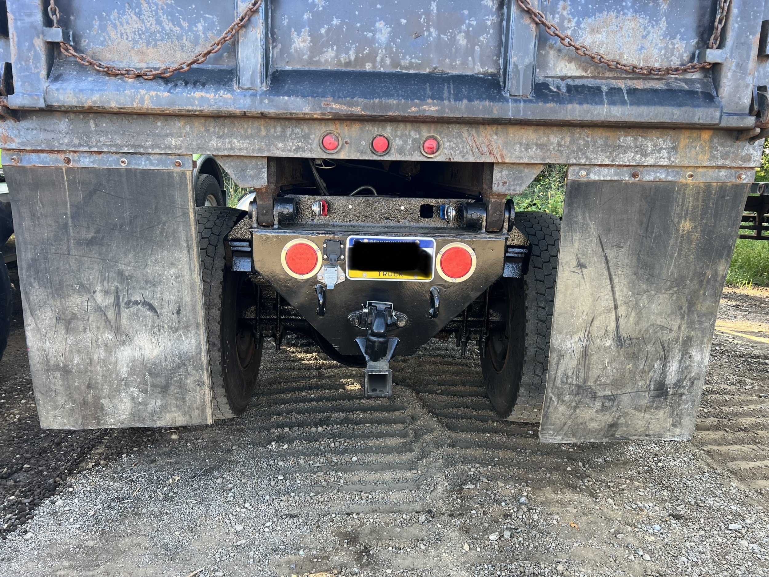

I'm sure it won't affect anything but why is the pintle skewed?
It looks like the same hitch my truck has. It’s free to rotate 360 degrees. It’s kinda annoying because if the trailer is a little to low it will flip the hitch sideways.

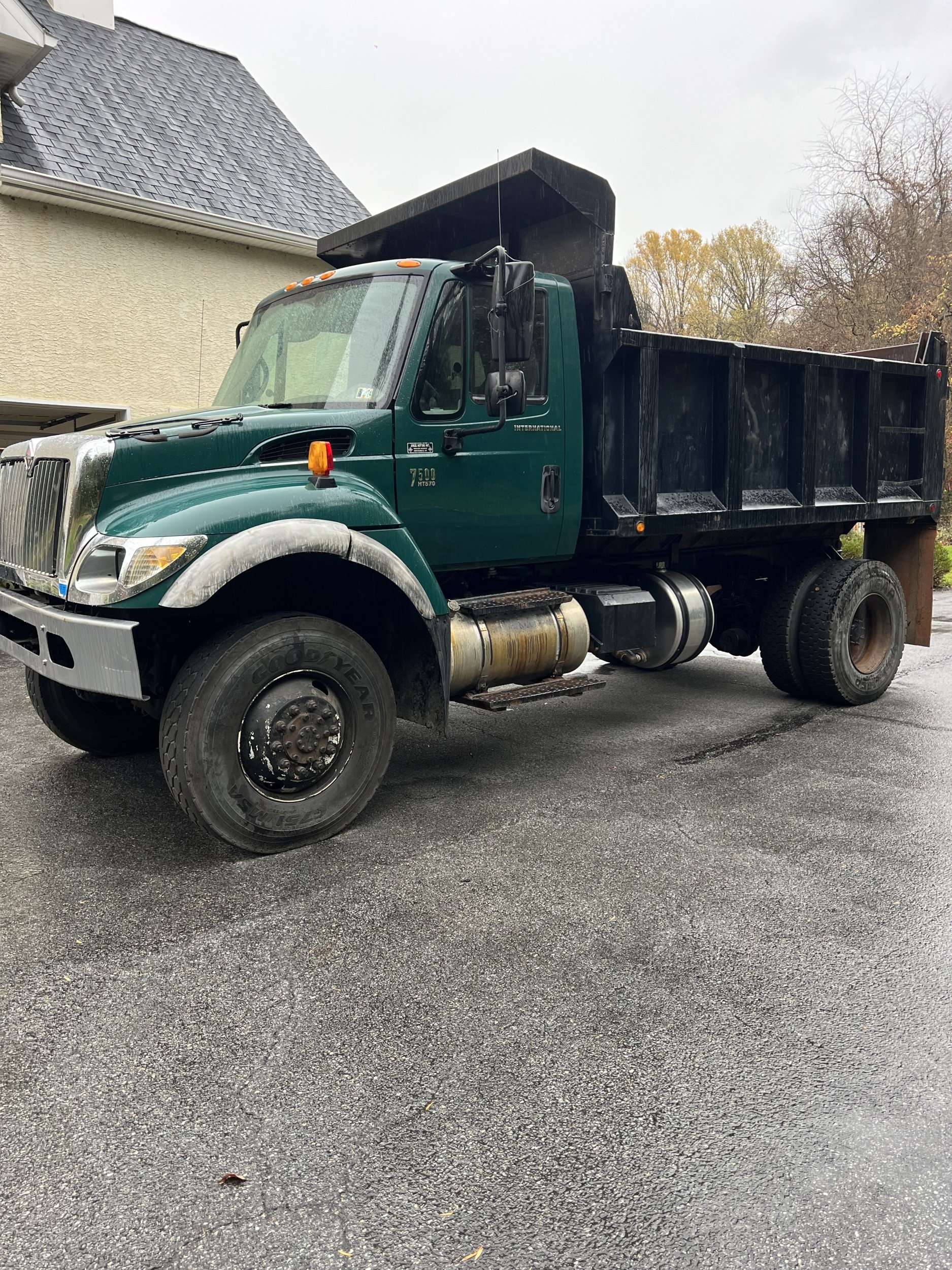

Well, the 7500 4x4 is back and in service. Truck would not start. Turns out 2 of the 3 batteries I installed just 10 months ago were defective!! I was given free replacements and decided to add a new 3rd battery as well.
Still working the bugs out on several electrical gremlins. One is headlights not working. Other is a parking light on the front fender not working.
Fixed those 2 this morning. Previous owner mounted a switch on the dash. I didn’t know what the switch was for (no label). My headlights were not working. After exhaustively trying to track down the issue, here it was the unlabeled switch :mad: Turns out the switch is used to turn headlights “off” and the old plow lights “on”. OK, now I’m done clanging my head off the wall trying to fix that one.
The parking light was a wire that was chewed about 90% through. There was maybe one corroded strand left. Fairly easy fix.
This truck was equipped with mirror heat on all 4 mirror heads. It doesn’t work. That’s my next electrical gremlin.

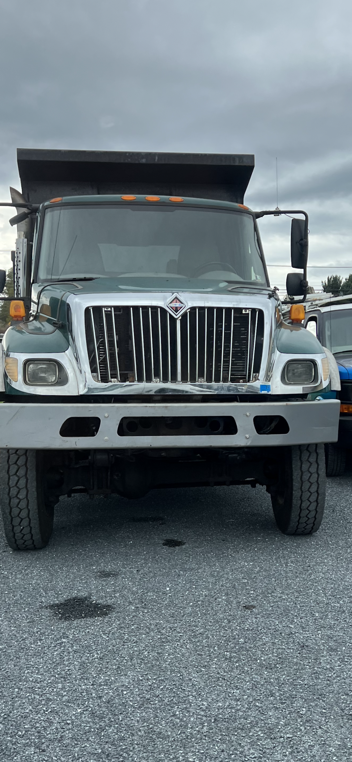

Bad pictures, but here it is as of now. I really need a front grill and 4 new steel wheels.
Ordering tow hooks and mirror mount beacons.
Truck build sheet says 8.25 x 22.5 wheel. Looks like a 9” wheel to me. Maybe it’s the rust patina throwing me off….
Truck is going to look weird with a “no-sale” green cab, faded black dump bed and new white wheels. I think that’s why the previous owner painted wheels black??

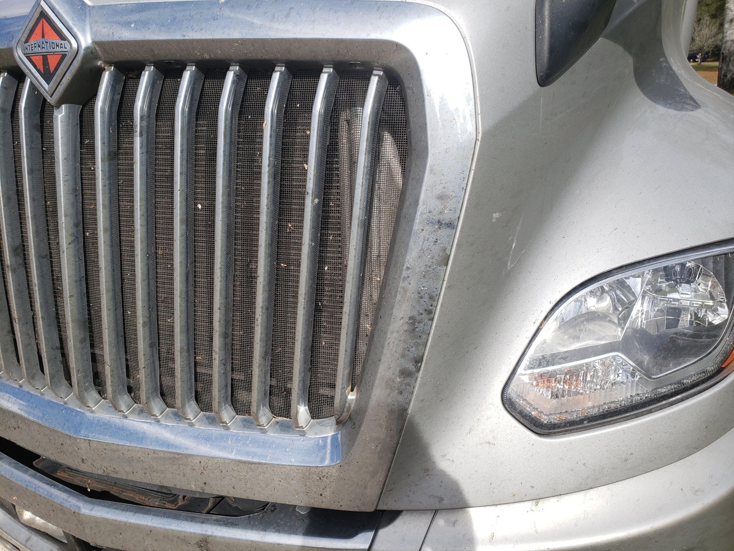

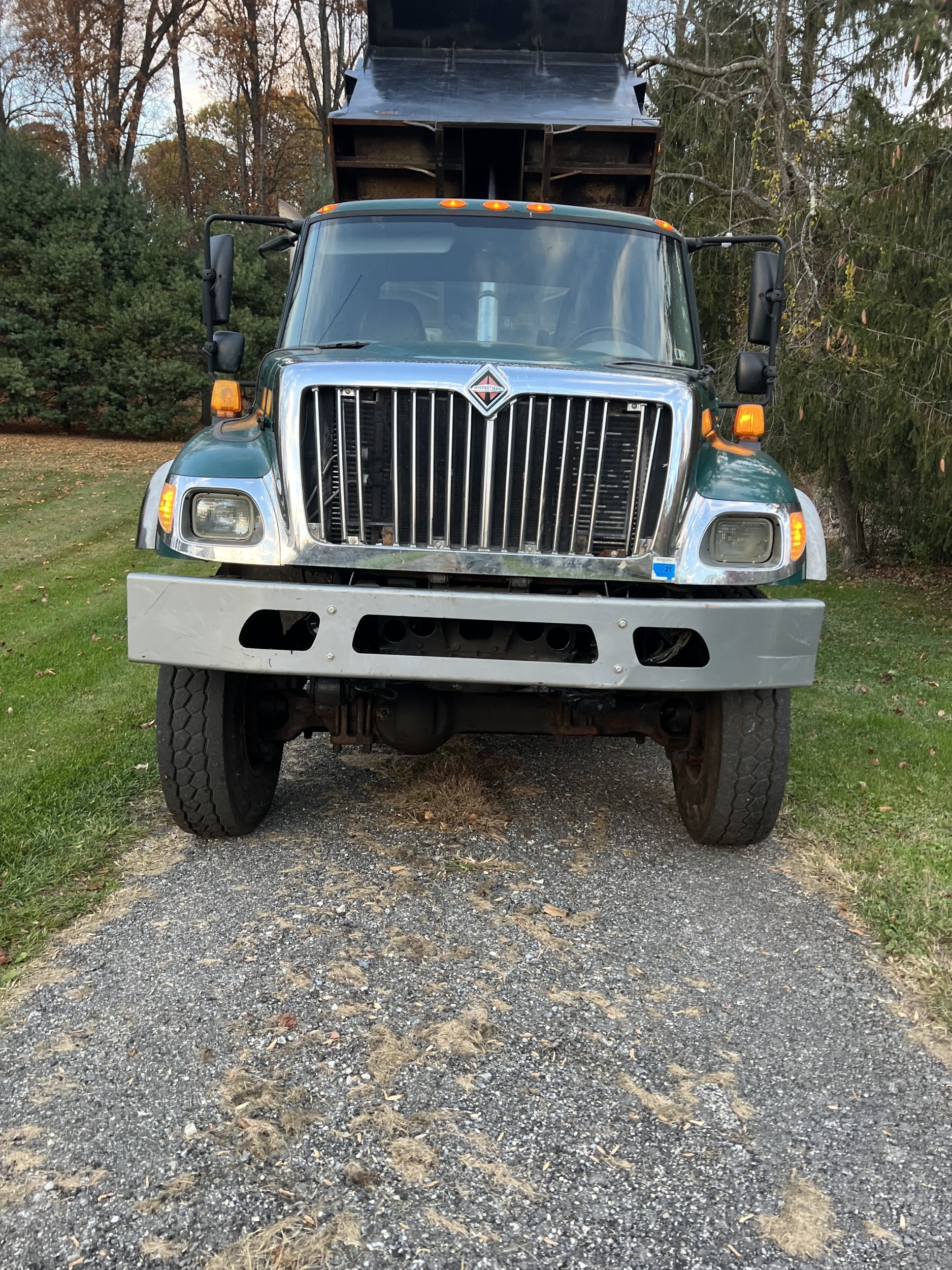

I have a grill for an International that made it thru a wreck by just getting popped off. Put grill in upper sleeper and told the body shop...but they put a new one on.
Could use a better picture of yours to see if they match. The area in question is the lower corners of grill where they meet the headlights.

Never mind, they don't match.

Note scre hole/mounting tab locations. Mines a 7500. There’s a myriad of different grilles. International has such a bad parts system.

I went out and grabbed a picture of the grill on truck and got approached by the wild animals we feed every day. Not much wild about these wild animals!
Wife would love for the grill to have matched, as She isn't much of a collector!
