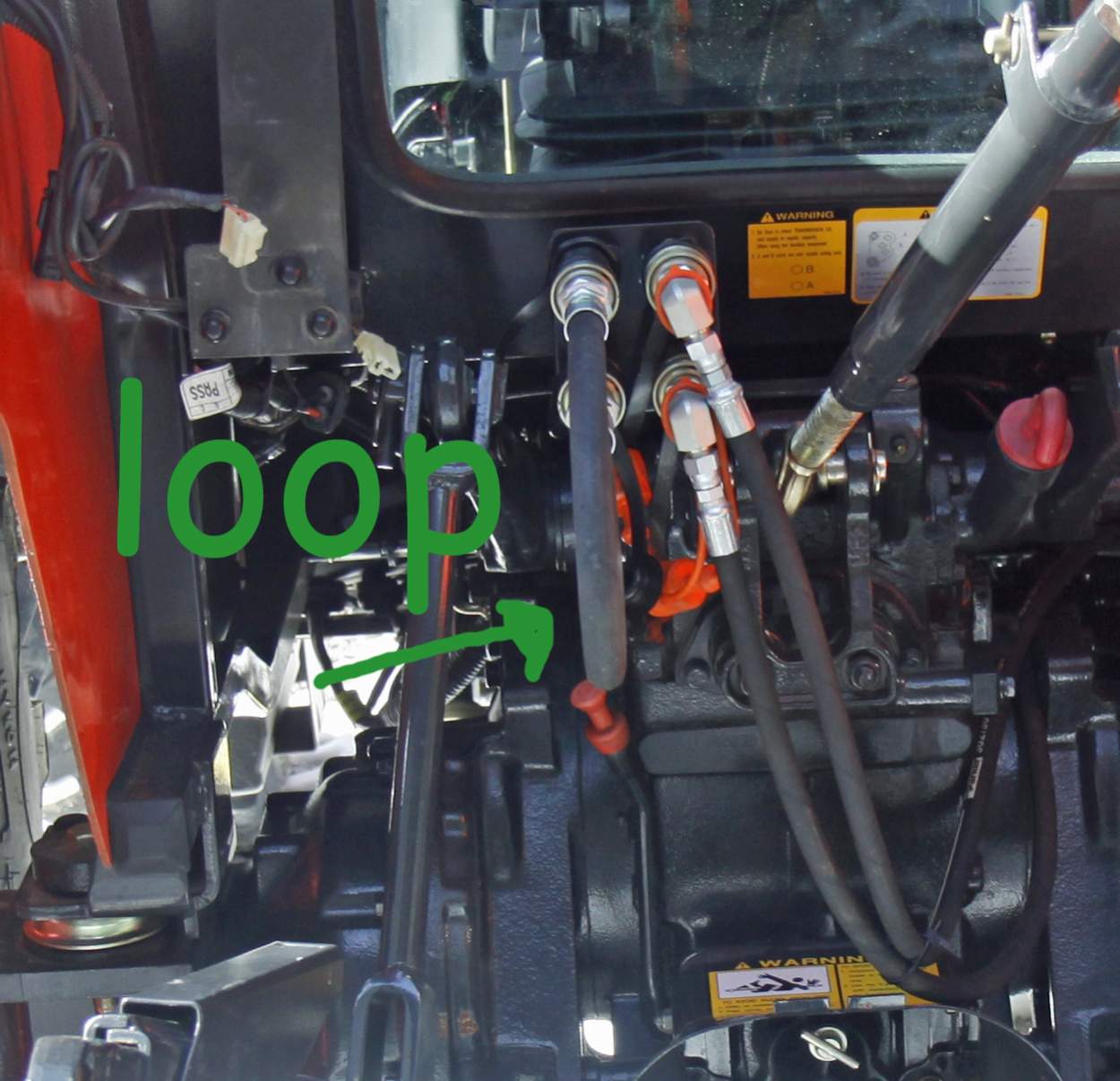

also a quick note. If you have a detent type rear remote (that meaning it locks into place when the handle is moved) you should add a loop of hose with disconnects when no equipment is attaches (see picture). This will protect your hydraulic pump from deadheading if the detent is accidently engaged and no impliment is attached. there have been some damaged hydraulic pumps caused by this...and the warranty wont cover this issue.
Im not sure what you mean by what lever operates the remote valve when you move it into a/b??
On my remote levers (i have 2) one says a/b the other c/d.
the one with the detent is the a/b valve. according to the manual a=up, b=down. but it depends on which way you set your hoses. it could be right/left (i use mine to control front snow blade).

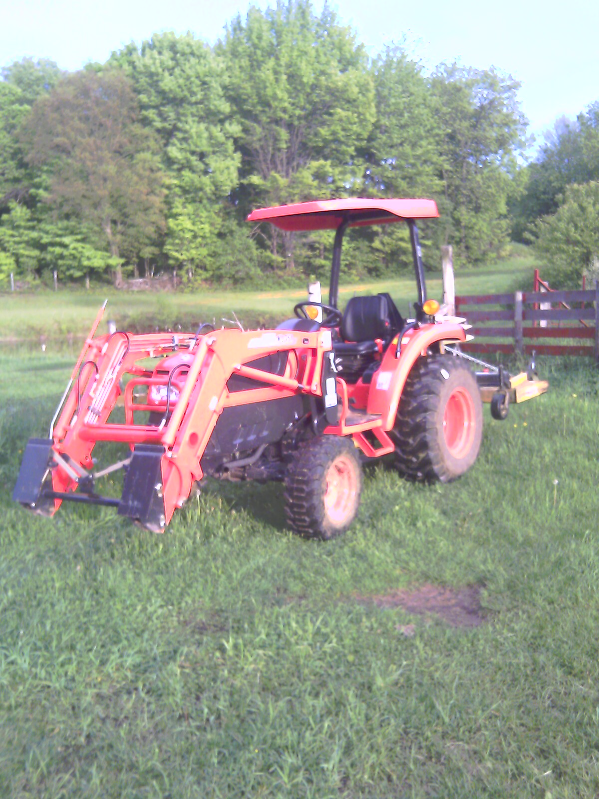

I know i'm probably a slacker on pics but my job is running me hard. I'm delivering 2 trailor loads of building material a day and loading for the next days trip out. Covering almost 300 miles a day but loving every minute to my self in the truck.
Ive had my self about seven new tractors in my day so far and i think the new Kioti is the nicest yet to operate. I really love my Mahindra a lot and its a great tractor but. . .the Kioti really impresses me in hydralic responce and seems to feel like a commercial machine on the loader. just wish i had more time now to break in the seat. Doing some mowing now and its a lot of fun even though all it does is rain! . . .John

Sorry for the long delay in the reply. I bought from Kleis equipment in Constantia New York. About 10 miles south of home. Ive bought from John Kleis before and he did me good. We bought 2 DK35SE HST tractor from him in the past 2 months and we really like the way they operate but need to add high front and back work lights for night work. . .John
Sorry for the poor quality pictures, there from my phone and it makes a poor camera. . .John
