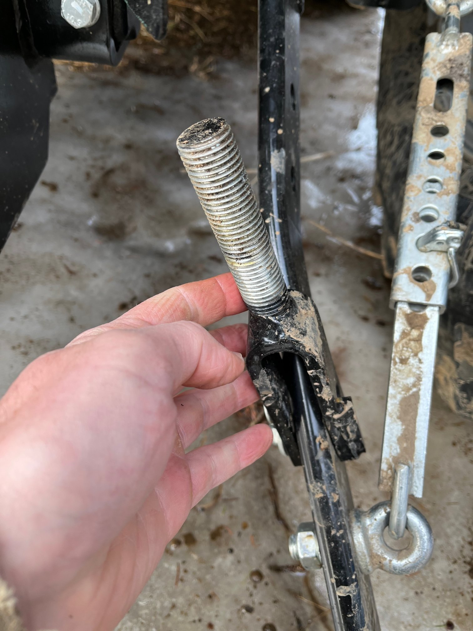

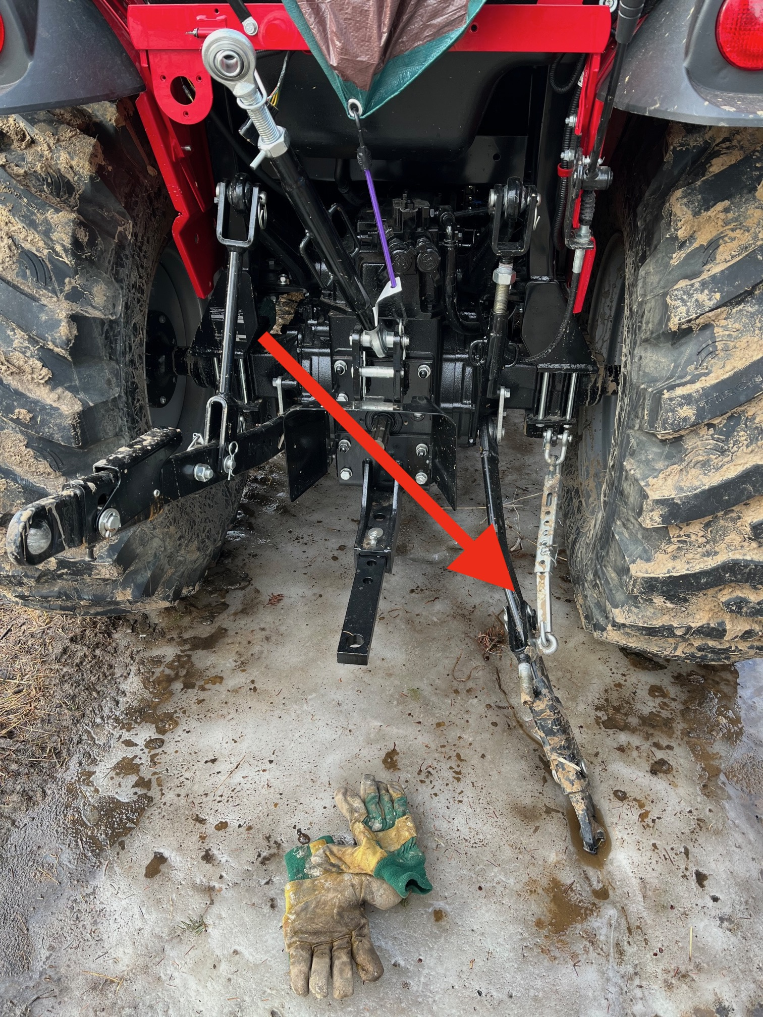

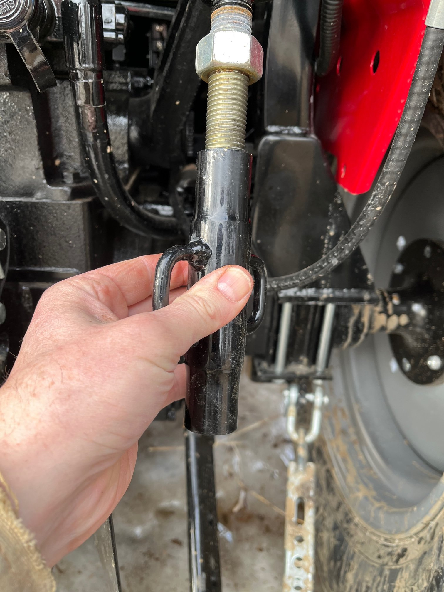

New tractor, with about 10 hours on it (not using the three point hitch). To my dismay when I walked up to it this morning, my 3-point hitch section must have rattled loose. Am I suppose to be checking and tightening this or some other issue?
   / New Tractor: Three Point Hitch Came Apart (see pictures) #3
Someone forgot to tighten the lock nut after leveling? Dealer prep should have caught it, but yes, you should also be looking for loose and missing nuts/bolts/pins. My loader to frame bracket bolts were loose after ~10hrs. Gotta check. Get your wrench set out and go over all the nuts and bolts.

This topic has a combination of dealer prep, and operator check, in this case, they were both missed. Low criticality, but a message none the less. Yes, the dealer should have checked the three point lift arm turnbuckle, and it's a worthwhile operator check too. There are many fasteners which the operator could not be expected see nor check pre-operation. Those are certainly manufacturer and dealer responsibility.
And there are some operator adjustable fasteners, which, yes, the dealer should assure, and the operator should be aware of for operation, as the operator could have adjusted them. For a loose turnbuckle on a brand new tractor, yes, I would think a thought about the dealer, and I would kick myself too. Yes, I would tell the dealer what I'd found, but I'd stop short of waving the ugly stick, it was partly my responsibility too. Later in ownership (at the first 50 hour check, or after first operator adjustment) that nut becomes the operator responsibility.
