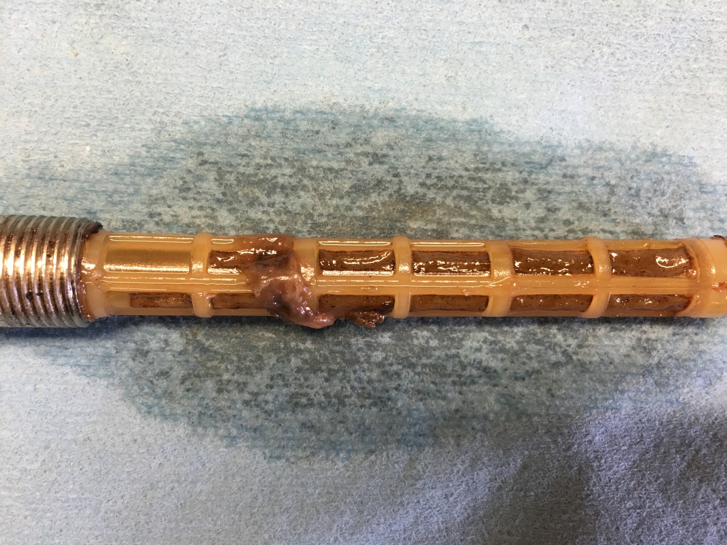

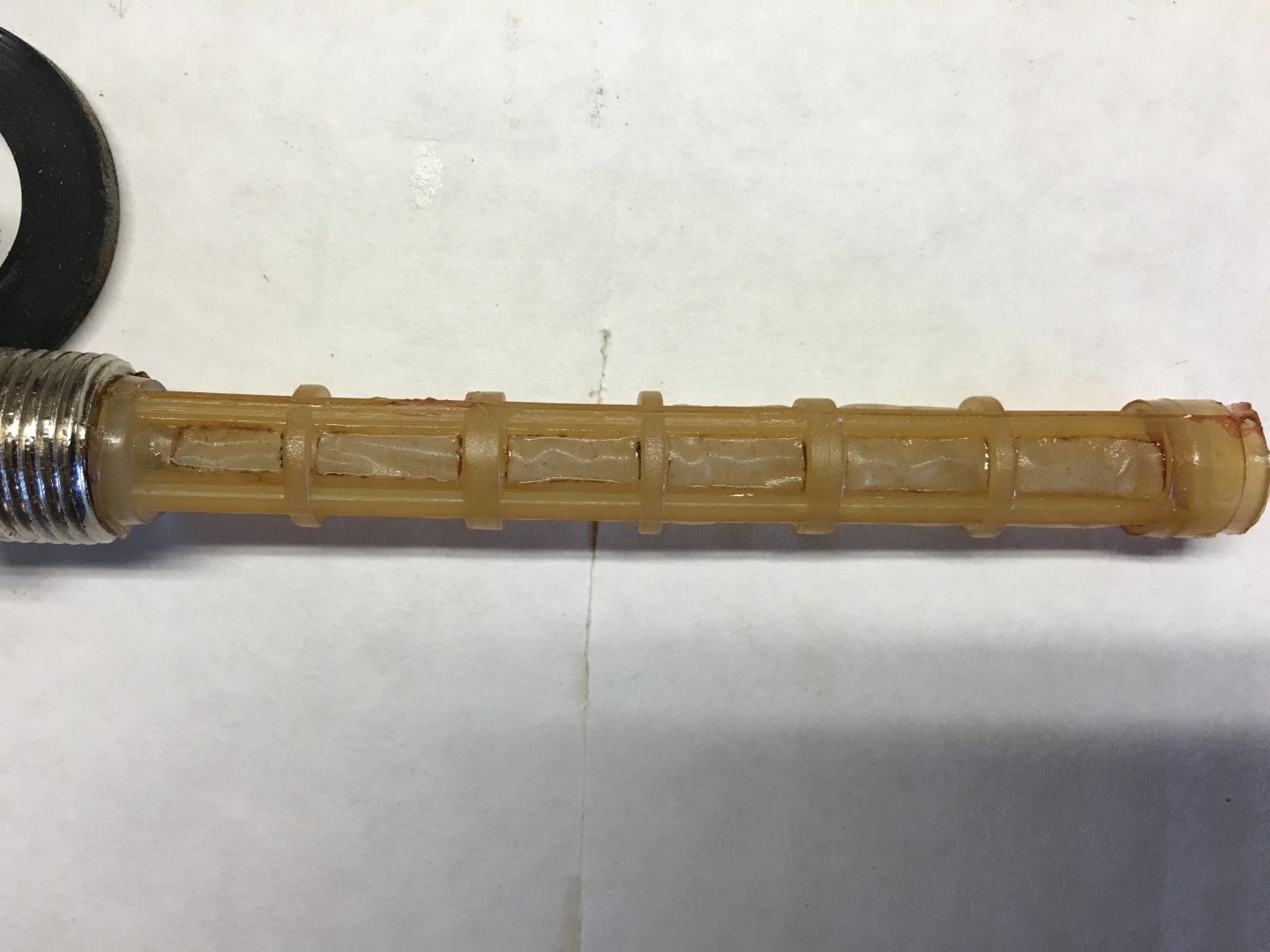

Wanted to post a reply and the solution. The Problem was two fold. Fuel Temperature and Fuel Delivery. Fuel temp was causing red stop light and engine limp mode. Solution to temperature. Tech showed me how you access the fuel cooler. Remove the two 10mm bolts that hold the front cowl and headlights to the radiator supports. Red Circle. Unclip the three electrical connections, slide the cowl up, remove the two side engine panels, remove the battery, blow the son of a gun out. This really cant be done adequately with the shroud in place. This fuel radiator needs to be relocated higher up and an electric fan placed on it so it can be cleaned out regularly and a 20 minute exercise in plastic removal avoided.
Fuel Cooler Location (Conveniently Behind the Battery)
Solution to clogged intake. The tech told me to remove the fuel line where it enters the water separator bowl and blow low pressure air back through the line toward the tank to clear the screen. This works....temporarily. There is still trash in the tank and it needs to be removed.(Why didn't the guys at the shop remove it? They claimed they did, then it clogged 3 weeks later, I have ONLY filled it with an inline filter since the service) I am working on a solution for this as we speak. I purchased a transfer pump and put a goldenrod filter system in in front of the fill handle to prevent future contamination. My plan is to install a drain plug that is threaded so I can plumb it to a holding tank and do a re-circulation cleaning and using the transfer pump to stir up and debris in the bottom of the tank and wash it out. I figure this is better than removing the tank for a thorough cleaning as I can perform this re circulation numerous times over the life of the tractor without having a bunch of down time as this experience has taught me that it may be impossible to keep these tanks clean as the tolerance for foreign material in the tank as well as the injectors is much lower than anything I have ever experienced. I would assume any kind of gelling of bacterial growth will do me in as well. Might as well have a solution ready to go when that issue presents itself.
Moral of the Story: You cannot be to careful when fueling these things.

Update: I filled the tank 1/2 way with my new transfer pump and filter, ran the transfer pump for about 15 minutes using the stream from the transfer output to agitate around the intake of the tank fuel line to the engine. I had a similar stall out happen about a month later when the tank got low. I blew out the line from the engine side back into the tank, put in 5 gallons of diesel and repeated the transfer pump with filter procedure again. No problems since, even when running the tank down to about a gallon. I had trash in my tank, to small for me to see in the filter, but trash just the same. I will never fuel another diesel engine without a filter. Lesson Learned. Problem Solved. Buy a transfer pump, but the best filter you can afford on it.

My 2015 5065E had a strainer attached to fuel hose fitting at tank, mine was stopped up with gel from "bio diesel", had same symptoms you described. I cleaned it twice then did away with it & replaced with inline filter I could see.Strainer After (Large).JPGStrainer Before 1 (Large).JPG
