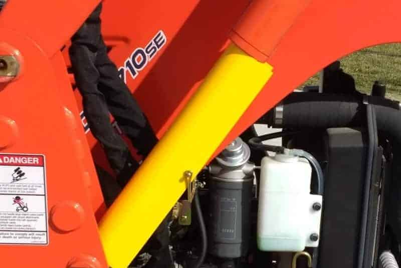

Put it in float and jack the loader up high enough to load on the trailer. Then cut a piece of angle iron the length to support the cylinder so it will stay when you lower the jack.
Something like this.
