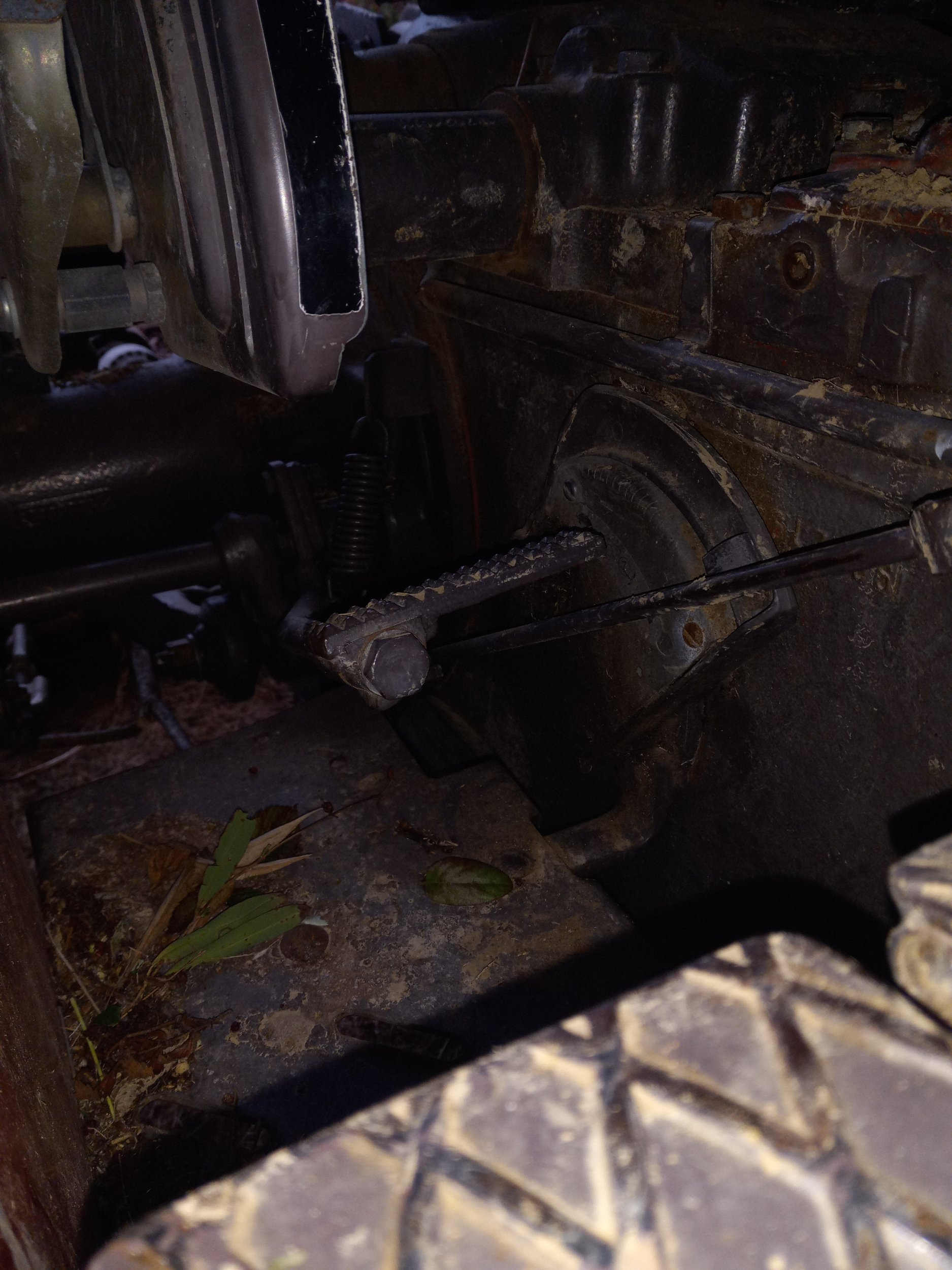

/ New tractor owner- MF231
I'm in SE Ohio.
I pulled the lever up as far as I could into the position shown but I still feel like it's not opened up.

Back to the steering issue -- your photo looks like you got the pedal all the way up. I would still stomp it and lube it to get it as free as possible and still try the things I mentioned in post #4 to see if you can get the rear axle unlocked... if it IS locked. That needs confirmed before going too far.

As far as the pedal goes I've been spraying it down and have 3-4" of movement in it but the problem persist.

I soaked it overnight in PB Blaster and when I cut a couple hours this evening it had freed up and was working as it should. I appreciate the help from everyone. I'll keep putting the PB Blaster on it nightly to keep the parts from seizing again.

Great to hear that it finally came unlocked! At least now you can go ahead and do what you need to do. Comment on the use of PT Blaster -- it is mainly formulated for what the old timer's called "penetrating oil" to loosen stuck metal parts. While great for that, I wouldn't really recommend it for longer term lubrication. After getting things thoroughly loosened I'd go to some higher viscosity lube to keep it from seizing in the future. I can't quite picture how much space you have to get lube back in there but some aerosol can of lube (maybe with a spray straw tube on it similar to what you see on WD-40 cans) ought to work. There are several lubricating oils that come in aerosol spray cans. Browse around in their "claims to fame" and you'll probably find a good match -- anyway better than long-term use of PT Blaster. Blaster themselves make inexpensive spray cans of white lithium grease for example.
