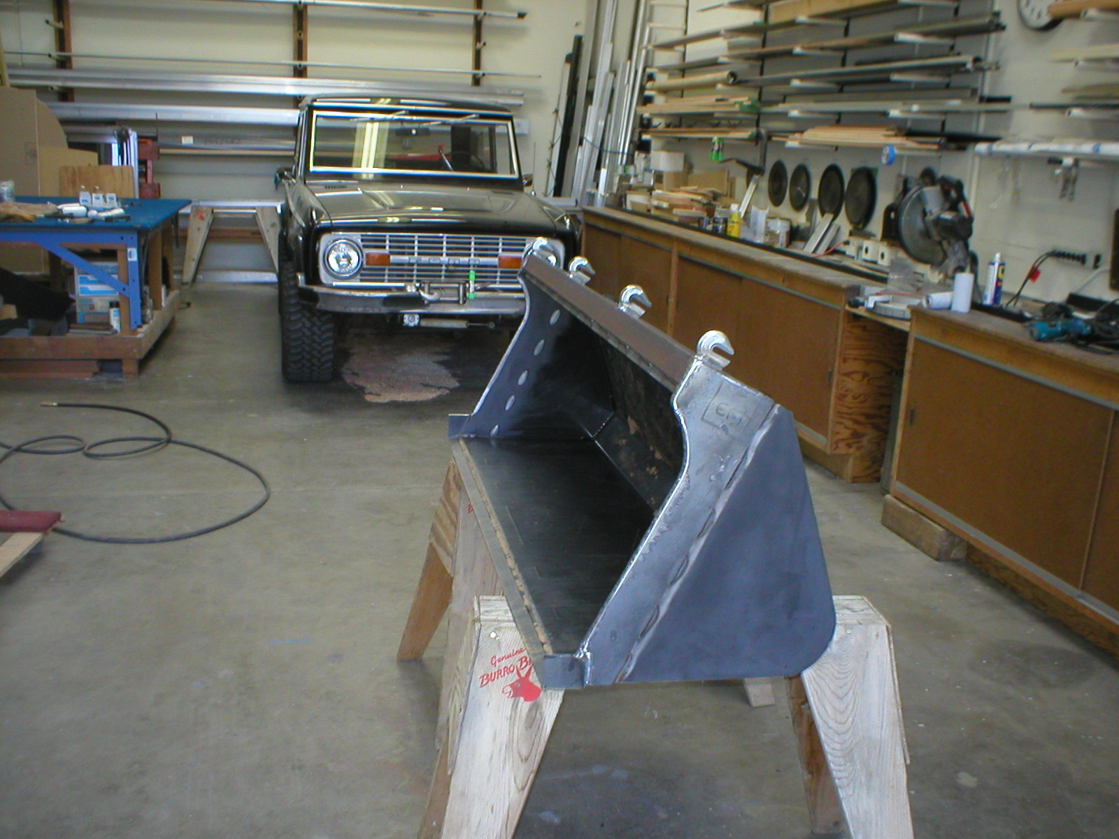

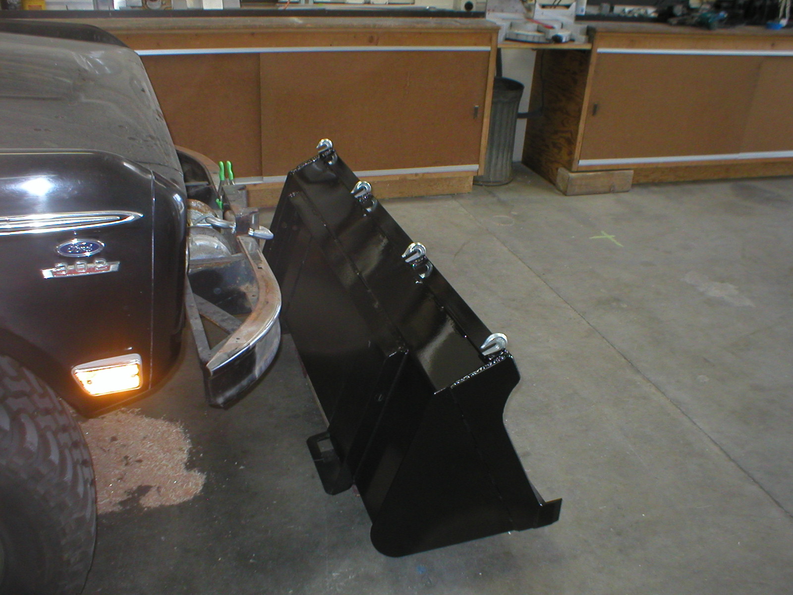

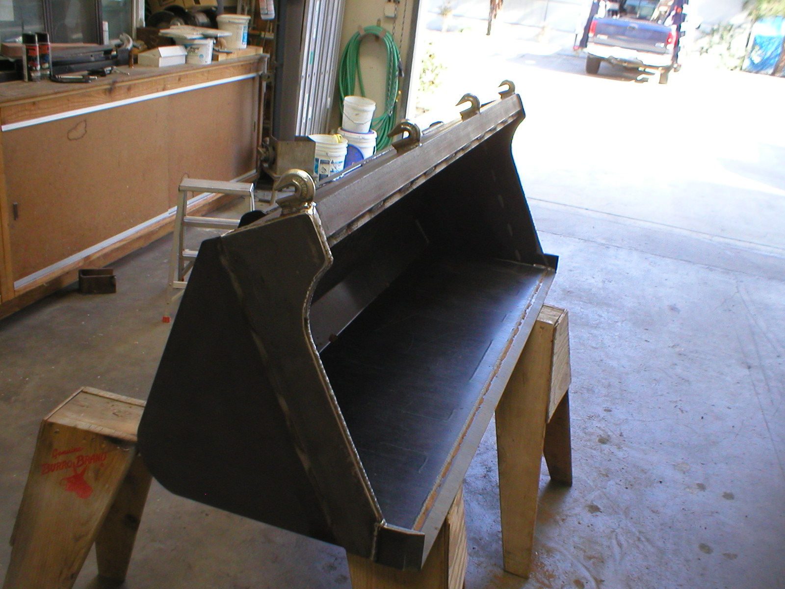

It's a good idea to beef up the std bucket, especially if you are going to put some hooks on. The metal is just to thin to take much stress. I put 2x2x3/8 angle on the top along with some 3/8" plate on the sides of my 3215 loader bucket. Here is a link to some of the improvements that I did to my 3215HST.
Good luck with the new tractor, they are a very good machine.

Give it a little more lip and you could use it on the 7520. :D

I'll pass, but one of these days I need to get some posed pics using the 78" digging bucket on the 3215. :laughing:
