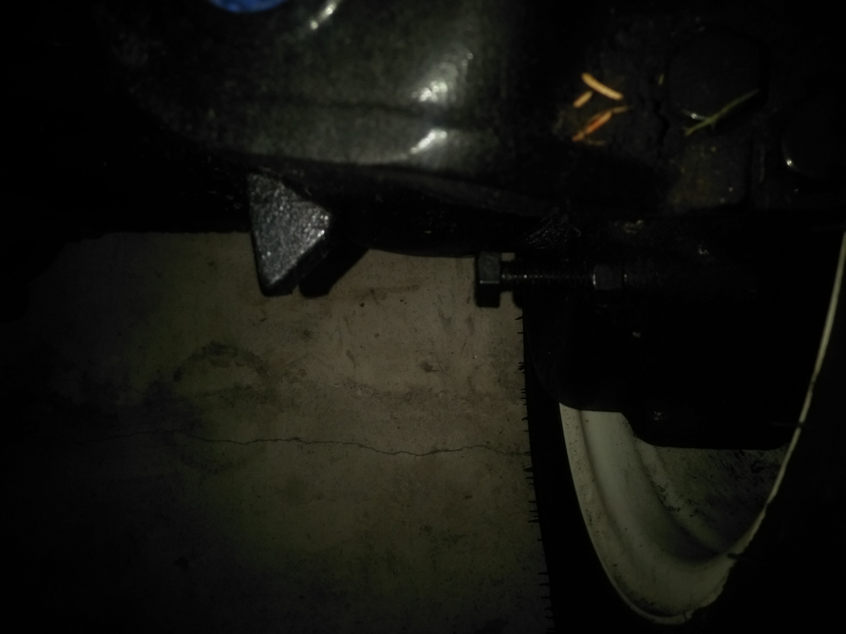

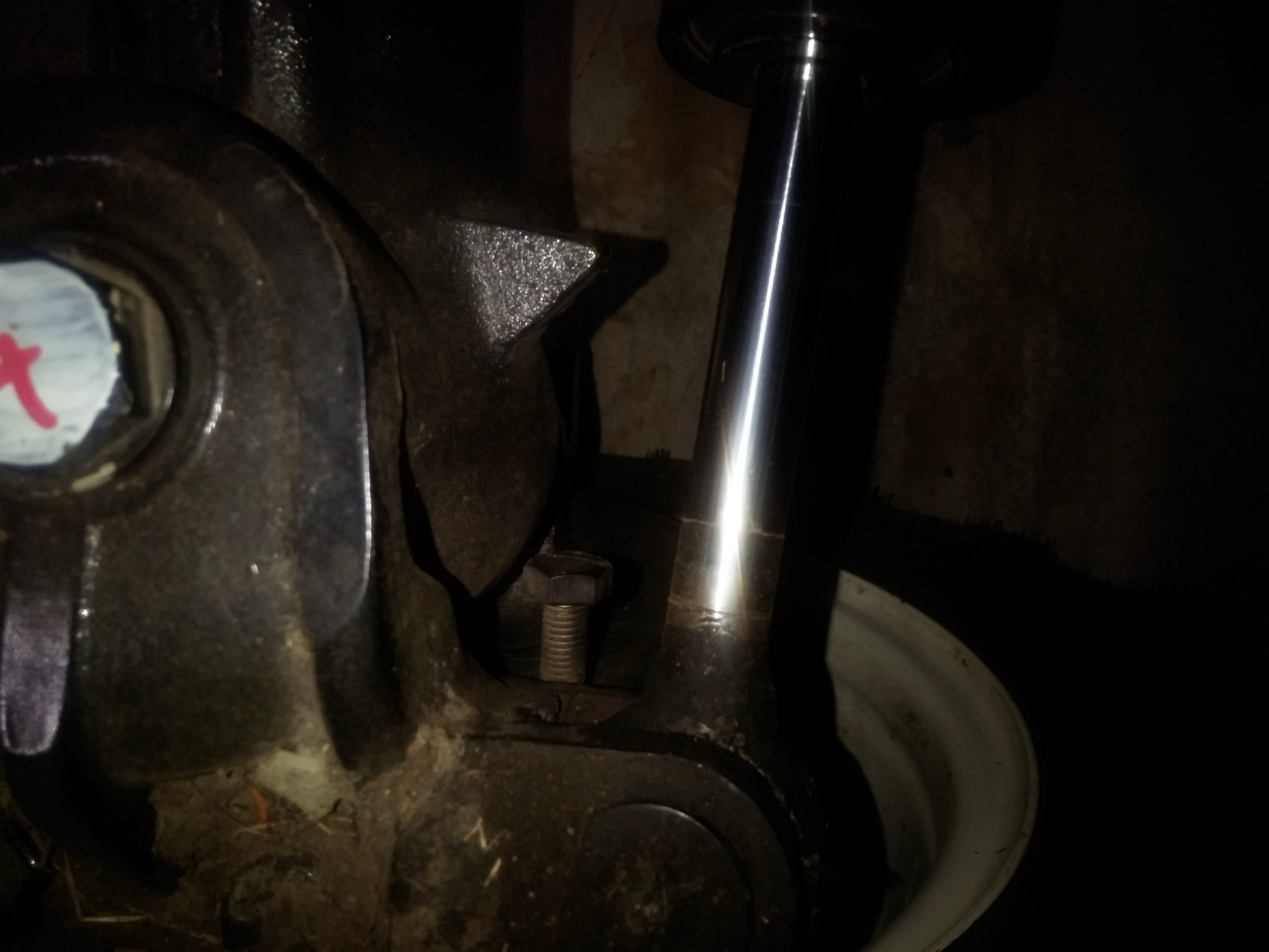

Here they are on my 3135: IMG_20180820_115305.jpg see the threaded bolt and the stop. Left side:IMG_20180820_115305.jpg
   / New Tractor / New Videos! #16
Whoops! Here is the left side, looking straight down:IMG_20180820_115029.jpg

I think I did find it in the shop manual. It is not under the front axle section, but rather the hydrolic section. Go figure.
And, there is not much about it. Just a mention to make sure you measure it before removing it.

Just posted an update video. This time, I explore the steering angle using a hastily put together steering angle finder I learned from ChrisFix. That did not work. However, I did find the steering bolts and now I am left with more questions. I am wondering how far out and can move those bolts and, even then, would it still get bound up? I am probably going to move them out and test it, but, should I be contacting my dealer? How far out are your steering stop bolts? Could something else be going on?
   / New Tractor / New Videos! #20
My steering angle bolts have a little over an inch of thread showing. Something I read stated that to properly adjust those bolts, you are to raise the front of the tractor with a sling so that the front axle hangs so that it can be articulated through its entire range of motion to check for rubbing or binding.
