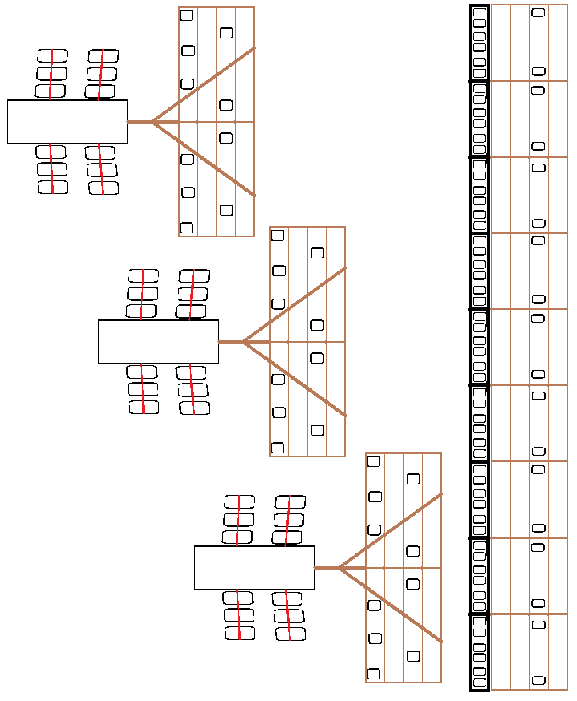

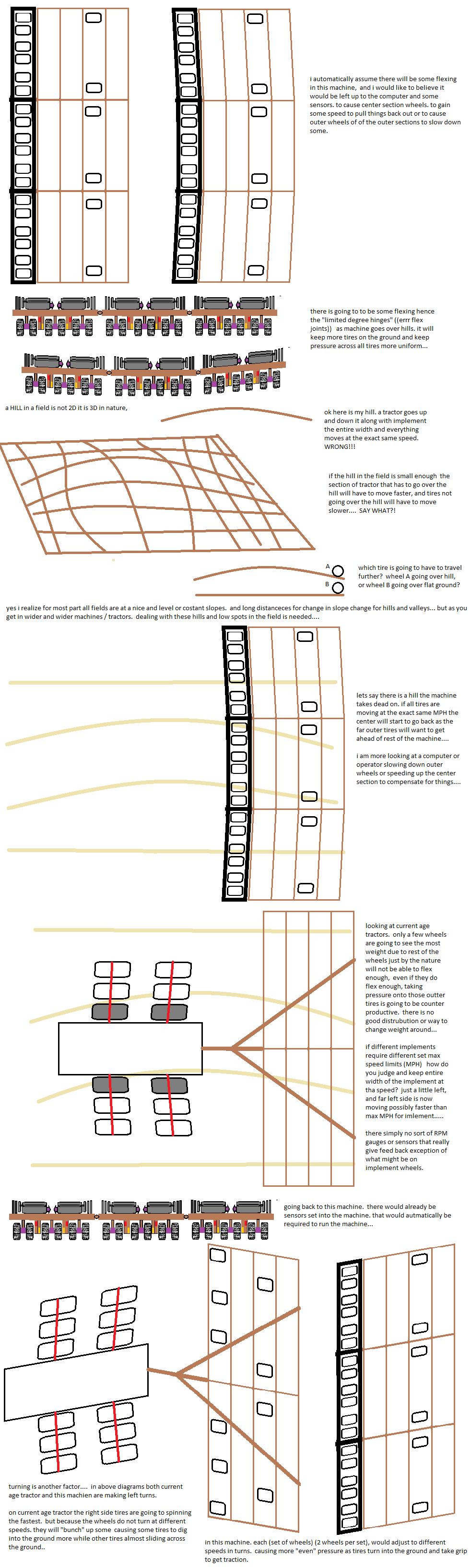

ggrrr seems to be problem with "quick reply" -> "attach image" button images are loading if i goto "go advance" -> "manage attachments" -> "drag and drop" and insert images in line....
will toss all the images i have in this post... 60 plus *cringes*
boggen new tractor idea4.png .. boggen new tractor idea2.png .. boggen new tractor idea1.png .. boggen new tractor idea3.png .. boggen new tractor idea6.png .. boggen new tractor idea5.png .. boggen new tractor idea25.png .. boggen new tractor idea23.png .. boggen new tractor idea24.png .. 4630_sprayer_523854.jpg .. boggen new tractor idea22.png .. boggen new tractor idea21.png .. boggen new tractor idea20.png .. boggen new tractor idea19.png .. boggen new tractor idea18.png .. boggen new tractor idea17.png .. boggen new tractor idea16.png .. boggen new tractor idea15.png .. boggen new tractor idea14.png .. boggen new tractor idea12.png .. boggen new tractor idea13.png .. boggen new tractor idea11.png .. boggen new tractor idea10.png .. boggen new tractor idea9.png .. boggen new tractor idea8.png .. boggen new tractor idea7.png .. boggen new tractor idea45.png .. boggen new tractor idea44.png .. boggen new tractor idea43.png .. boggen new tractor idea42.png .. boggen new tractor idea41.png .. boggen new tractor idea40.png .. boggen new tractor idea39.png .. boggen new tractor idea38.png .. boggen new tractor idea37.png .. boggen new tractor idea36.png .. boggen new tractor idea35.png .. boggen new tractor idea34.png .. boggen new tractor idea33.png .. boggen new tractor idea32.png .. boggen new tractor idea31.png .. boggen new tractor idea30.png .. boggen new tractor idea29.png .. boggen new tractor idea28.png .. boggen new tractor idea27.png .. boggen new tractor idea26.png .. boggen new tractor idea66.png .. boggen new tractor idea65.png .. boggen new tractor idea63.png .. boggen new tractor idea62.png .. boggen new tractor idea61.png .. boggen new tractor idea60.png .. boggen new tractor idea59.png .. boggen new tractor idea58.png .. boggen new tractor idea57.png .. boggen new tractor idea56.png .. boggen new tractor idea55.png .. boggen new tractor idea54.png .. boggen new tractor idea53.png .. boggen new tractor idea52.png .. boggen new tractor idea51.png .. boggen new tractor idea50.png .. boggen new tractor idea49.png .. boggen new tractor idea48.png .. boggen new tractor idea47.png .. boggen new tractor idea46.png

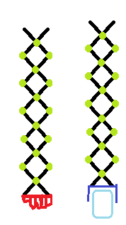

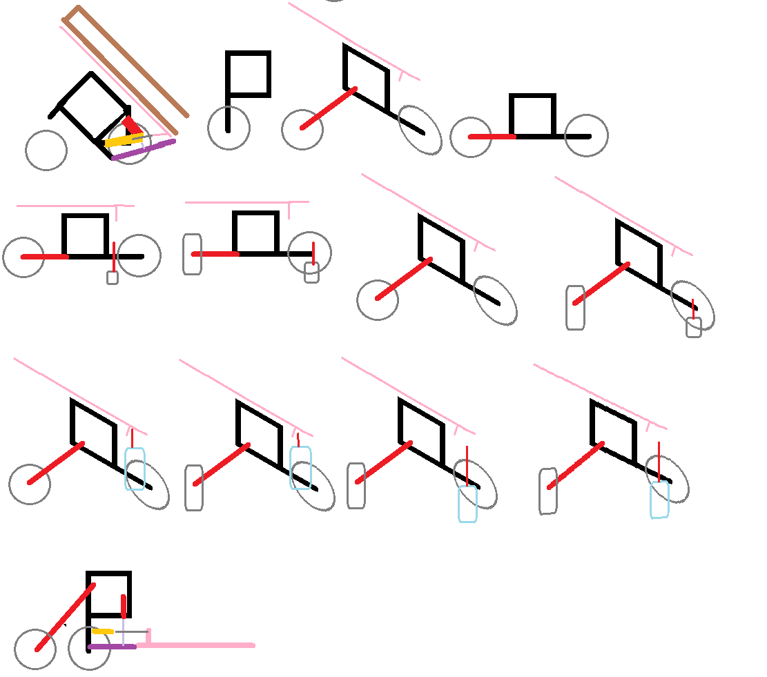

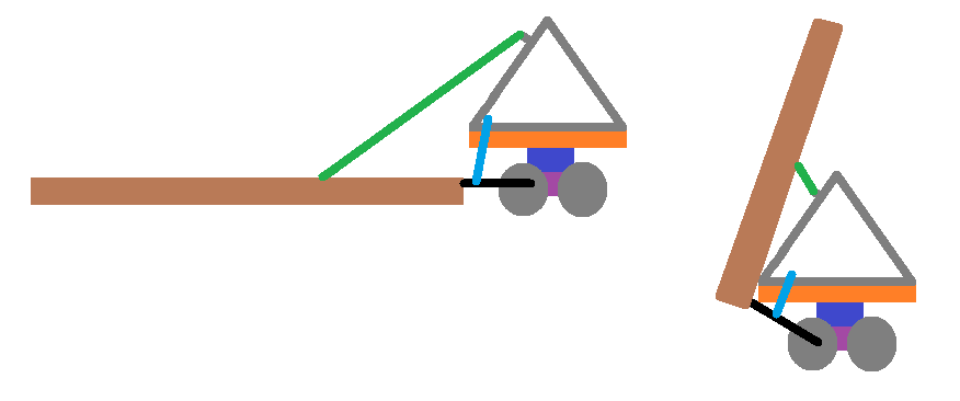

In the last idea on this one:
Why not mount the cylinder to the triangular engine protection frame rather than having the long straight vertical piece?
Green and turquoiseish-blueish are cylinders and black is an arm that is hinged at both ends:
Aaron Z

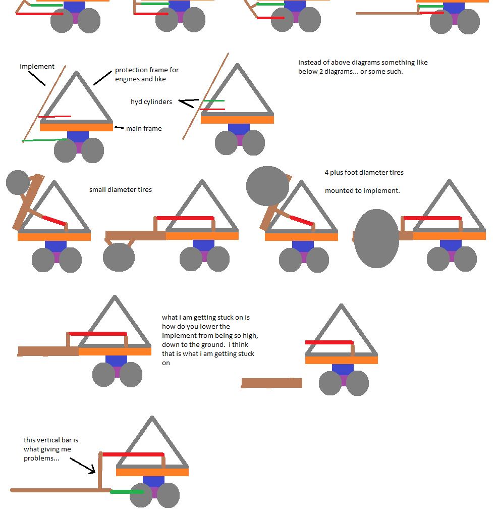

so a telescopic hyd cylinder that had multi stages. kinda like a dump truck, were cylinder was attached to truck and dump bed right near cab. vs positioning cylinder closer to rear of truck for both connections to make a shorter hyd cylinder that was larger in diameter.
i like it! but forces on the long cylinder. and the multi stages. (worries me some)
if i could get say 2 to 4 feet vertical distance between lower link and upper link, i think i might be happier. due to it changes the weight balance around and pivot points. and perhaps allow for a smaller size frame for the STB tractor. though at this point i am only purely guessing.
how i figure i got current links ((forget everything in this old diagram)) exception bottom right corner diagram showing hyd links.
there is only a few inches in difference were the links physically connect to the implement. and that is going to cause a huge amount of "bind"
if those connections points on implement get further spread out. i would think there would be a better "fine tune adjusting" of lowering the implement. and how high you want front or back of implement off the ground. along with reducing a good portion of "binding".
heck "float the implement" off the ground. or perhaps "hovering" across the ground.

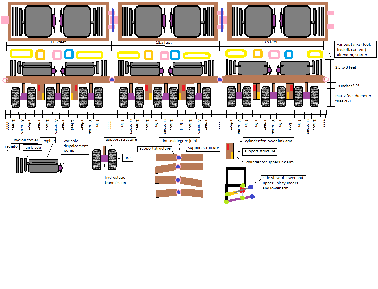

RECAP 3
post# 81 = all diagrams from the previous 80 posts.
been jumping all around on different ideas/subjects.
for most part shortened overall width of machine, and redid how the links (3pt hitch like links) connect to the STB (side train box) tractor.
i suppose i should start saying 2point quick hitch connections.
the quick hitch locking mechanism and implement ends for quick hitch. are still up in the air. of exactly what they may look like. and more of a concept thought. and no actual design to them as of yet.
went through 360 joint. but not really drawn out fully and attempted to fit into the small space for the motor that spins the 360 joint. see posts 90 to 94 for more info on 360 joint. more specifically the special fitting to get between rotating wires... not real sure about the actually how the 360 joint will go together. i kinda went into it, and then left it as is... without redrawing and rechecking..., re thinking about it.
redid cylinder to cylinders for moving wheels back and forth under the machine. though not much detail on them yet.
started to get into various implements but early doings on them... and more currently mind set of looking at various implements and ways that might work for various implements but more chicken scratch drawings. to get a broad over view of how things might work and attach.
still undecided / unsure what would be the primary source for this machine, drive shafts and gearing, electricity, or hyd oil. just really not there yet....
i want to go take another looking at the wheels and the "dead man circle" and look at "tracks" and perhaps transport wheel combination. and possibly loosing the 360 joint and redistributing weight cylinders. that i doubt loosing them will happen. also want to look at a 2 long tracks, and then 2 shorter tracks, (1 long, 1 short) per side of transmission/motors
or going with 4 or 8 short tracts were tracts act like caster wheels, and loosing the primary 360 joint and redistributing weight cylinders (possibility).
along with possible some sort of "suspension" or rather something that might allow the wheels or tracks in this case to slightly lean side to side backwards and forwards just a couple inches. just enough so as to keep all tires or tracks firmly on the ground across the entire width of the tire or track.
at moment kinda thinking if i went with tracks for (field mode) and then a tire on each side for (transport mode). i might be able to reduce the dead man circle. by another couple inches or a couple feet perhaps...
