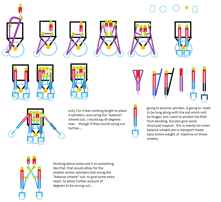

#63
adjustments to short end top links to have 2 on each end.
fill like a kid in a candy store, and told to get as much as you want and what ever you want....
been thinking hydraulics. and more so hydraulics ran in shops, and factories. i thought about making "loops" that go all the way around machine. this could possibly allow for "smaller diameter" piping, and help balance pressure / GPM of hyd oil through out the system.
figure the pipes could be placed one on top of one other. with some "pipe holders" holding the pipes to some stand offs. i am going to assume some implements / STB setups going to require power beyond, and various valving setups. so there would need to be a way. to easily TEE into these main hyd lines. and come off of them for the valves and like. perhaps the supports that come up from the frame. turn these supports into actual TEE's themselves. and just place a end cap into the TEE. and let customer choose what they want as far as what they want for valving and were they want the valves.
example i would assume someone might want "power beyond" type of setup. to connect 2 or more 20x8 feet sections together. and just having a single engine out of the 2 sections running everything.
some may want some sort of electronic valve (proportional valve), with a "manual override" for attaching / UN-attaching implements.
some may not need / want short end hydraulic links.
i could almost see someone might wanting a pipe that loops around an entire section, and have a hyd accumulator on that line.
i would assume what ever way the engines were pointed more specifically the variable displacement pumps were nearest to. that the hyd to the "transmission/s" would be tee'ed off and sent down. (closer the better)
the entire machine would look like a triangle on wheels. if it had implements on both 20feet sides that were folded up. but how many degrees do these implements fold back into the center of the machine? "clearance"
with links being below the main frame. i would imagine 45 degree would be MAX, but what about 67.5 degree angle. i do not know about that 67.5 angle. would still most likely place most of the weight of implement in transport mode onto the links. vs allowing the implement to rest on top of the STB.
stating links are below main frame. someone may want for what ever reason. move a link or links to above the main frame. it would be nice to see say 8" maybe 10" inches all the way around the top of the frame. just to "mount" something.

#65
had to see for myself if an extra side link and end links were removed. what it would give and would there be any major major! advantage
2 20 feet sections = 40 feet
2 sections created into a single section = 35
2 sections created into a single section = 33
not sure about the 33 one. with 3 sets of links. i am not sure how an implement would be "divided up" so it would "flow / roll" with the land better (over high / low spots)
7 feet is a lot! when considering how much weight 7 feet of frames, hyd cylinders, engines, hyd oil, etc.. could fill up. but when spread over 16 wheels.... perhaps more wheels if a "tire implement" gets added....
i guess i really can not do much about anything for above. the STB would need to get made into some computer 3D program. with everything down to the niddy griddy. and hopefully the program would state how heavy everything would end up being. to get ground pressure at the tires... and see if something would really need to be done for compaction or not and spreading the weight out....

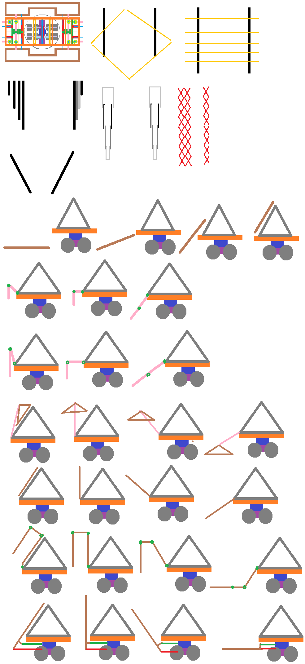

#69
been looking at various implements out there... and trying to decided if there might be a better way to fold/un-fold implements along with on the fly adjustments to implements.
i am looking at these massive frames for 30 plus feet wide implements. but then i see these small size frames that are actually holding the disc, chisel, shank, ripper, plow, cutler, what ever it may be for tillage.
i would imagine there is a certain "distance" between various things (both side to side and how far something travels behind another thing). along with distance between things that might be a combination of MPH, soil properties, depth implement goes into the ground. overall weight on implement, how well implement stays at a certain distance off the ground how much "width" or perhaps i should say "drag" on what ever is in the ground...
random attempts to see if main frames for implements, bend, telescope, angle back and forth
random attempts to try and picture how various implements might fold/un-fold...
the last row of diagrams in above. has been what i been thinking about. but dealing with "seeders" and like that have a boxes of seeds. how do you keep from "dumping" all the see right on top of the machine as the implement folds up all the way...
i have also been thinking about the "main drive wheels" i can almost see this STB (side train box) tractor tipping over onto its rear end. with that thought about some sort of "hinge" or perhaps 4 hyd cylinders (6" max) that tilts the entire deck a couple inches in forward to backward directions when in field mode.
thinking this might help with weight distribution, if implement wheels were added for field mode. or perhaps simply adjusting depth of implement attached to the STB (side train box) tractor.

#72
was thinking of some sort of telescoping aproach to implements. or some how get the various rows of discs, shanks, etc... to slide up next to the STB (side train box) tractor before the implement was actually folded up onto the machine. ((going back to tetter totter)) and if weight could be brought more near the fulcrum. it might be easier to flip / fold the implement up onto the machine for transport mode.
then when going to field mode and unfolding. once implement was lowered from transport mode. it would then push or slide or fold out to wanted space/distance for each rows of discs, shanks, etc...
been thinking of "flat bed" tow trucks. were the rear bed tilts, and extends back behind truck. then car/truck is attached to winch. and pulled up onto the bed. then bed tilts and retracts back onto the rear of the truck... but instead of being a "wide" flat bed. perhaps some "ramps" ((multi ramps were placed were ever needed for a given implement and then locked / pinned into place)) was thinking multi ramps to reduce weight.
with above said, perhaps making sure main frame. can be used to slide stuff up and down the frame, like ramps. or easily able to clamp/pin something onto main frame of the STB (side train box) tractor.
thought about some sort of "long tongue/hitch" like current age tractor implements. but folding back into a trailer mode...
example 60 feet STB with 60 feet implements. and then folding back so STB becomes kinda like current age tractor, and implement folds back to current age implement
honestly do not like this over all idea.
thought about implement being wide enough and heavy enough. were STB pulls into field with implement in tow behind it. and then STB un-hooks, and drives backward, to attach implement to the long width of the STB. i could this happening for some things possibly.... but life of me not sure what would require such a thing, if implement was "built" just for the STB.... and not some modification from some old implement modified for the STB.
i thought about forks lifts on steroids...(like 3pt hitch fork or forks that fit on a FEL) or rather a single fork connected to each set of lower links. and the STB (side train box) tractor. would attach to implements by putting the forks into ends of implement frame. then folding the forks up so implement would slide back onto the forks. then putting a pin in. so implement would not slide off of the forks.
instead of fork lifts. perhaps a "tool bar" or rather a generic frame... that could be turned into various implements, but attaching / un attaching discs, shanks, etc... in various rows across it....
i am still caught up on a "12v DC winch" or a couple of them. and possibly using them to help fold/unfold implements. but what has me is needing some sort of long pole with a hook or like. that could reach over implements and snag the cable and bring it out to edge of an implement to be attached.
another thing that is still bugging me. is the lower links, and being able attach/unattach multi implements. without having to climp,crawl, fall on your face, hit knees, tear up hands and arms as you get across an implement so you can mess around with the links to get them attached to an implement.
with 3pt hitches and the various categories of 3pt hitches.... there normally is always some sort of room to walk between current age tractor and implement. and get things aligned, to get implements hooked up to the tractor. but with the STB, there is no easy way to walk between STB and implement....or i should say multi implements and multi sections of the STB...
if lower links on the STB had 3pt hitch lower arms like a regular tractor has. were arms can move side to side some. how would this action be achieved? and be controlled from a distance? would a there need to be a 2 more baby size hyd cylinders, one for upper link and one for lower link. to move them from side to side. and then use some (remote control, kids toy air plane / remote control car) type of remote. to adjust the links?
would there be a 2 to 3 feet wide. plank around edge of STB. were a person could walk, and some how use a pry bar or something to move the links back and forth to get them algined with pin holes on the implement?
for the wide width side of the STB. would there be some rods that extend from the upper and lower links. over to a corner/s were links could be moved side to side by moving the rods?

how would you fold/unfold an implement up onto the top of the STB (side train box) tractor if one or both links were above the frame? vs being below the frame.
Not seeing your pictures of a 'STB' so I couldn't say.
Aaron Z
did not draw any pictures for that post, brain freeze. not able to even visualize it in my mind. let alone draw something.
hhmmsss this set of diagrams might work... but just not connecting dots. of how an implement could fold/unfold.
