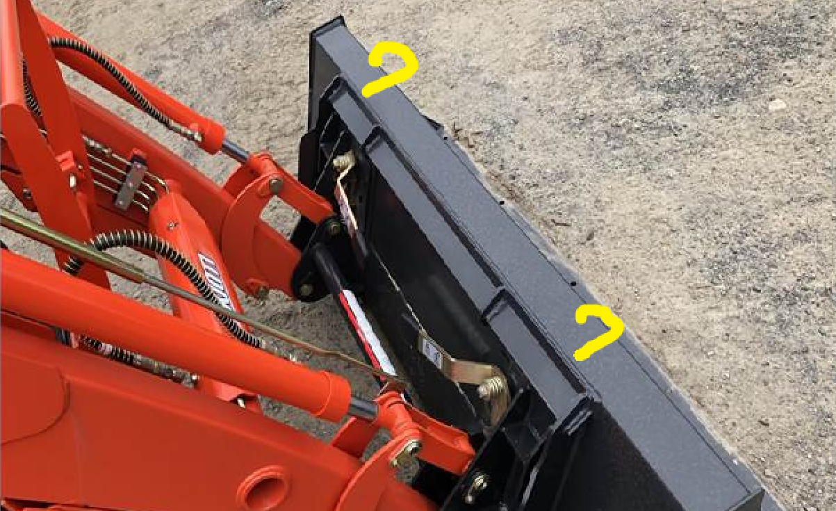

If you mount the bucket hooks near the reinforcements as shown and use backing plates, you should have no problems. Also buy yourself a good quality chain.

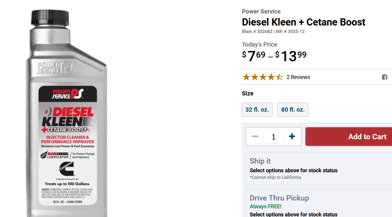

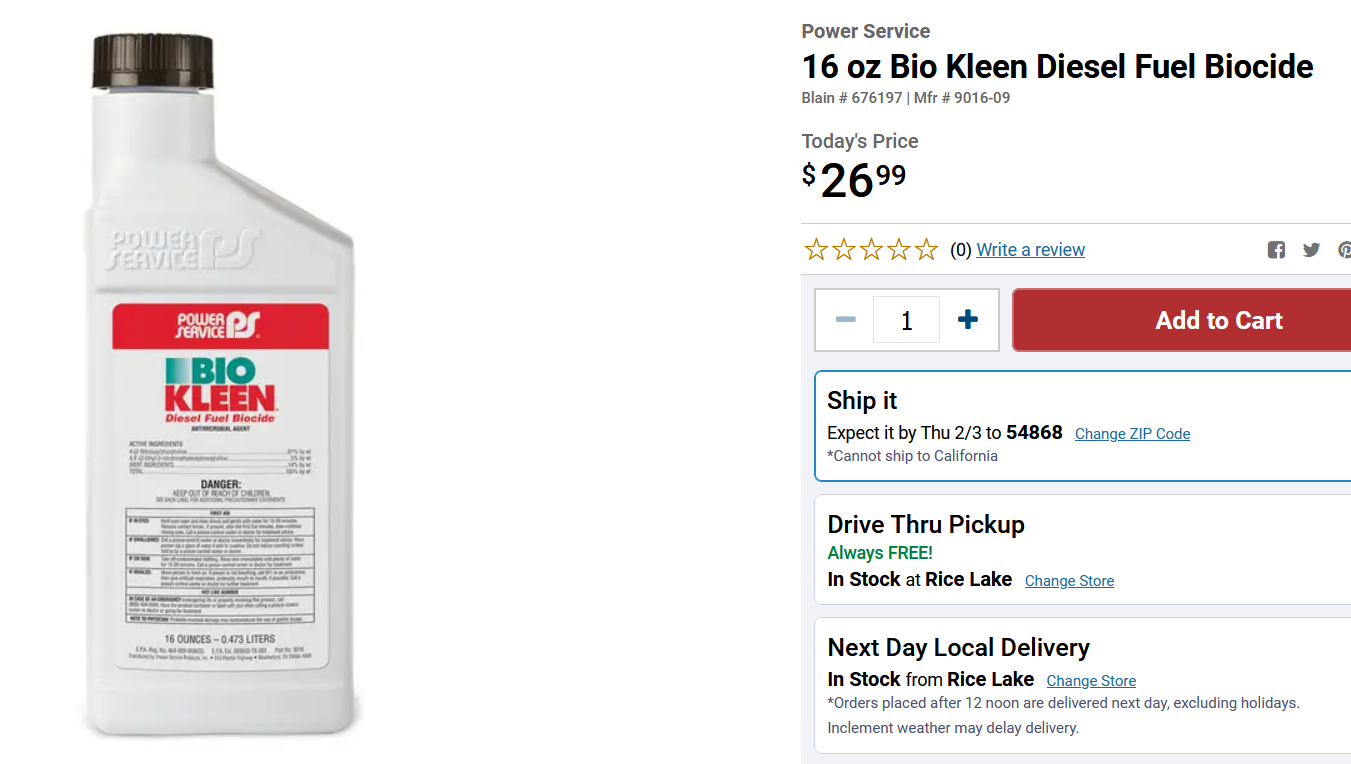

This
Features​
  • Dual-Phase – effective in both diesel fuel and water
  • Effective as a “quick-kill” biocide and for long-term diesel fuel maintenance
  • Kills microbes (bacteria and fungus) that grow in dispersed and free water associated with diesel fuels
  • Prevents fuel-filter plugging – helps prevent fuel system failures
  • Protects fuel system components against organic acids created by microbial growth – prevents fuel tank corrosion
  • Improves fuel performance
  • Reduces engine maintenance costs
  • Effective in all diesel fuels, including Ultra Low Sulfur Diesel (ULSD), biodiesel and biodiesel blends
and This
Features​
  • Cleans dirty injectors and prevents injector sticking in High Pressure Common Rail (HPCR) and older systems
  • Removes deposits on injectors and nozzle tips and prevents future deposits
  • Boosts cetane up to 6 numbers – engines run smoother with less power lag and faster cold starts
  • Boosts power – reduces need for downshifting
  • Improves fuel economy up to 8%
  • Contains Slickdiesel Lubricator to protect fuel pumps and injectors from increased wear caused by Ultra Low Sulfur Diesel (ULSD) fuel
  • Effective in all diesel fuels, including ULSD, biodiesel and biodiesel blends
