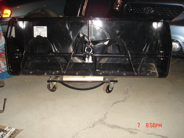

Toyboy- I'm a little confused about just where you were having a problem-- got any pics?
If you're referring to the foot-long stub driveshaft on the blower, I leave mine on all the time so I only have to line up the square male & female ends as I'm sliding the blower onto the shoe. There's even a little metal flip-up stand on mine to hold the stub shaft up.
There used to be some differences in the Kubota set-up, though; perhaps they're not quite the same.
I keep my blower on a flat dolly, with a piece of 2x4 to set it at the right angle. It seems to go on very easily. :confused:
(I was going to post a couple snapshots of my set-up, but the "upload" command doesn't seem to be doing anything this morning...)

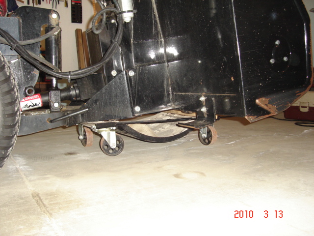

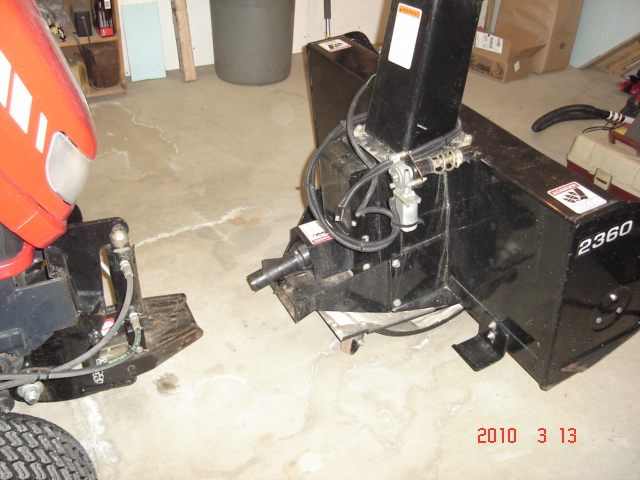

Toyboy, here's a couple pics; guess one of ones I tried before was way too big to load. Kind of hard to see, but the stub shaft is the one that goes under the guard. That's the one I leave connected all the time.

I call it the stub shaft, don't know what it's official name is.... Now, I understand where you had your troubles. I remove the blower and the quick-hitch assembly separately, in fact sometimes just leave the quick hitch on for a quick FEL job...as long as I watch out for rocks!:laughing:
Yep, that's what I use, too: spray chain lube, Honda brand. Works well, stays put.
Here's another couple of pics of the wood under the blower, which sets a good angle for sliding it on & off.
Hope your install & removal go more smoothly next time!
  • dolly:wood.JPG
