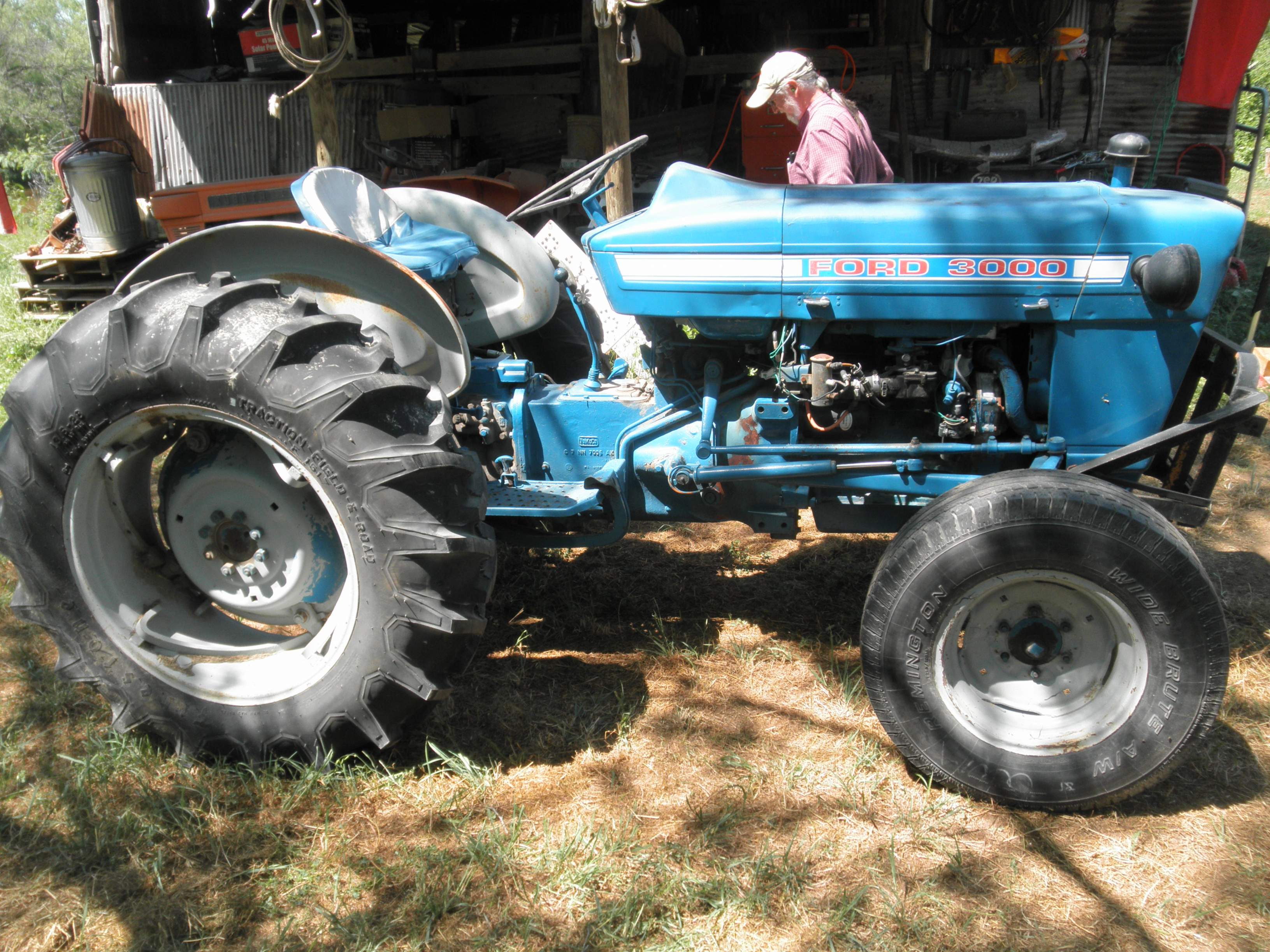

We picked up a Ford 3000 Tuesday and really like it so far. It's gas with a transmission PTO.

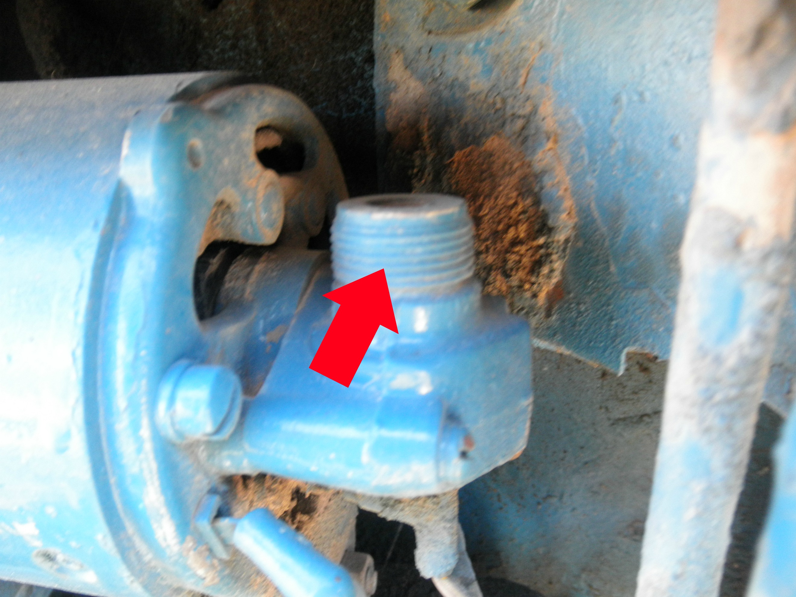

1. What was connected to the back of the generator?

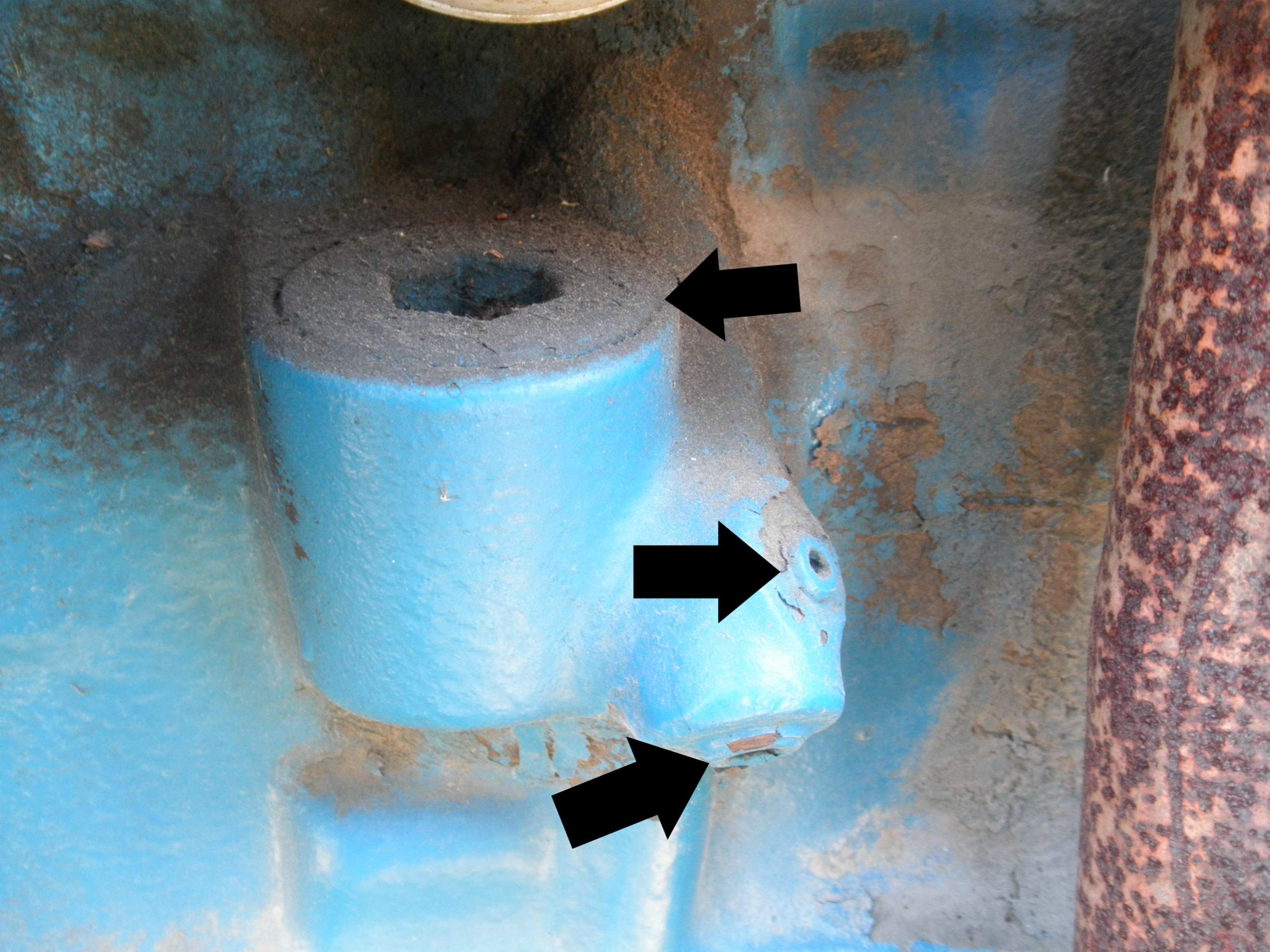

2. What was connected to the three plugs(?) on the back left side of the engine?

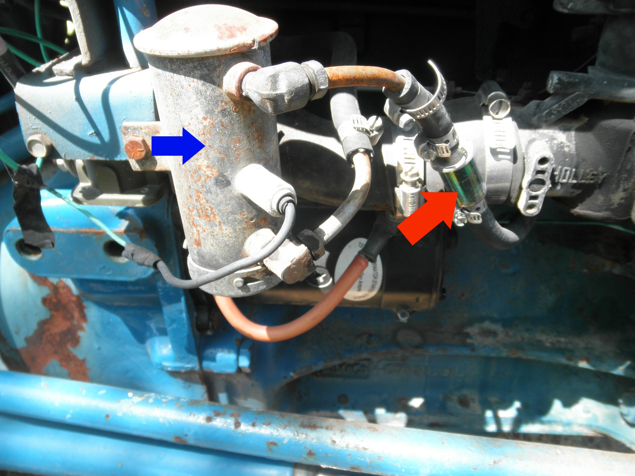

3. There is an electric fuel pump mounted. Was that original? The Holly carb leaks. Is that because there's no pressure relief valve on the pump?

i see twin sticks.. so it must be a 6spd or 8spd tranny. most 3000's were 8spd.. 6spd usually fell to the 2000's
Have you decoded the model id to verify it is a trans pto. sheet metal looks post 68

originally had a fuel pump on the front of the engine. leak at the holley carb? Take the tractor sn and date and holley info in and get the correct kit.. and I think i'd fix the oem fuel pump.
don't worry about the last pic.. them plugs are suposed to be there.
conenctor on the back of the genny was the tach drive cable nipple.

Is the original a mechanical fuel pump?
The Holly leaks. I figured over time the fuel pump had forced fuel into the carb after each shut down to the point of causing a leak. I don't know if that's even possible.

mechanical pump

I forgot. We ran it dry and put 10 gallons in it. We couldn't get it started for a while then I realized the fuel pump was not running. I tapped it with a screwdriver and it started right up.
Soundguy. Like you said, fix the mechanical pump.
   / New to us Ford 3000 questions? #9
it's a PITA where it is.. but it DOES work... :) same witht he carb. when it works.. it works good.. very efficient on fuel..
