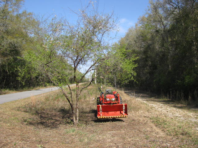

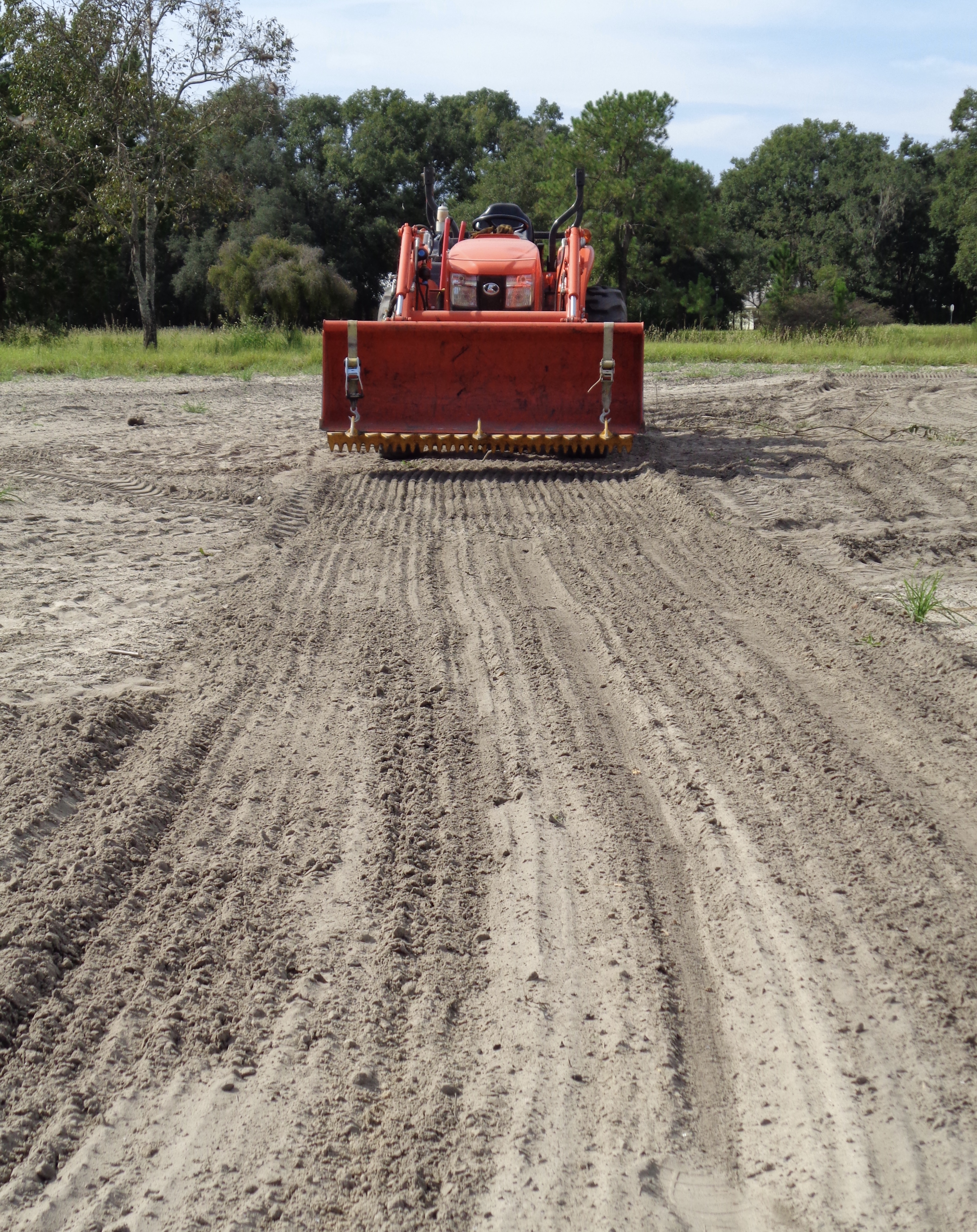

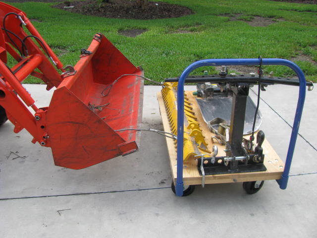

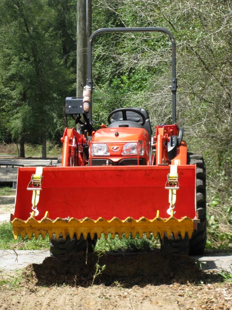

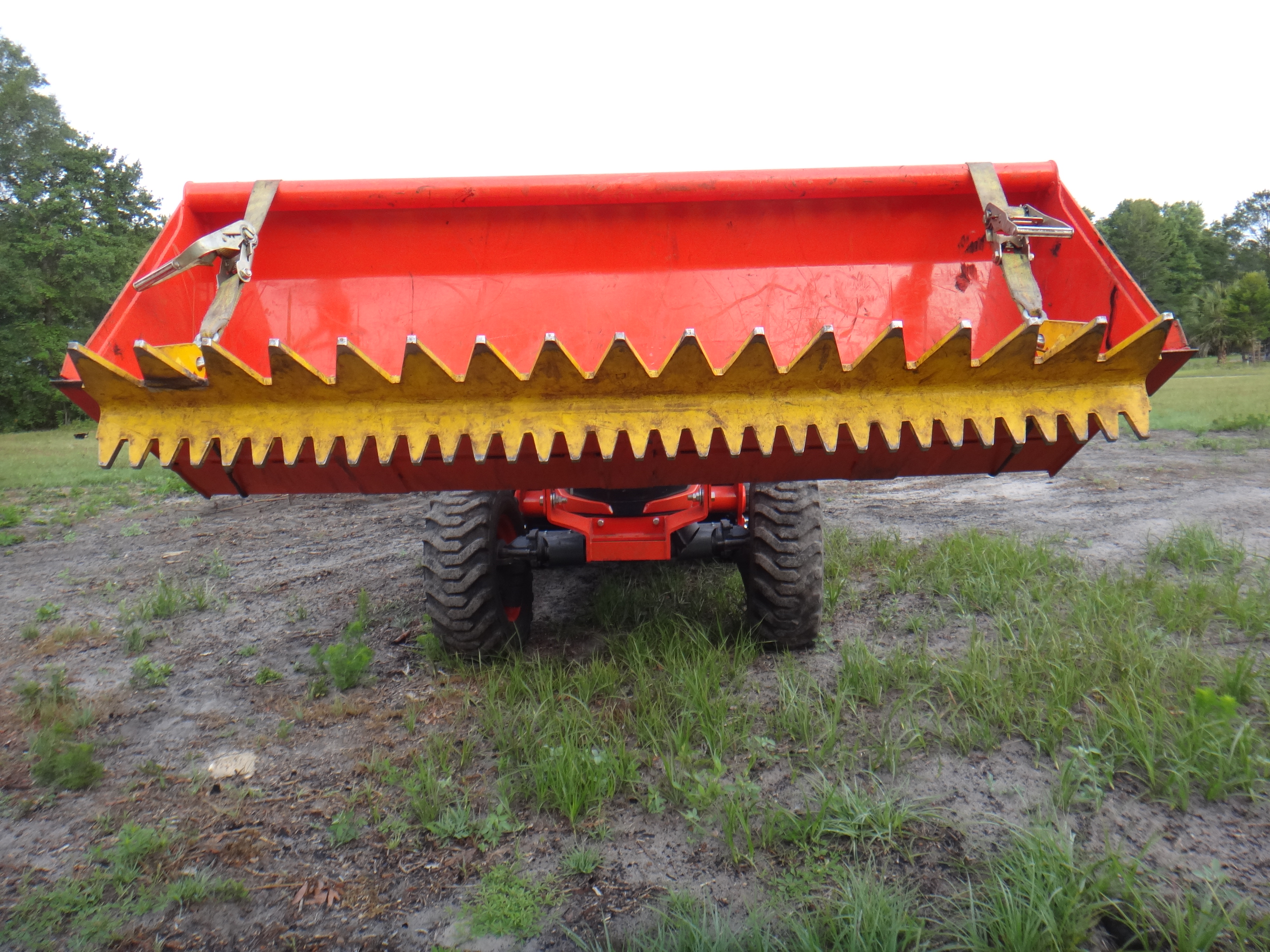

Whatever decision you reach, budget for a Ratchet Rake bucket attachment.
VIDEO: ratchet rake grading - YouTube
