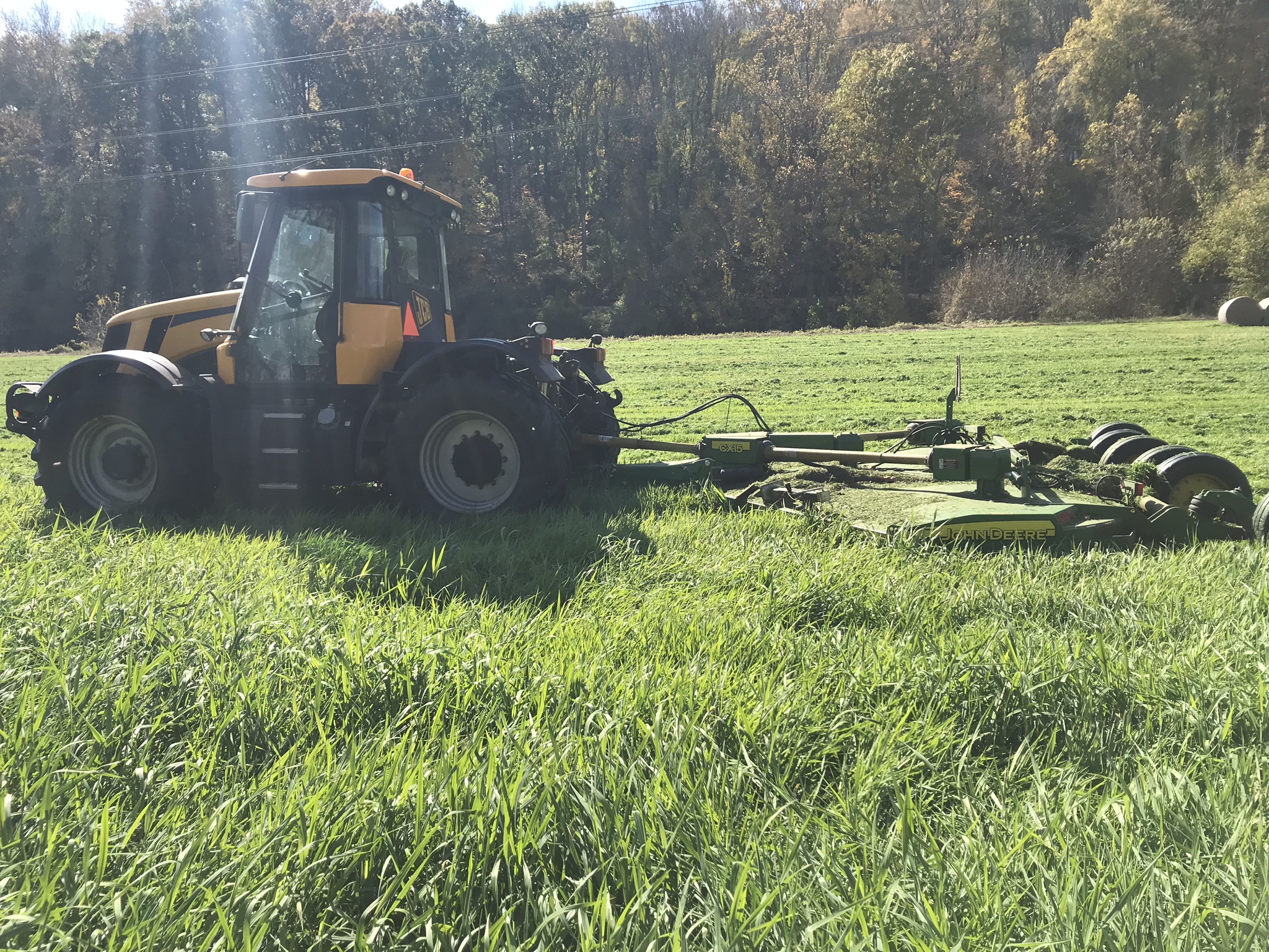

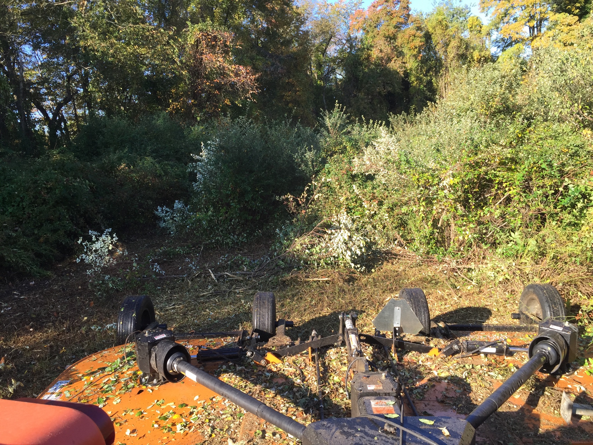

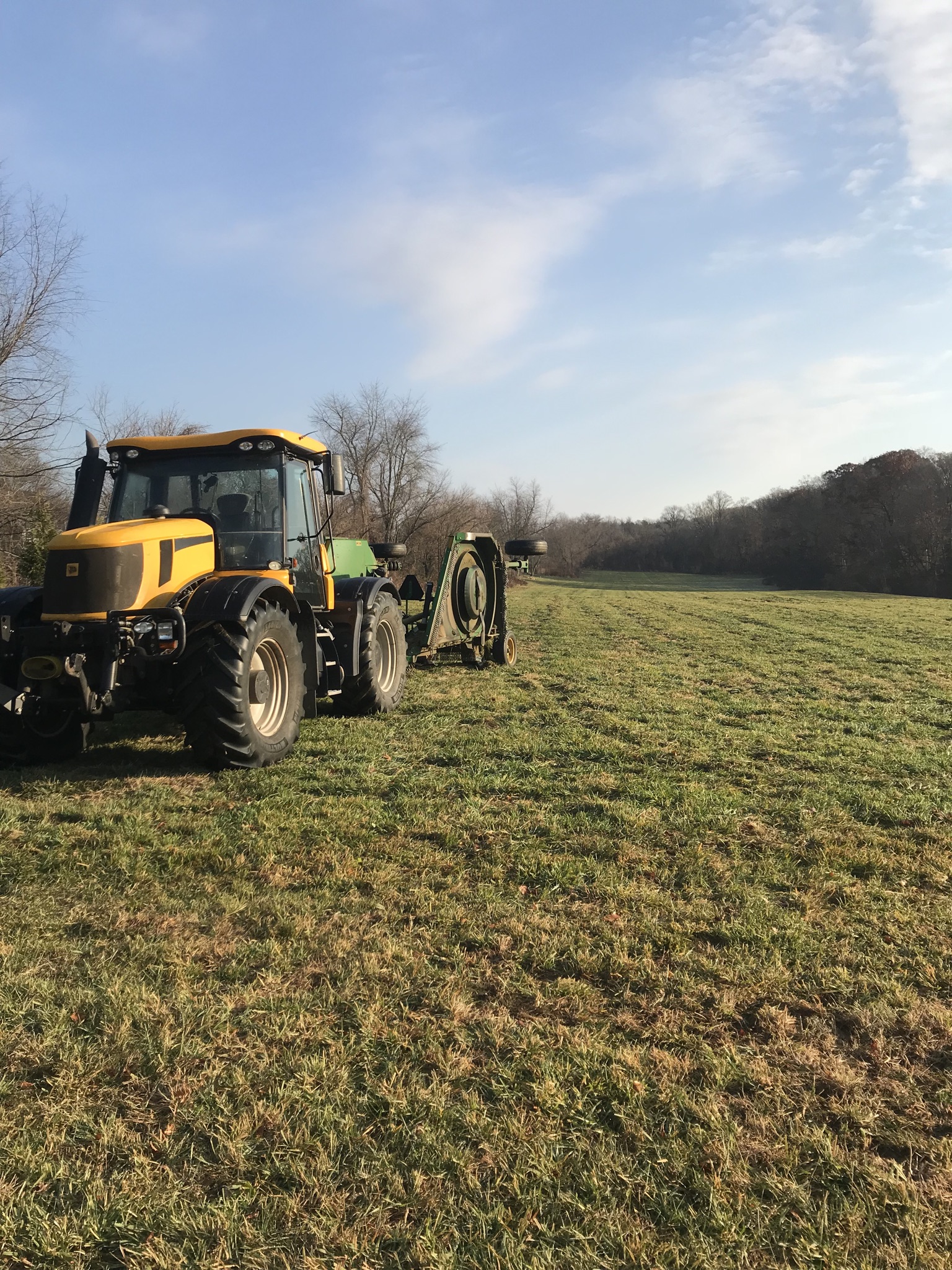

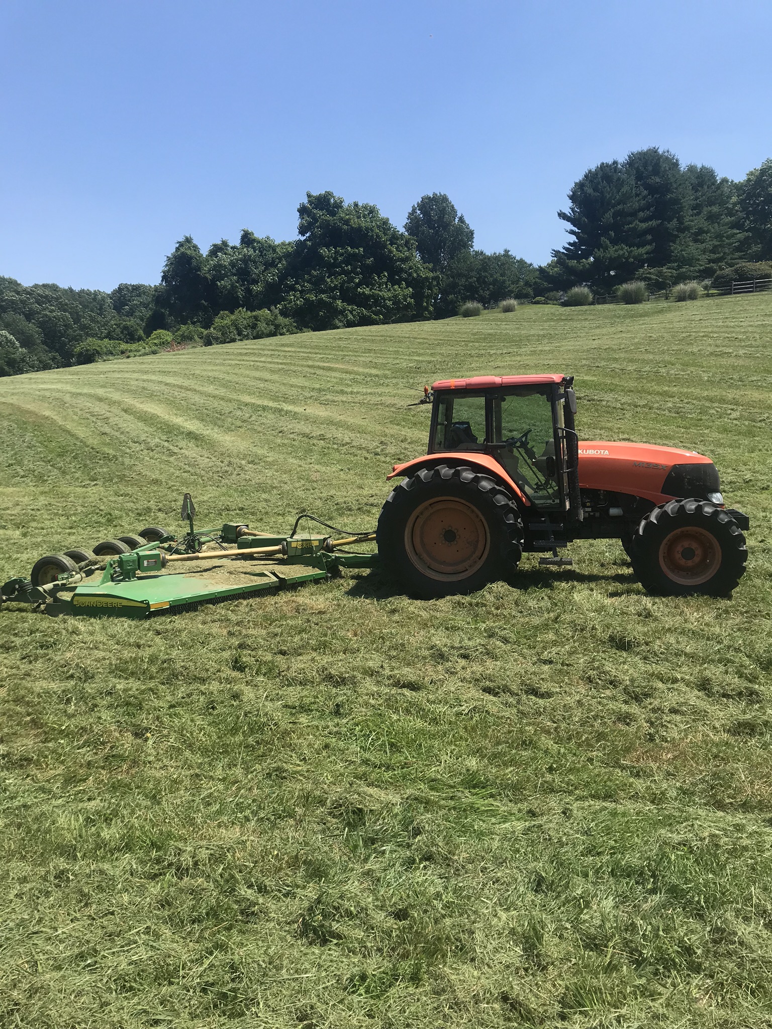

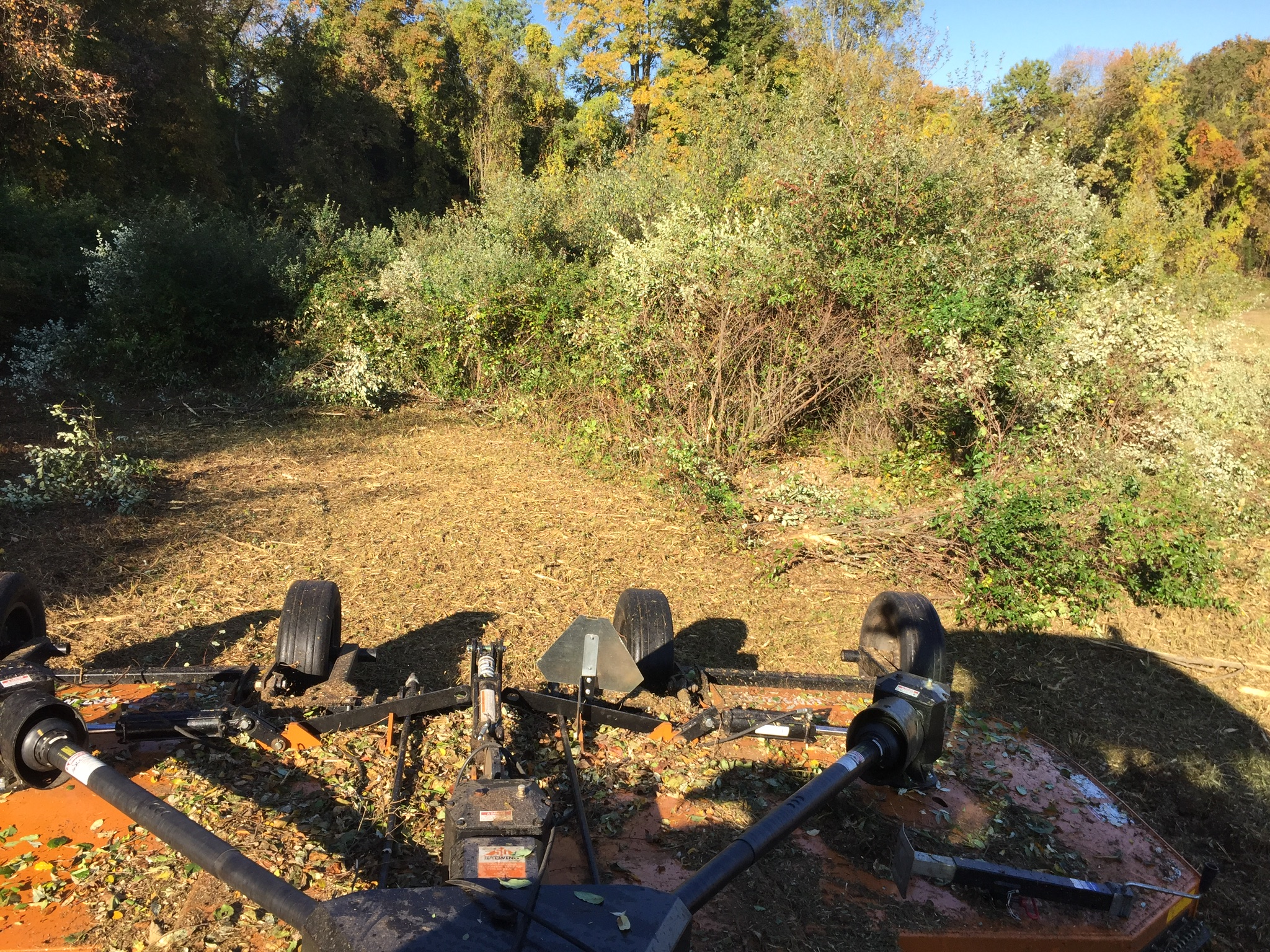

Below, I included some field mowing pictures. We mow and cut hay on fields in several states. The first photo (kind of blurry) is a 30 acre field cut 4 times a year. It looks like a tall lawn.
The 3 where you see me looking out the back window at the Woods 15? batwing are me cutting down years of overgrowth, restoring back to a hay field.
The JCB tractor is a customer that gets 1 cut per year, except for the one with the JCB and the round bales in the background. That is cut 3x/yr. Note how much softer and grass-like it is with more cuts?

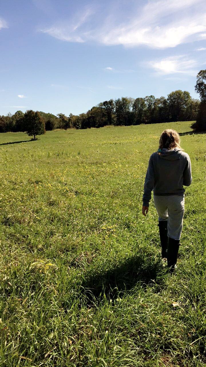

The last picture with the lady walking is what would be a typical late summer/early fall walk through a meadow that was cut earlier in the year and is untreated. Notice the invasives already coming in? You can see evidence of thistle, hemp dogbane, and horse nettle making their way into the field.
Only way to keep it out is intensive mowing.
