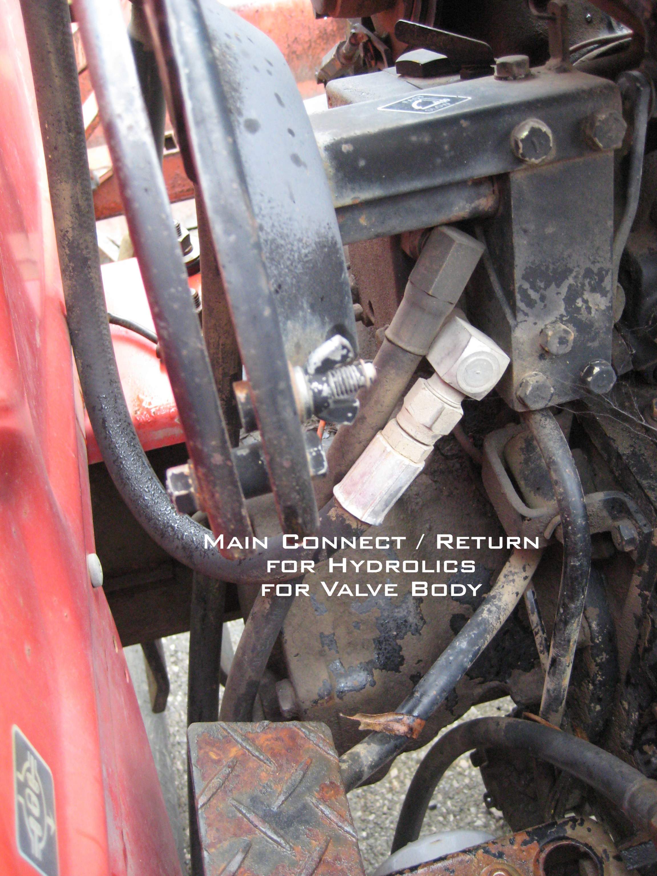

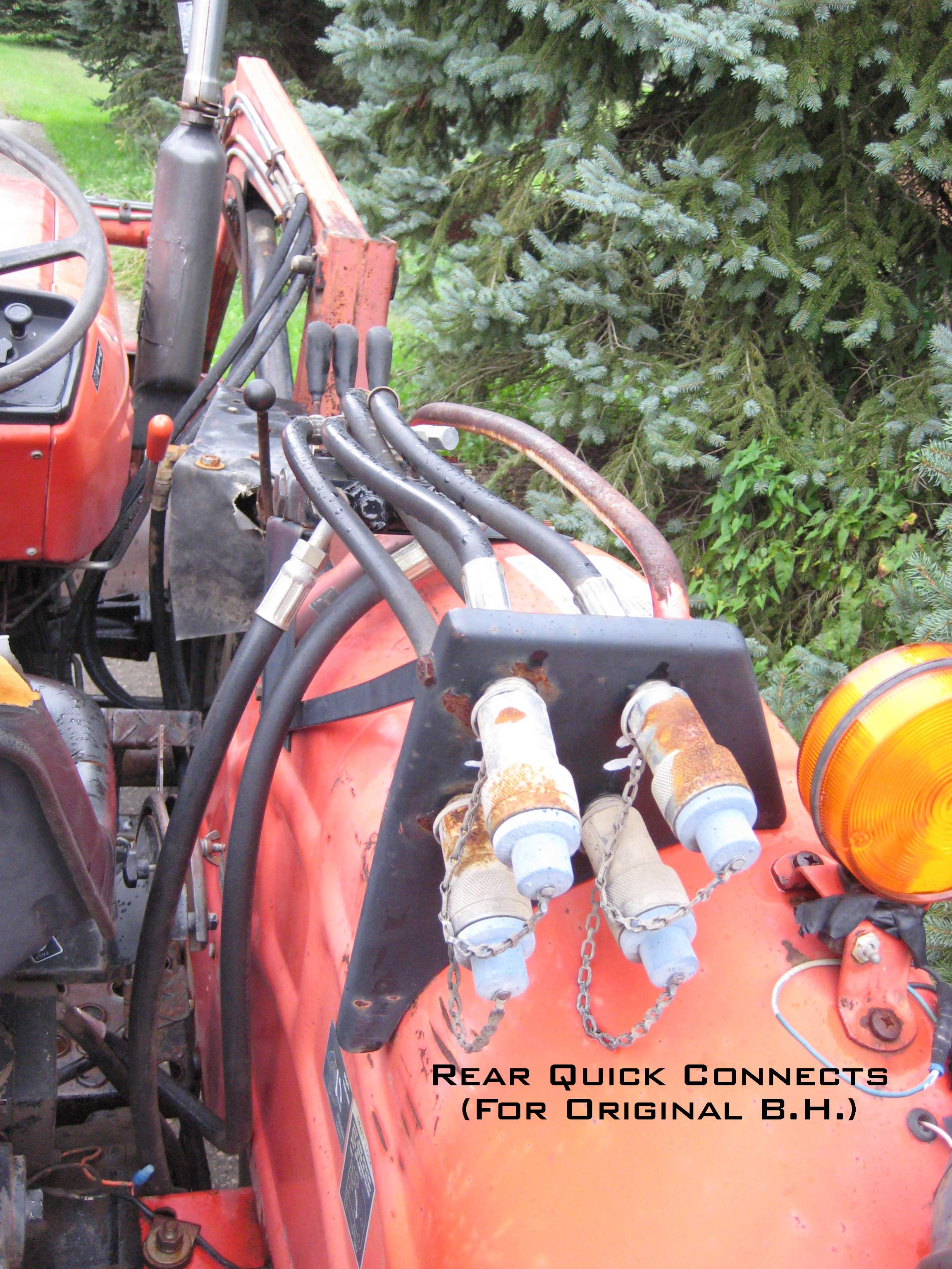

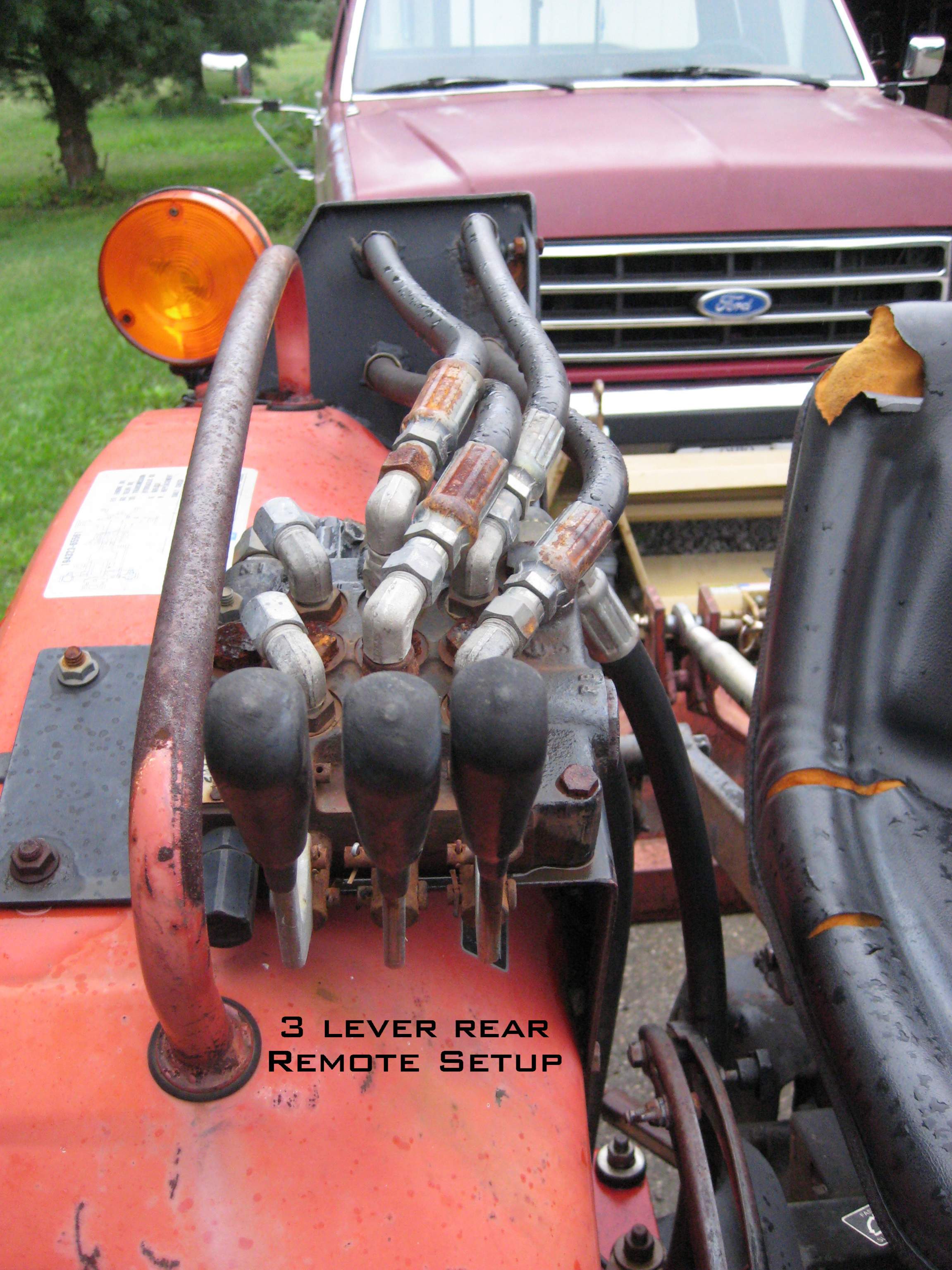

Here are pics of the rear Hyd setup. Seems simple. Ask any questions needed. Thanks for all your input CD! - Don
Photos below
Thanks DT and you are welcome any time!
Pic 1 shows me just what I was wondering about I have a hose running from one port to the other and my knob is inop for the 3pt lock and I was wondering if my block was modified for auxiliary hydraulics looks like it is cool I am happy about that. :thumbsup:
