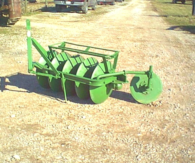

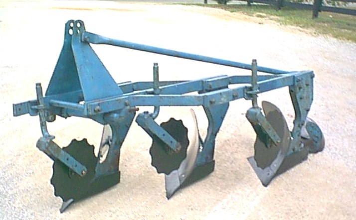

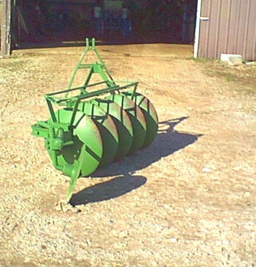

Something like a 3-14 bottom Ford 101 trip beam plow would work or maybe to cover the trash better a 5 disc plow that takes 30 inches at a pass. Ken Sweet
/ New to plowing. #4
Here are the pictures for the above post. Ken Sweet
