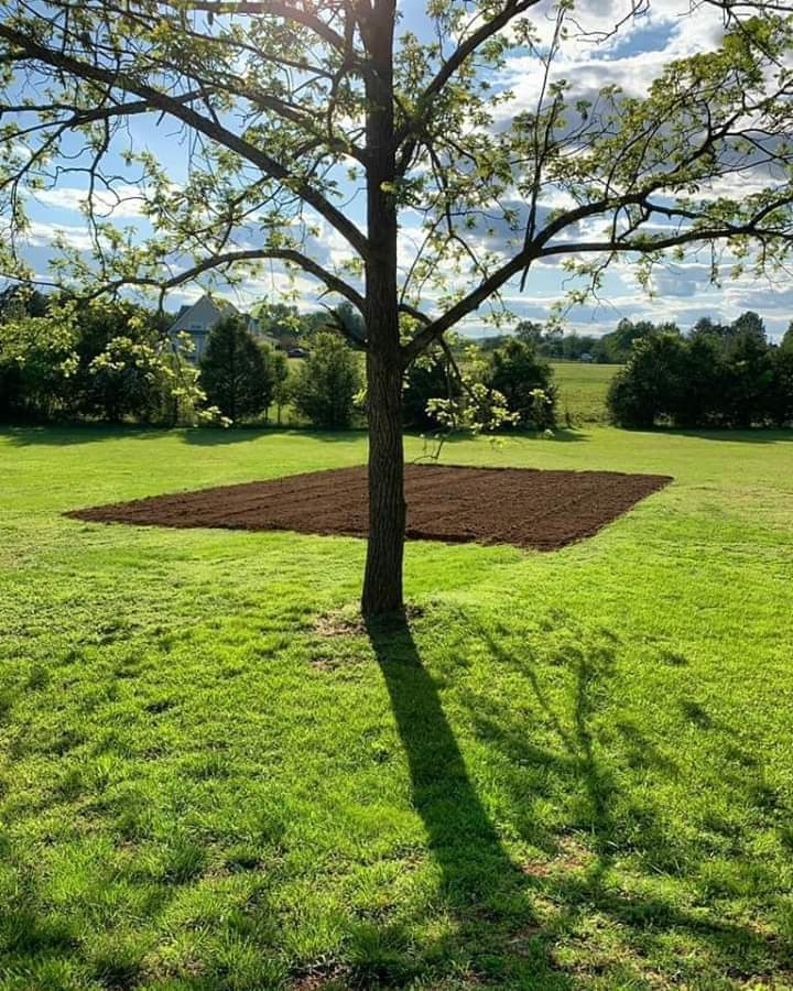

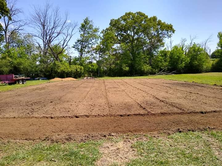

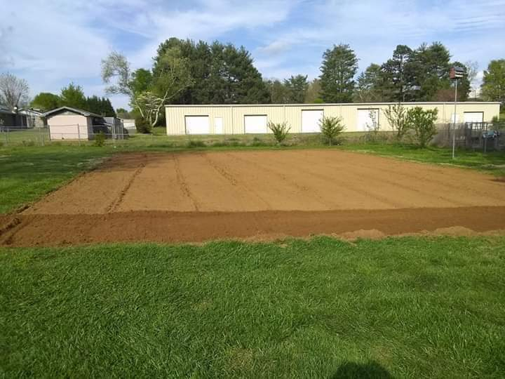

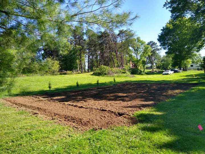

I have the same tractor. I bought the Tarter built 5' from TSC. It's been great. 6 tines instead of 4 and it's reversable. I haven't tried it reversed yet.
My only question is the quality of the slip clutch. I'm not impressed but I've tilled acres with it. Make sure you slip it.
I absolutely do NOT recommend a 4' tiller on this tractor. You want as wide as the tires. It WILL run this tiller.
I'm in East Tennessee. Our ground is not soft.
