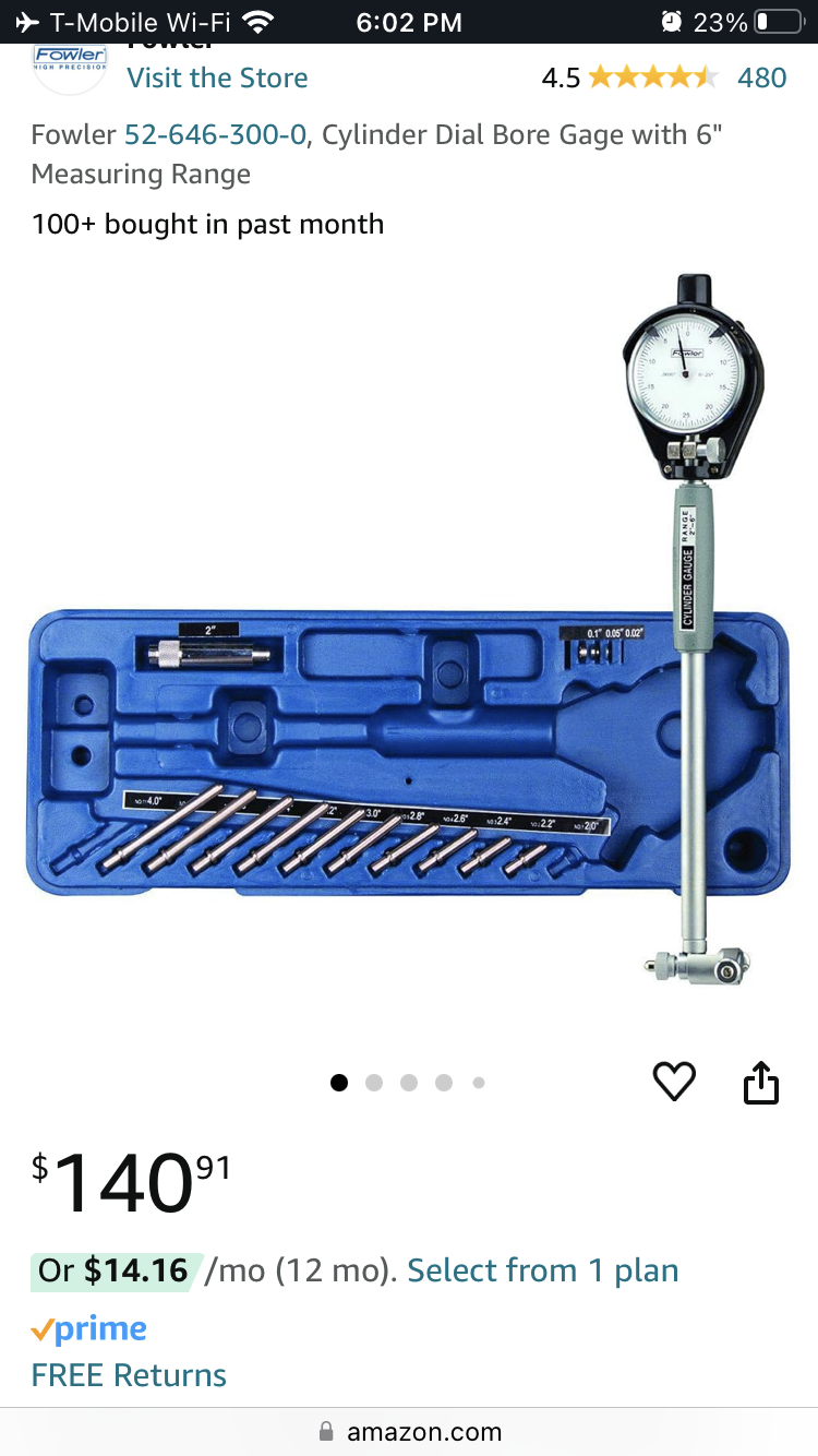

Not just the skirt wear, the big thing on Diesel pistons is ring land clearance. You may need a ridge reamer and definitely a bore gauge.

Thank you everyone for the encouragement!!! I still think I’m gonna get it too just gotta wait for time and funds plus it’s just too hot for long mechanic work..
As far as measuring, this is going to do the trick correct? If so I am Hoping to score a deal on it from the jungle store on prime days but they raised the price yesterday up from $113 lol they think we don’t notice things like that…
