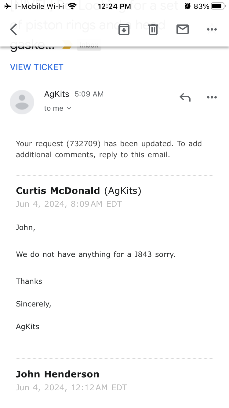

One response from agkits.com they don’t carry anything
Waiting on a response from reliance and another company but it seems only places that carry these are over seas…
Any parts website recommendations? Local Dealer or no?
I think I’m leaning towards buying new rings and gaskets once I tear it apart to see nothing is significantly worn.
Do an in frame as some of you’ve said. Then it should at least run well enough to test everything else and maybe well enough to just work for us a few times a month as is.
Engine is a J843 if anyone can find something they would recommend specifically

Searching for rings and gaskets
Thank you again everyone
