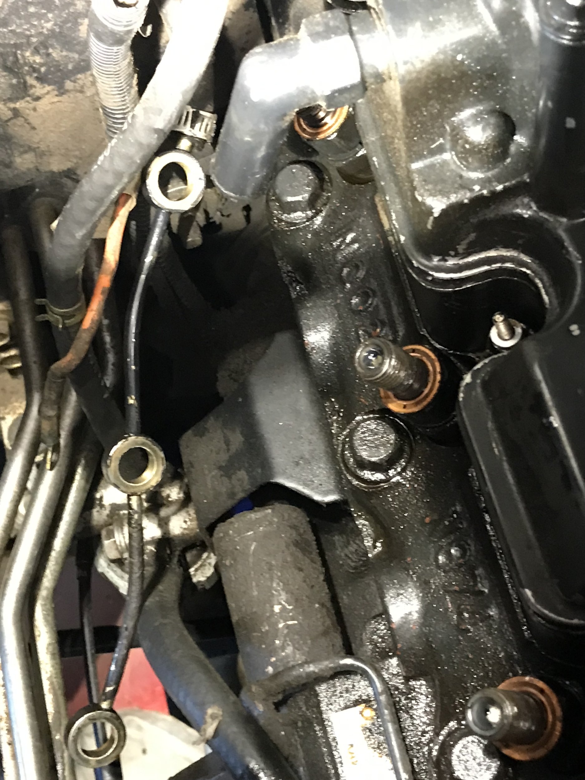

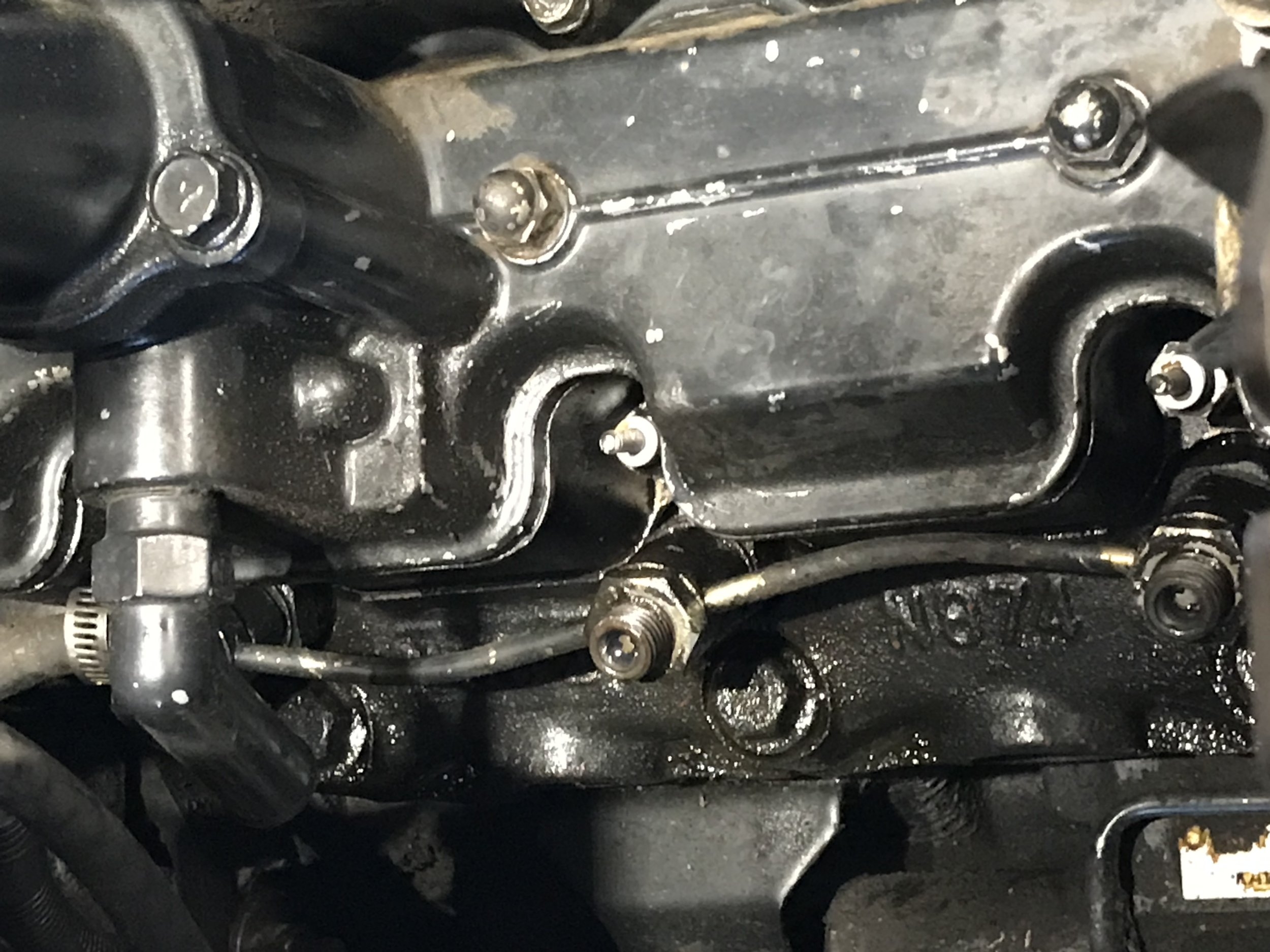

Too much blow by and very little resistance to cranking per compression stroke. Likely they started it with either until it wouldn’t start anymore. Time for disassembly.
   / New to me TC29D cranks & won’t start
#112

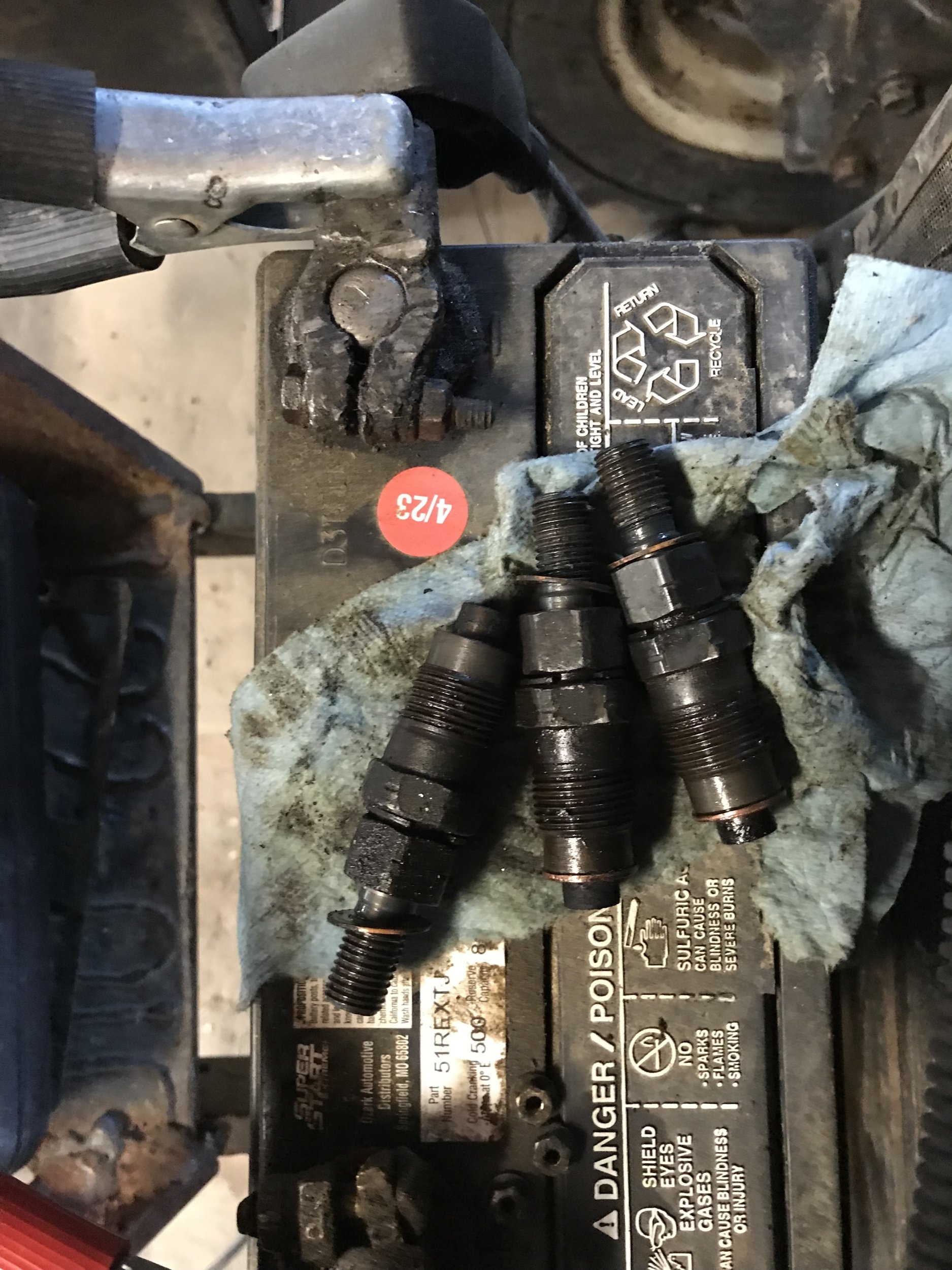

Injector and pump “pop” test in progress tonight

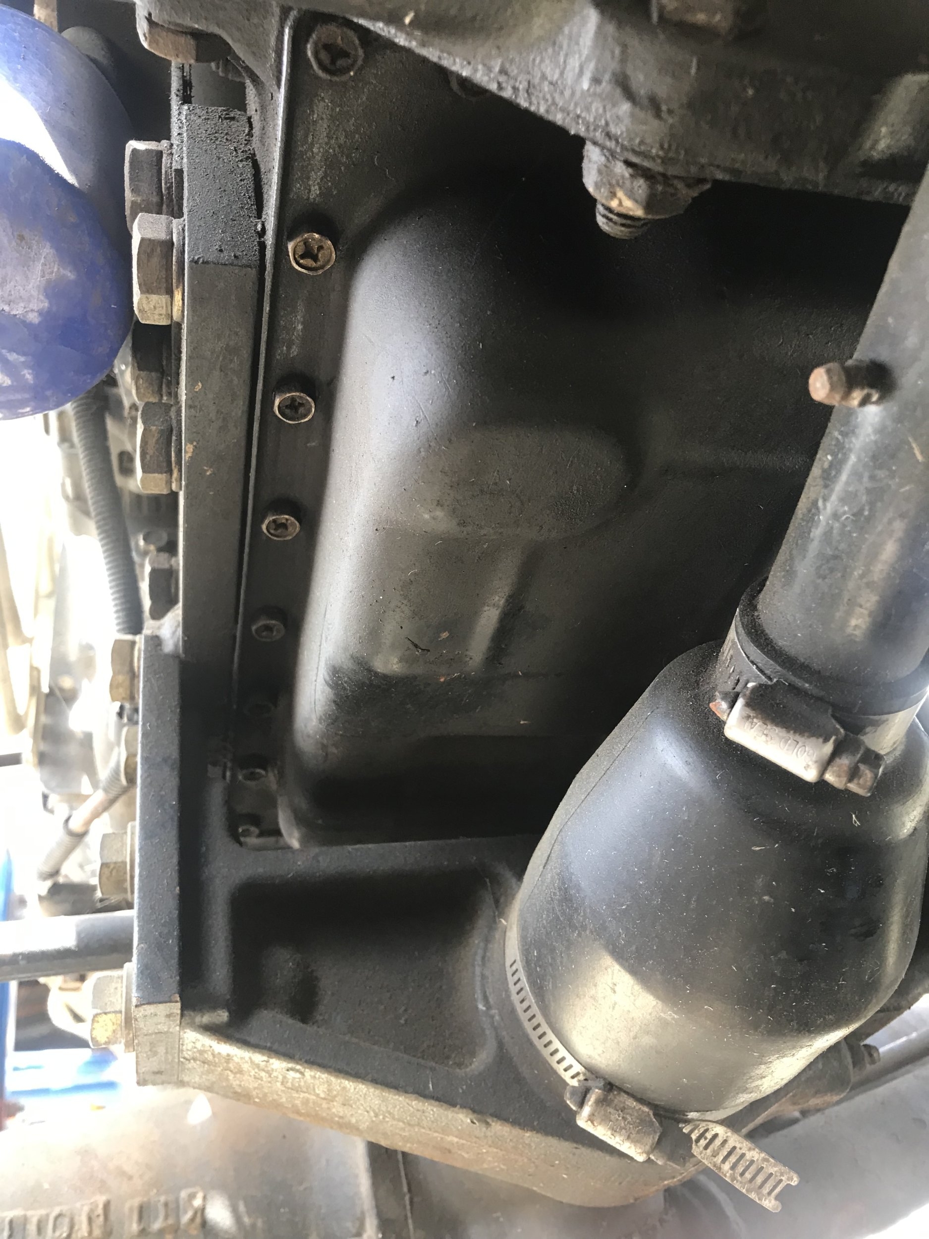

Also anyone know for sure I can drop oil pan ? Looks to be a crossmember and possible front driveshaft in the way.. last picture attached …

Pop test vid looks like 1 good 1 fair and 1 bad injector but pump looks to be working to my eye. What do the pros think?
What is next on the to do list everyone?? Besides spray some air freshener and get beard balm on, all I smell is diesel #2 lol
   / New to me TC29D cranks & won’t start #115
Swap the one that’s NOT PUMPING to a different line..
THATS to rule out a bad cyl in the pump..
(y) Are these type injectors rebuildable or cheaper just to get new?
