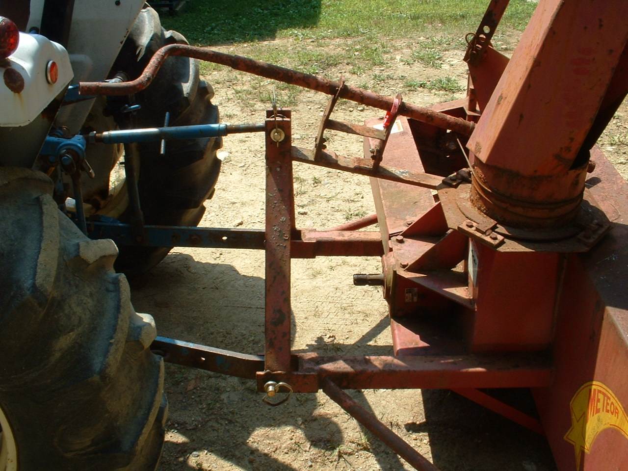

Hey all, just picked up our new to us Meteor snowblower. The P.O. used it once, set it out in a field and forgot about it. Other than the paint and the chute rotator it is in excellent shape. The PTO shaft was damaged by the P.O. so the dealer I bought it from (Frost Farm in Greenville N.H.) has ordered a brand new shaft for me. I Paid $750 for the whole thing with the new shaft included, I figure a couple of hundred bucks for sandblasting and paint and we'll have a nice blower that will last as long as I'm going to need it....take care, Rick

Your Meteor and my Lucknow are similar except mine is a bit wider.
After sandblasting but prior to painting, I'd do 2 things. One, I'd install a hydraulic chute rotator and two, I'd remove the outboard sheet metal skid shoes and weld on angle brackets to the lower inboard gussets (under where the 3 point hitch arms are welded to the blower body) drilled to accept round Meyers type snow plow skid shoes.
You need to get the bottom edge of the blower about 1/4" off the ground or the blower will become a machine gun, picking up and throwing any small object like gravel.

Thanks for the kind words everyone, after closer inspection and lubrication I have come to the conclusion that this thing can't have ten hours on it. Took the auger drive chain off and soaked it, greased the bearings and changed the gearbox oil and runs smooth as silk....with the new PTO shaft we should be all set. I havent taken care of the chute yet and I'd like to to make it power when I do, but regardless of how it turns, I'll have it working as smooth as the rest of it.
Instead of installing skid shoes I plan to mount two heavy, large diameter pneumatic tire casters where the reinforcing braces meet the back of the blower housing, holding the cutting edge about 1" off the ground. Its a lttle bit more than our tractor really wants, but I figure real slow on the first pass and adjust from there........stay tuned and thanks again, Rick

The telling factor about use/age is ther chute. If the paint is worn off inside, it's been used...plenty.
I would remove the wheels/casters and put on skid shoes. The wheels/casters will just dig into the snow and slide becoming useless.
/ New to me Meteor snowblower #12
I don't know about the "plenty" part. I think the paint goes with the first bit of gravel going through the chute. Mine is gone and I've done 3 seasons with maybe 40 hours total use - I'd consider the blower in excellent shape. I'd look at the tips of the impeller, if worn and there's a significant gap from the housing then it's getting serious wear.

Hi all, little update on our old Meteor, got to use it in earnest last weekend and it performed very well in the heavy snow we got. No power issues with the 1900 and the chute repairs that I made work as well. I'll get some action shots as soon as we find a replacement for our recently expired digital camera, take care, Rick
